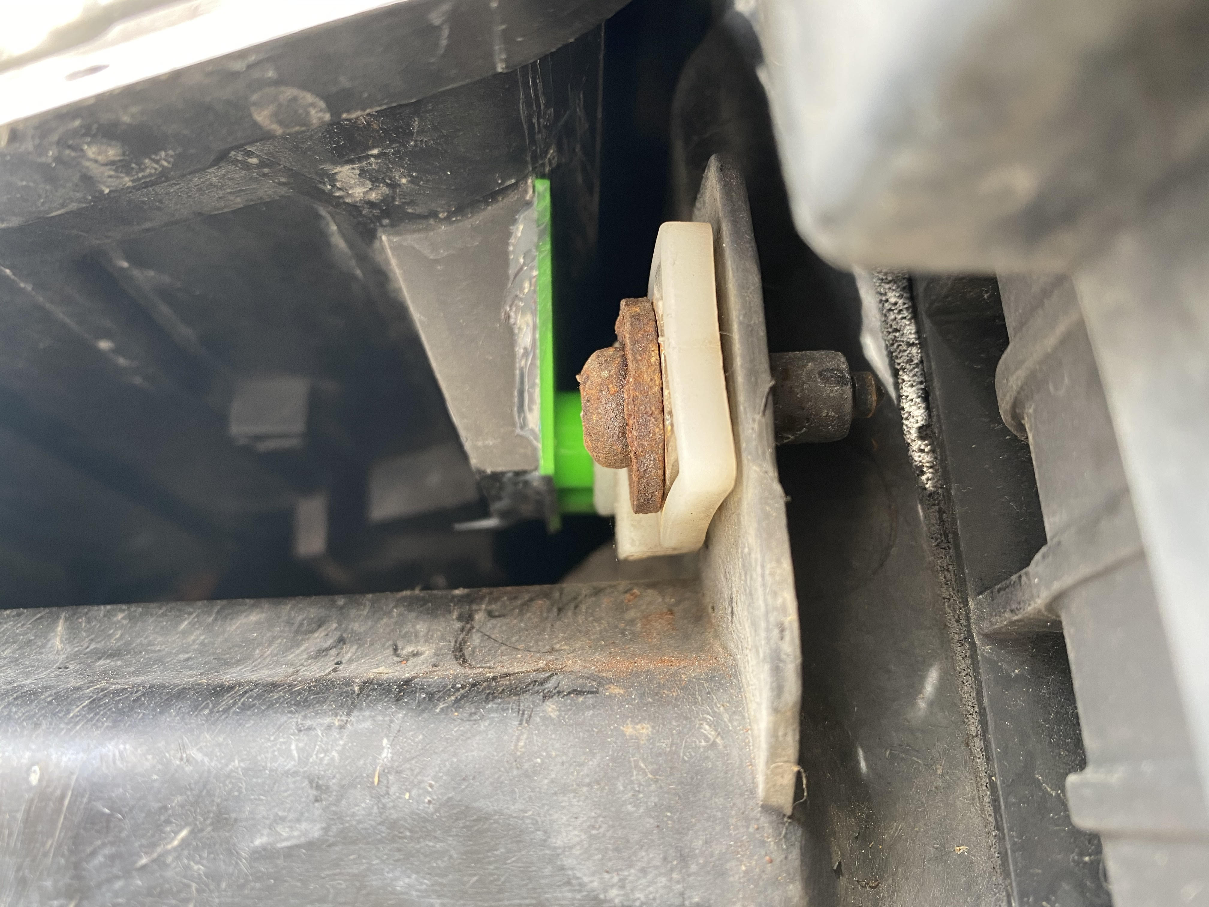

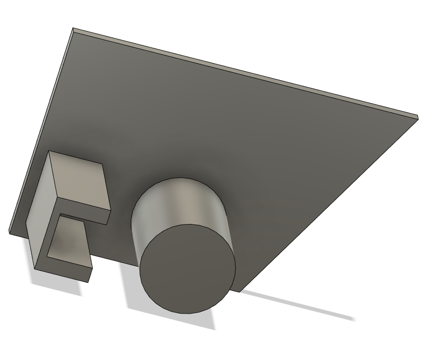

Post by simonpoulton » Thu May 14, 2020 6:46 pm
Also judging by my lights, quite a big risk off snapping off the lower mounting points doing it without the bumper coming off. I have just made some replacement mounts which seem to have done the trick:

Post by IchBautAuto » Fri May 15, 2020 12:50 am
I've had my headlights out before and the difficult bit for me was the lower bolt with accesses through that tiny hole in the top panel. Otherwise it's a 5 minute job. For some reason the allroad arrangement is different enough to make it a snap, much bigger hole for example, but not here. Dropping the bumper is OK, just so much longer than a headlight out for this specific task.
