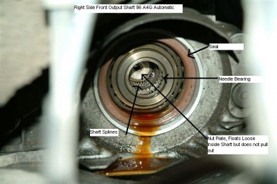

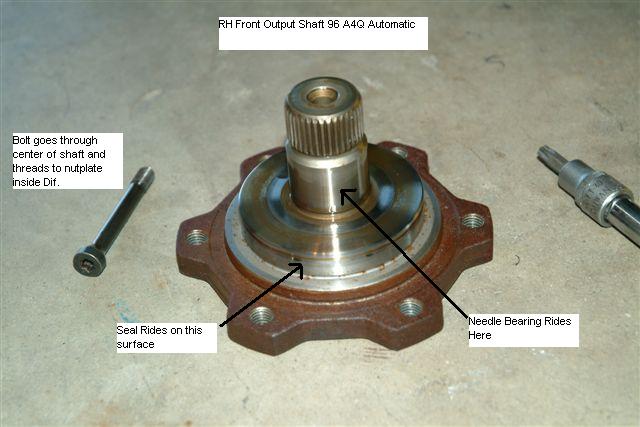

these are the parts were talking about, not from rs6, but similar stuff...
looking at it i dont think its the flangeshaft itself, has to be a bearing or shim...

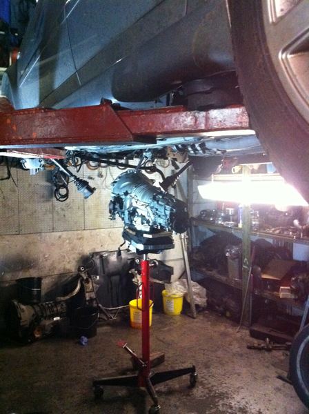

If its a bearing, its an engine/gearbox out job, as elsawin mentions.. we couldnt see a way to get the part of in which the flangeaxle is in. theres a piece of the exhaust running in front of it, also a piece of the frame/subframe (dont know how its called)
Ive never heard someone with the same trouble and without taking the engine out...

...but Elsawin says to remove the engine for O2's as well
From Elsawin:
- Remove front exhaust pipe (left-side) and front exhaust pipe (right-side) with flexible element → Engine, mechanics; Rep. Gr.26. – Remove gearbox support (right-side)
Removing and installing front exhaust pipe (right-side) – Remove engine → Chapter.

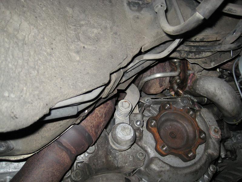

...Anyone got a clear pic taken from the right side where i can clearly see the diff case and turbo etc.?

...found one, but not clear if its (diff case...) removeable in situ...

ah, ive seen its possible...

Possible, but not easy. It's a pain to have to remove the turbo. Better pray the bolts aren't seized...
Re: Clunking noise ...
Looks a right byatch of a job.
..its a challenge...like this:

i think by just loosen the turbo will have prob enough space to get the diffcase out...Shoppinit wrote:Possible, but not easy. It's a pain to have to remove the turbo. Better pray the bolts aren't seized...

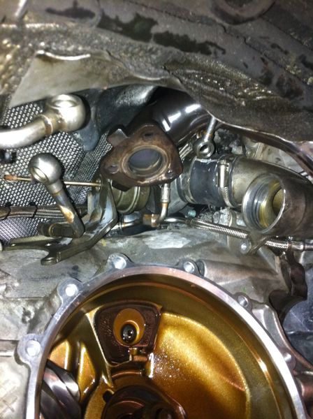

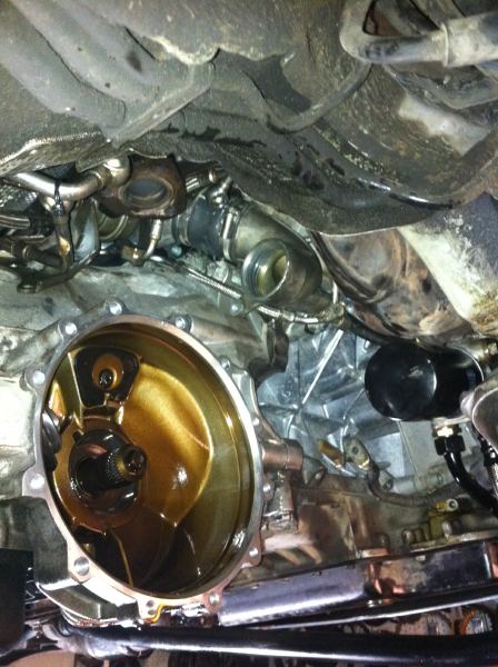

...i managed to get the flange axle out and noticed the needlebearing can move in-and out for about 1-2 mm. Dont know if thats normal.
The part that covers the needlebearings hasnt got play. So i think the diff itself neither.
Was surprised there was oil coming out after all those kms leaking.
But i dont understand why i can move the flange in- and oud for about 1,5-2mm, but when i just insert the bold without the flange theres no play at all.
Excellent job, Mav! What did you have to do to get enough room to remove the flange? (Told ya it could be done.. .
Not sure what your question is?
well, theres still play in it, trouble is to get the diffcase out to replace the bearing...
