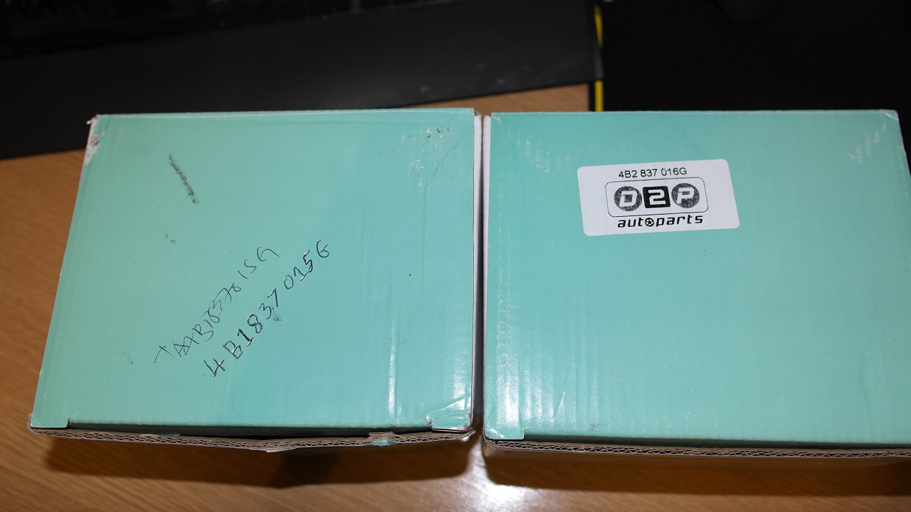

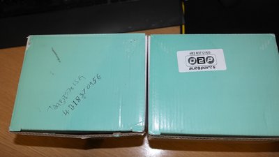

Below turned up from D2P Autoparts and they worked perfectly as mentioned. No "fascinating" pics of the mechanisms I am afraid, the old, dead ones are in the boxes...
I couldn't tell you regarding the rod Matt as I never pulled the door card myself, just threw some money at a mechanic to sort it while he was doing other hitting other things with his hammer.Current:
