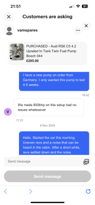

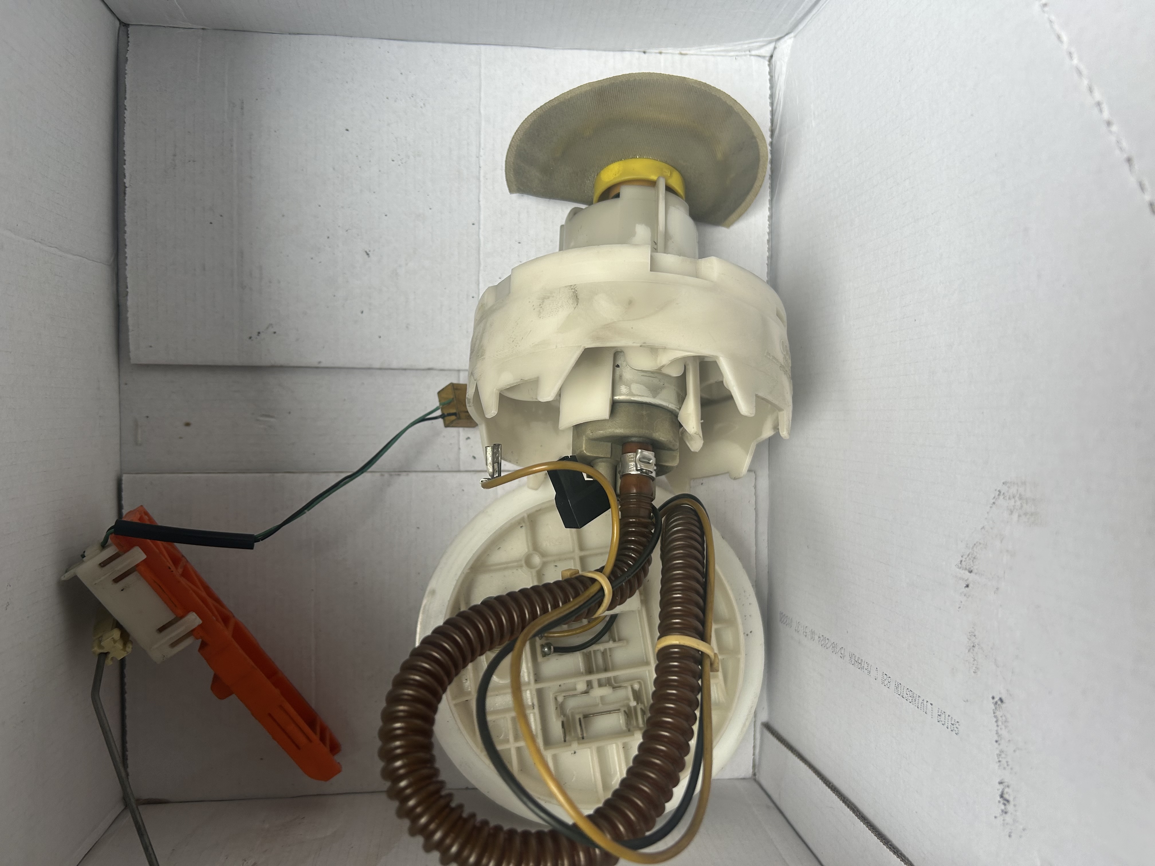

This is the second hand uprated in tank fuel pump. I only wanted the external pump but the seller wouldn’t split them. So I had to buy both.
As it turned out I am pleased I bought both. As I needed both of them.
Apparently they made 800 BHP with this setup. I was surprised that bare electrical connections are immersed in fuel.
I checked the original pump when we removed it. That was similar with bare connections.
Old original in tank fuel pump

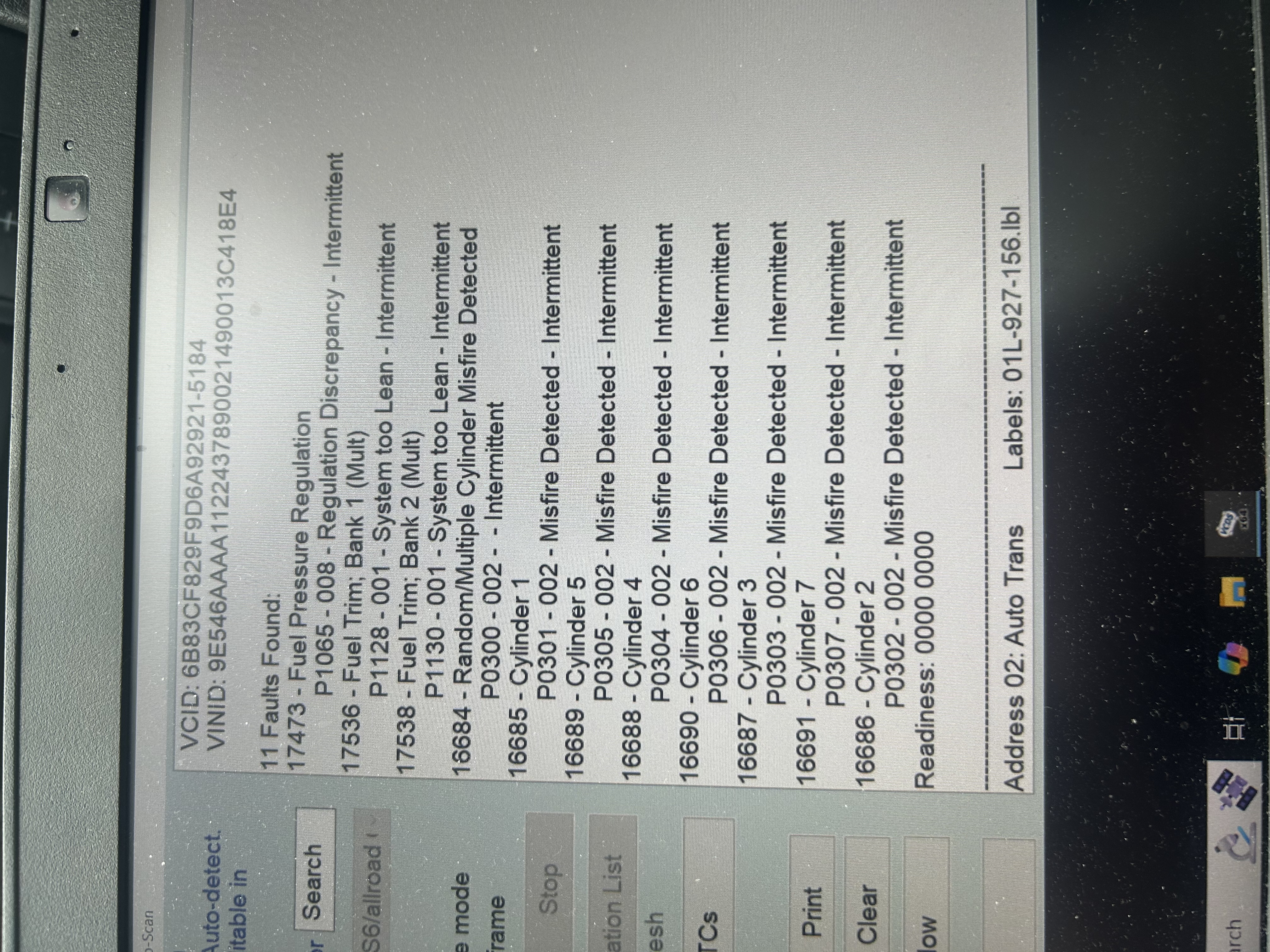

I guess all of these were expected.
Cleared all faults.
Posts: 20342
Re: Breakdown
Post by Shoppinit » Sun Nov 10, 2024 1:41 pm
Makes sense given the fuel starvation problems.
