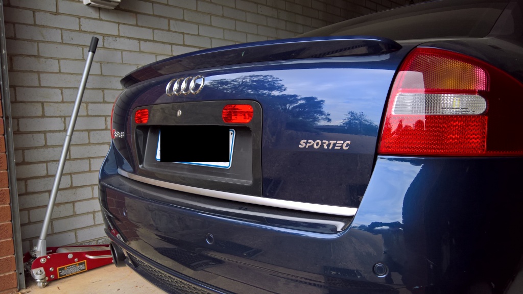

You need one of these and one of these to round it off. Great car.
Thanks manIchBautAuto wrote:You need one of these and one of these to round it off. Great car.
I really want that sportec badge, need to source it

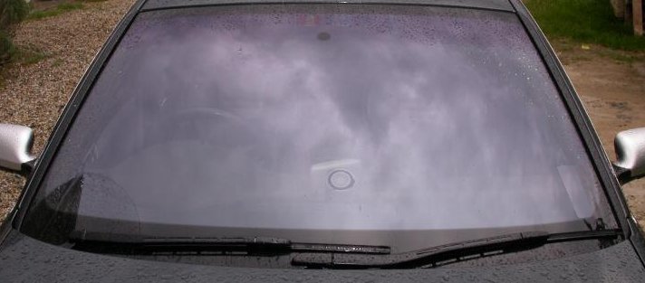

Ah OK. Another bit that I let go when I sold my allroad. Should have kept it for parts. Can't say that I noticed the detail, just that they both had the 'foil on the blade holder. What people are saying then is to change the arms rather than the blade part. Definitely looking in the wrong place.
Yeah, the retrofit blades look lumpy and clumsy. The allroad wiper arms are slick and look much more the part. I'll try to find a photo.

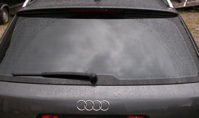

The rear wiper benefits from upgrading. Not allroad though. Possibly Sharan? Can't remember. Part numbers in the FAQ.
/edit: Touran rear wiper

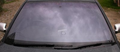

Before (OE wipers which look better than the retrofit blades):

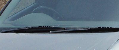

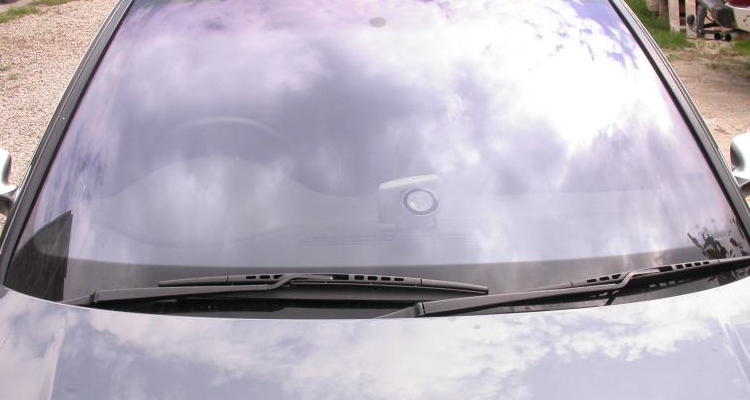

After:
Rear:

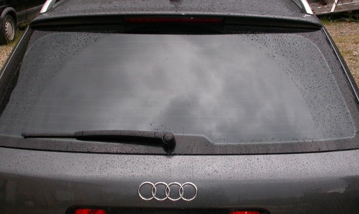

Rear:

Perfect. Worth a thousand words in this case. Thanks. Definitely got the dog leg wiper arms on mine. Just did a quick look back and my allroad also had the dog leg wiper arms!!!

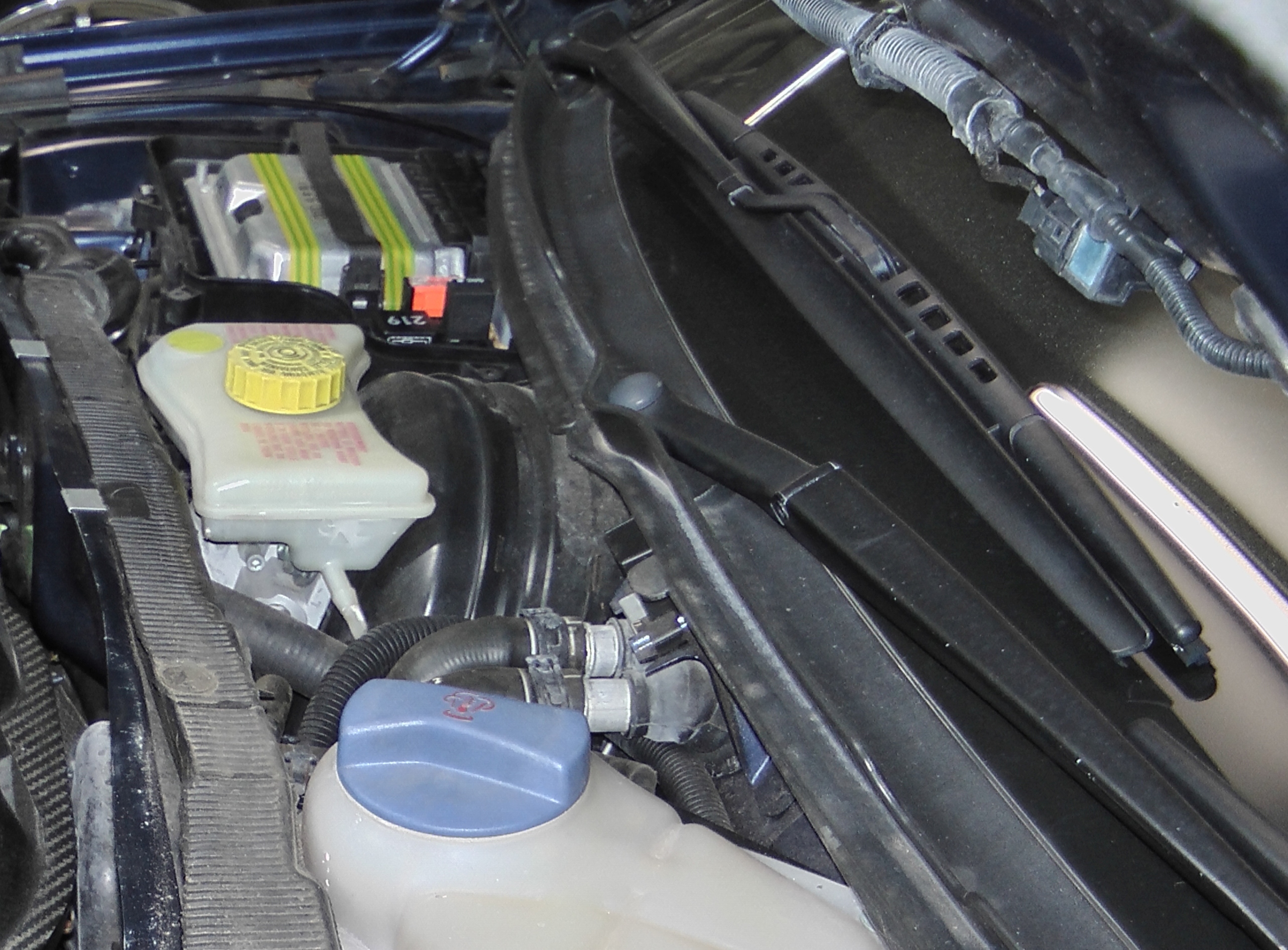

Allroad and my RS6 Maybe the straight wiper arms were either from the earlier A6 or the later ones, or just something different for different markets.
Yeah, there was a change to the more modern arms from chassis number 4B2 000 001. What was yours?

Display my ignorance and say I have no idea of the Chassis number. Never needed to look. The VIN was WAUZZZ 4B2 1 N 165032. A 2001 build car so one of the early versions here.
OK, that makes sense. The parts catalogue says 4B-1-102 000 and above for the old style wiper and 4B-2-000 001 and above for the new style.
The dashes must represent irrelevant parts of the VIN, so yours would be 4B-1-165032, so the old style.
VIN = chassis number.
I think the 2 of 4B-2 is model year 2002.
