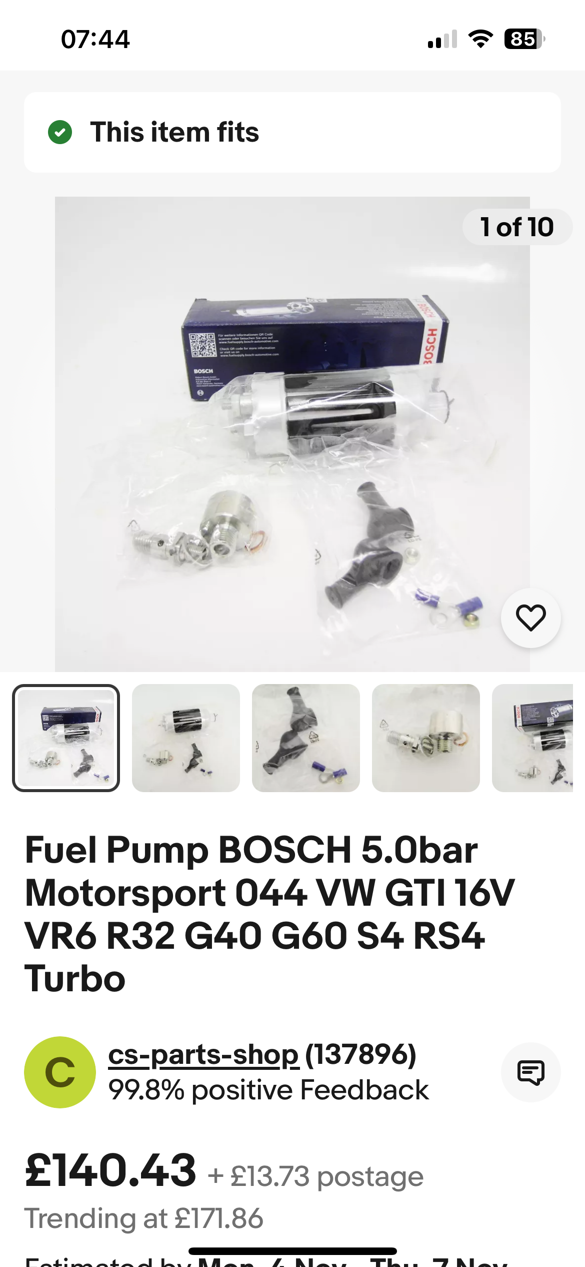

I came across this whilst spending time on google.
It says it is compatible with our cars.
5 bar pressure and reasonably priced.
I have not ordered one as I have bought original pump via Audi Tradition (£630.00 approx) 4-5 week delivery.

Re: Breakdown
Could be the same one as this then from Demon Tweeks:
https://www.demon-tweeks.com/uk/high-pr ... fseotp044/
Re: Breakdown
Looks like plumping would be a pain given the very different shape of the input / output.

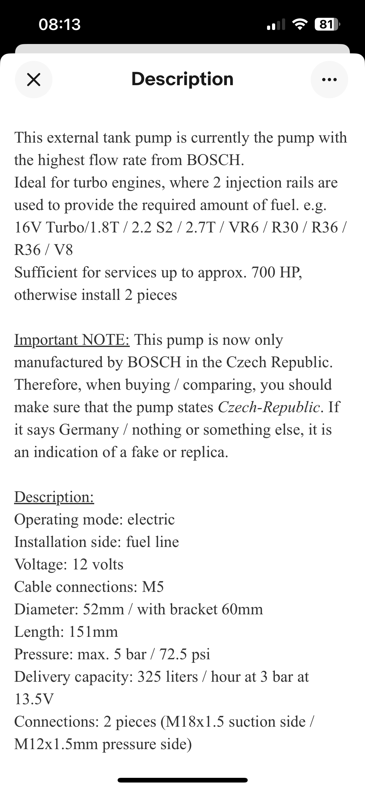

Forum member says this one is a replacement for the original but you might have to change the power terminals.
Re: Breakdown
But we established that 200lph isn’t enough at 4 bar, let alone 3 bar.

Re: Breakdown
That pump flows ~170 lph at 4 bar. That's at 13.5V. At 10V I would *guess* it would meet the minimum spec of 120lph.
You'd only need max flow under full load conditions. I suppose if you get misfires under WOT you'd know if it wasn't up to the job.
Might be worth a punt though. Why don't you get one and have it installed? Cheaper than a rental car.
