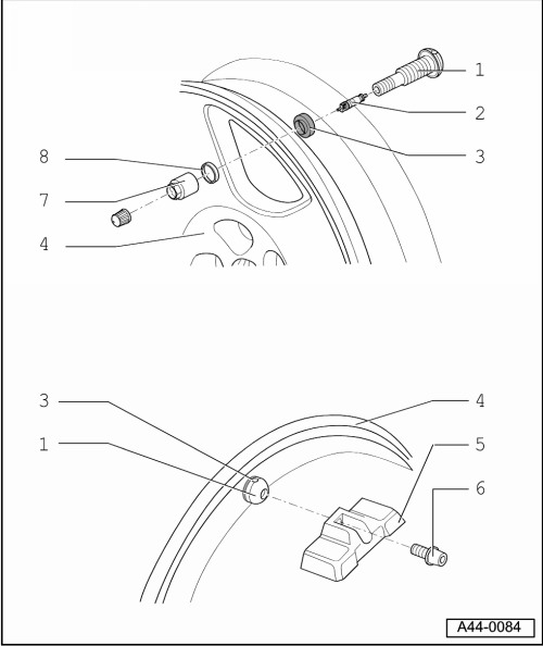

Oki doki, I think I'm going to need 3 valves and 2 sensors as I have 1 brand spanking new wheel in need of both, 1 leaky valve (I think) and the following error:
Address 65: Tire Pressure
Control Module Part Number: 4D0 907 273 C
Component and/or Version: Reifendruckueberw. D310
Software Coding: 22350
Work Shop Code: WSC 00000
1 Fault Found:
01468 - Front Right Tire Pressure Sensor (G223)
53-10 - Supply Voltage Too Low - Intermittent
What I don't get is that it is shown as having 32 months life left using VAG-COM!?! WTF? Anyone else have any ideas what could be causing this?
Tom, I think the part numbers are 4D0907275 for the sensor (as above), and 4D0601361 for the metal valve. Oh and I *think* 4D0601361 comes with both the insert and the cap (N90873301 & N90872901)
Grant
P.s. The approximate life of these units is 7 years (according to ELSA).
