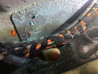

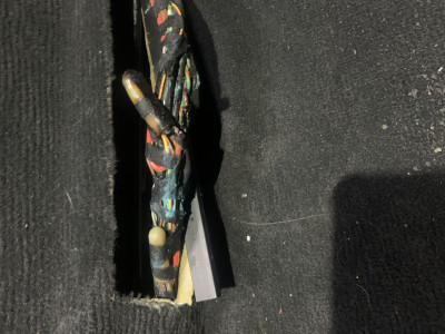

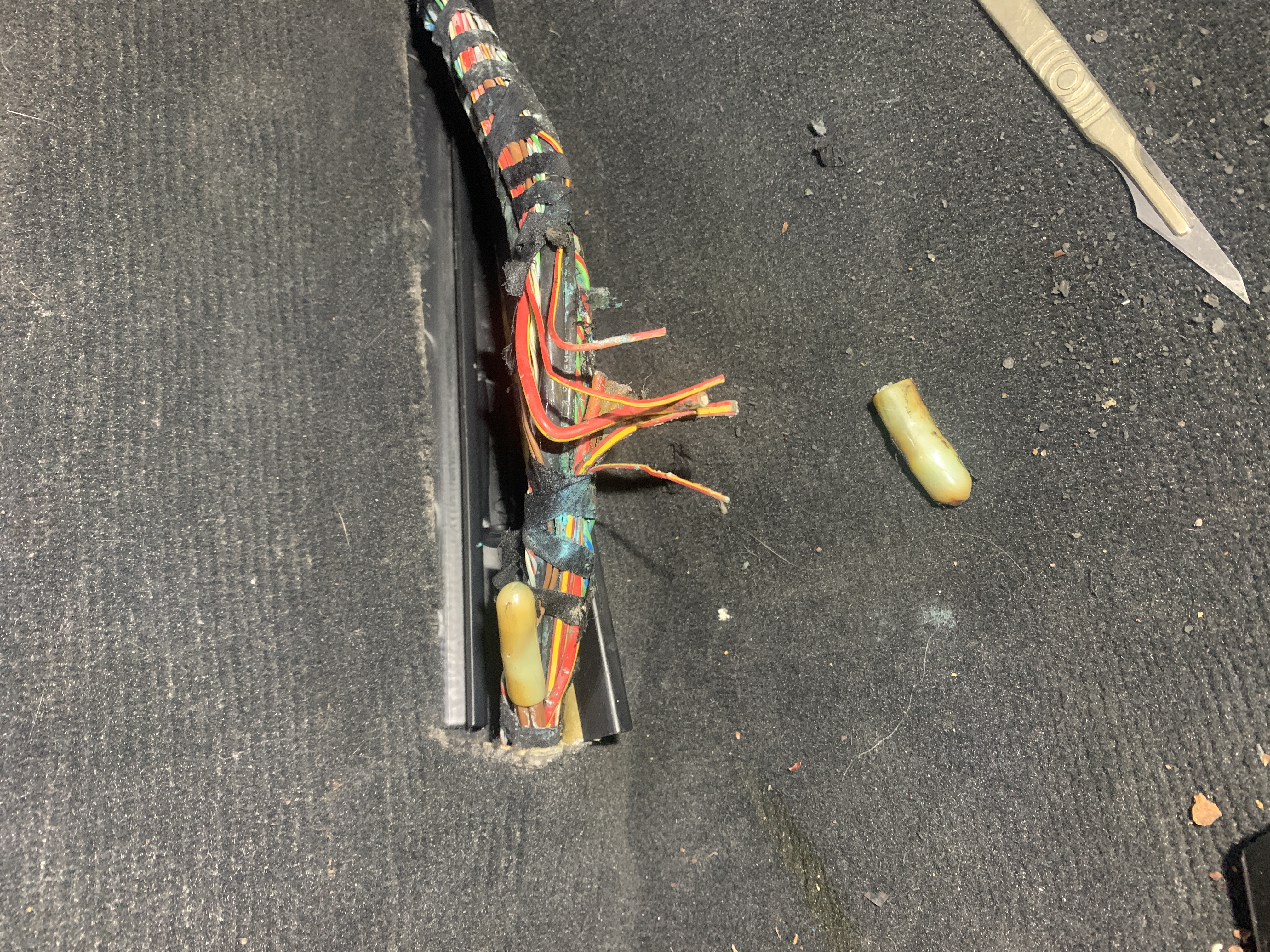

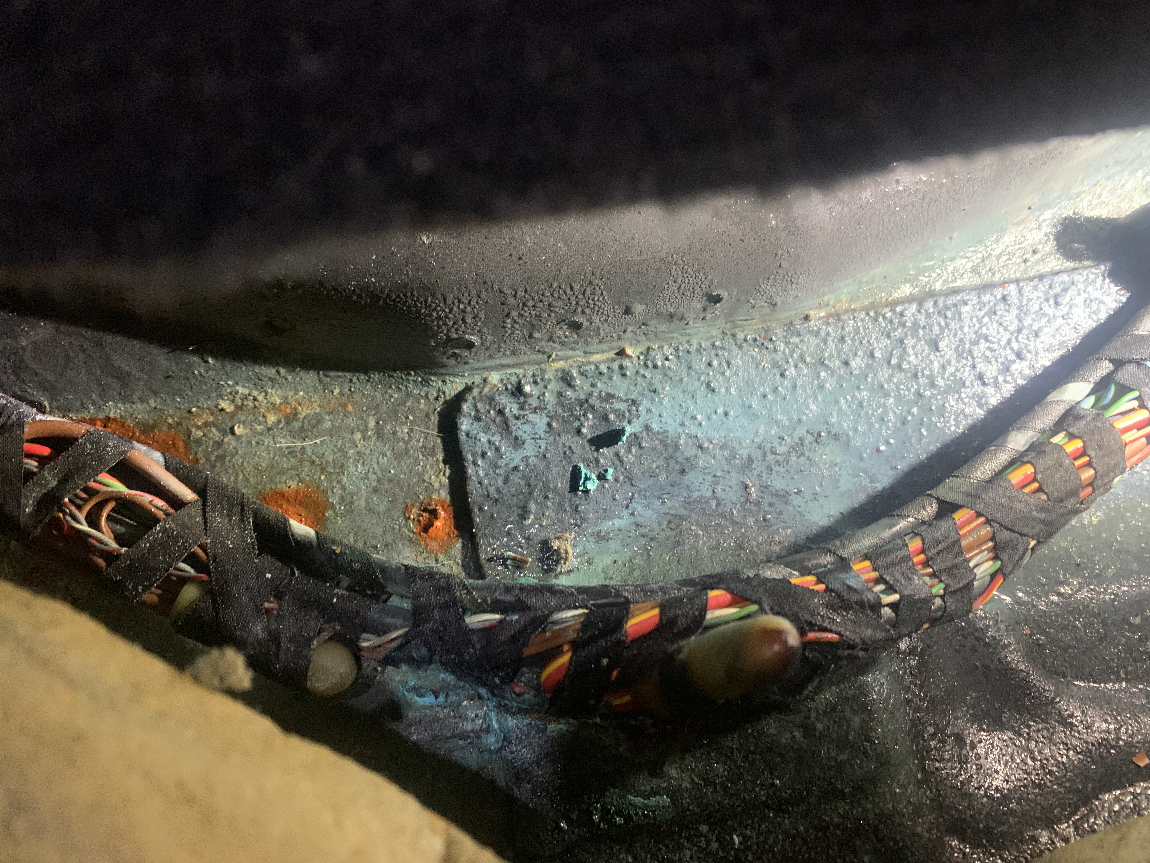

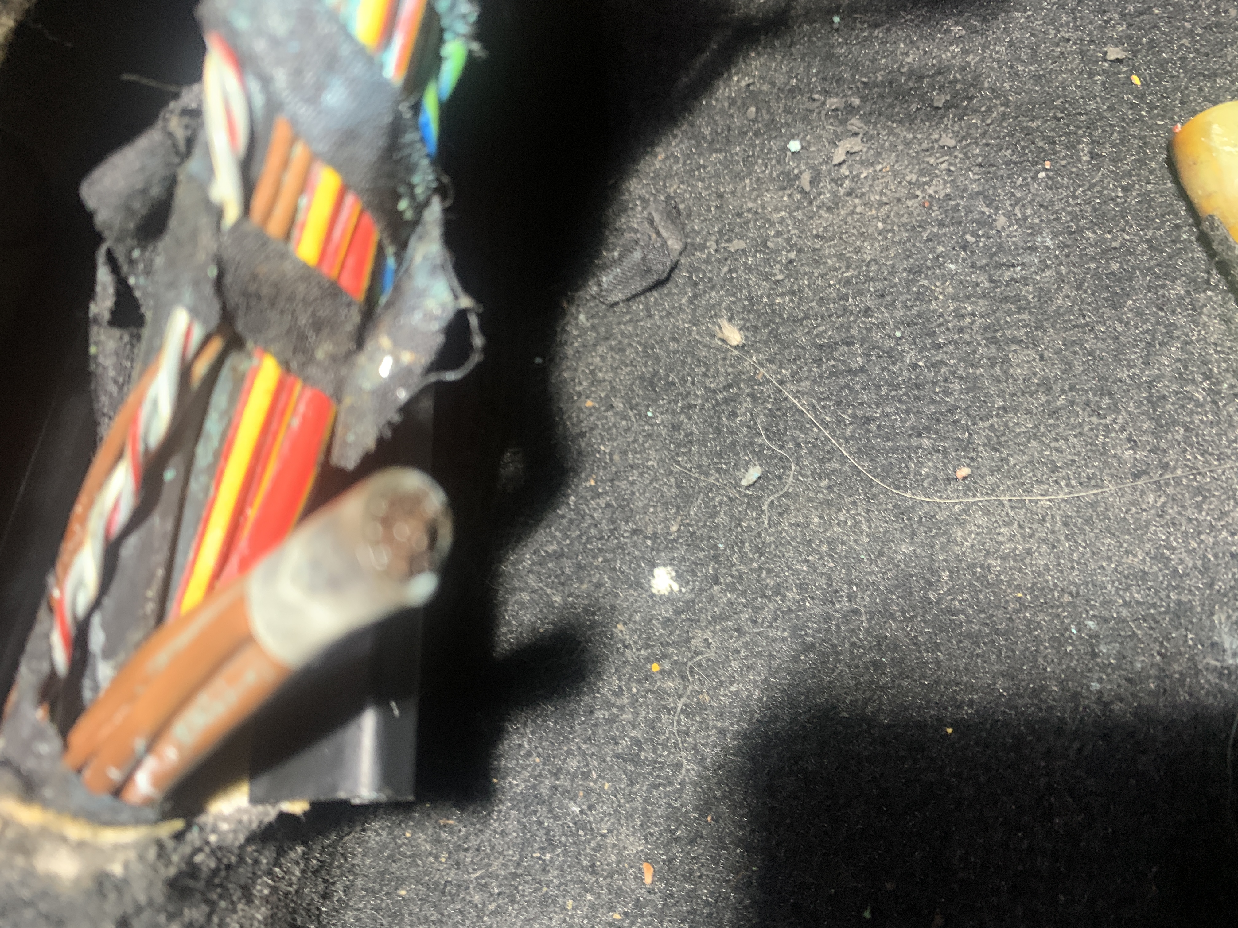

Sounds similar to the issues I was having. Although I have RNS-D. There were about 7 wires terminated in one bullet looking crimp if I recall, passenger side uk car along the transmission tunnel. Below the inner seat runner. Was green full of verdigris. Chopped out and reterminated and got sound back.

Many thanks guys especially Nobbsy and 111marc111 bang on diagnosis. What a <beep> design exactly like the old Sharan I had :audibash:

Without the help from here I would of spent days ripping the car apart trying to find it. I never would of thought to take the seat out and look for wiring along the Transmission tunnel.
