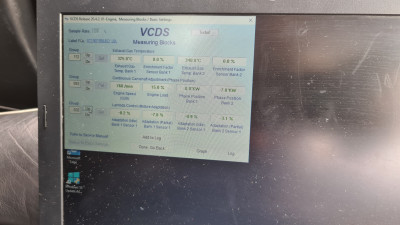

Ill give it a shot, hopefully the damage is obvious.- I remember seeing a reference to a DIY fix but can find it, or it didn't have much detail.

You should be able to see in VCDS if you're getting inconsistent readings though - I saw this one time when I scanned mine. Cleared it and it stayed clear for a week or two and then popped back.

Thanks team. I'm going to do some logging to check the 3k+ phasor readings in block 90. Pretty sure they both match and peg at 22.5 or something but will log regardless. Boost and the control of is what I'm leaning towards being a bit if a problem. Whatever comes from the logging I'll have a list where pulling apart the egt box will.be on.

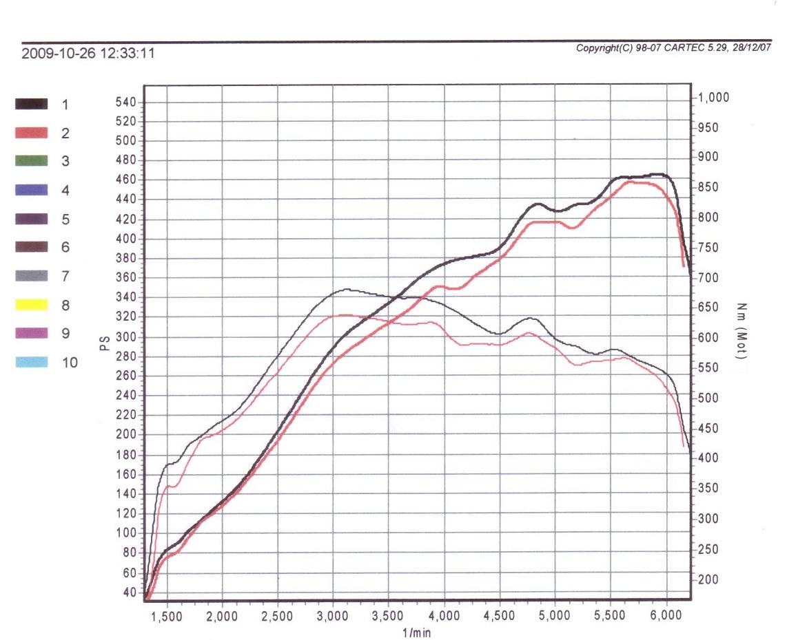

Did some logging over the weekend, but while I'm sorting through the data has anyone got dyno sheets they can post so I can see what the curves look like? I'm mainly interested in seeing the torque curve.

Yeah, dynos are notoriously random, especially when back calculating transmission losses. And worse with all wheel drive cars. It's not a good sign that they couldn't connect even an ODB2 real time reader. IIRC the boost (or manifold pressure) is available as an ODB2 data feed.
Here's my plot on a 100% stock car:
Re: Who nicked my kilowatts?
Thanks Shop. I'm slowly plotting both curves (approximate), then I'll compare this chart with the log data.

Update: redoing the solder for the wiring seems to have solved the problem. Both egts are providing the same/similar readings, the suspect sensor is no longer showing Chernobyl level temps.

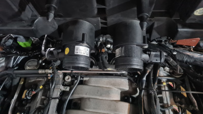

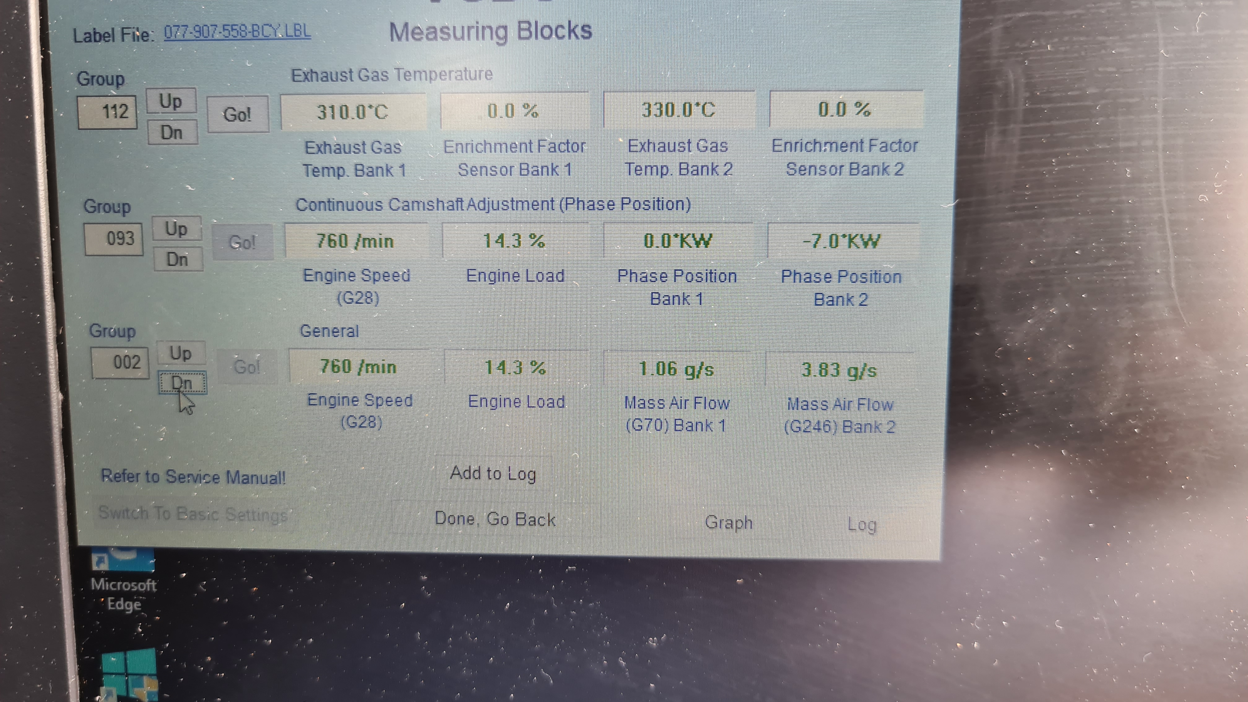

Next problem is the MAF readings, I will test the supply voltage at the plugs to confirm they're where they should be (sometimes the voltage can be low due to a duff fuel pump relay), then I will replace the maf seals on the manifold side. The wiring has been sorted with new plugs, grommet/bits and extended wiring ~7".
3
Then I need to address the cam reading and retime it now I have the proper VAS tools and genuine replacement camshaft bolts and washers.
I do wonder if point 2, 3 or both (and which bank) would cause the lambda readings to be out -7.8 vs -3.1.
To shops point re the power, fixing the egt reading seems to have made a difference in how the car accelerates.
2
3

Cheers Shop, such a faff,. especially spending 2 hrs fiddling the wiring loom(s) to get the airbox to sit right - even then its not perfect.
Yeah, the airbox is a terrible design.
