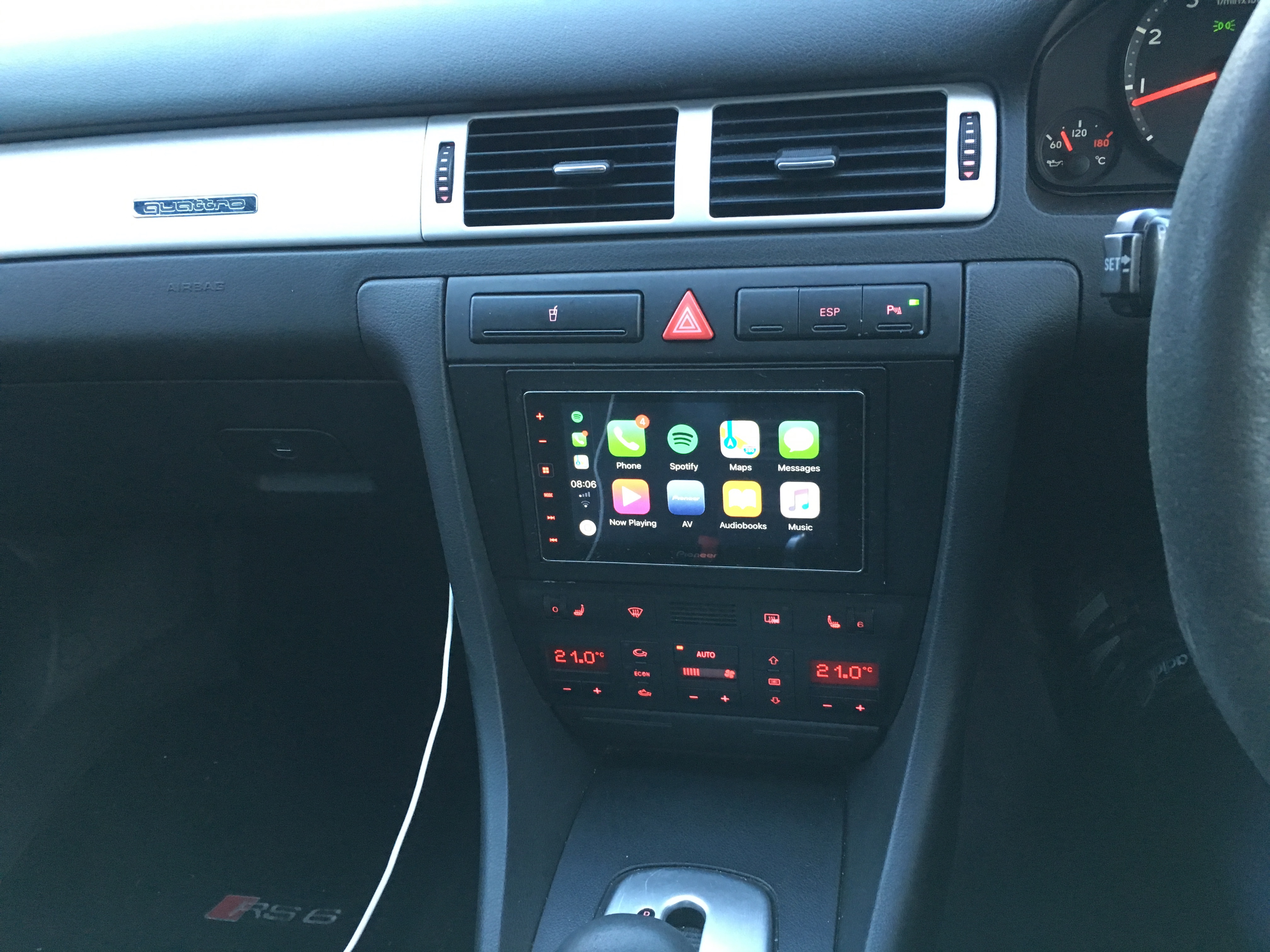

Re: Aftermarket head unit to replace RNS-D
Just for reference - not the best picture, but you get the idea...

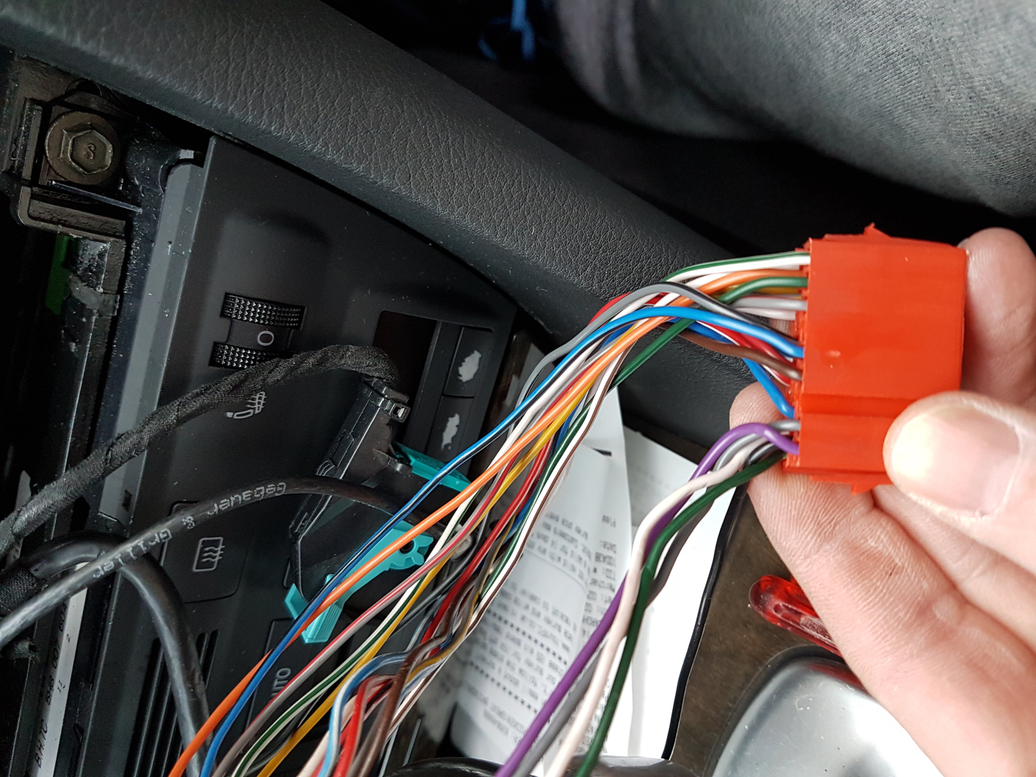

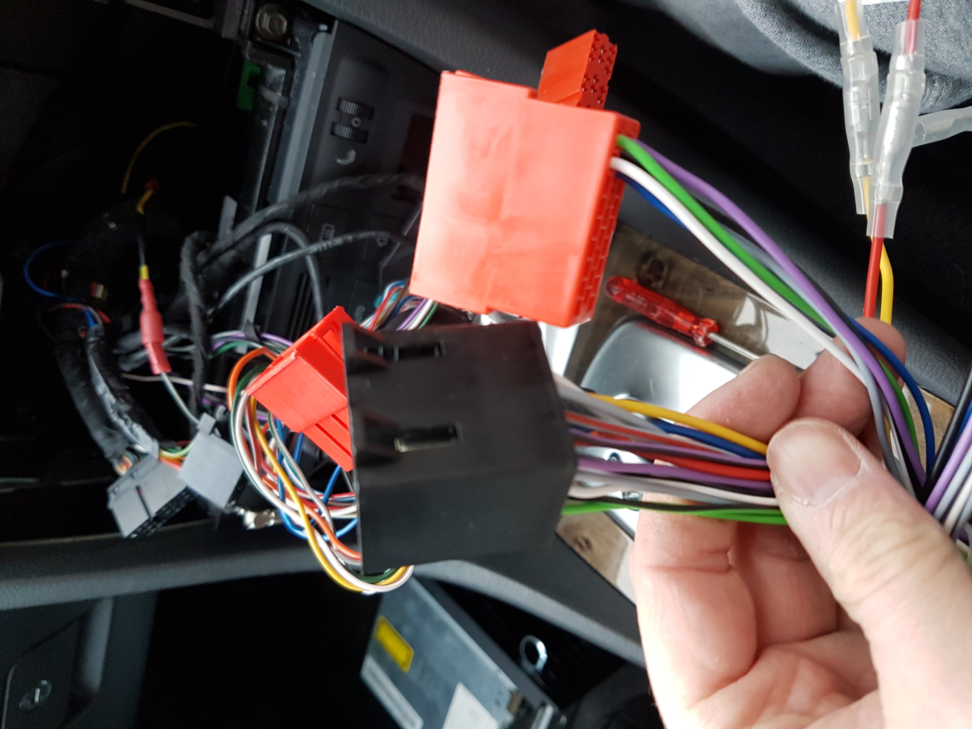

For some reason this appears to be what I have behind my dash. Plugging everything in seems to allow me to turn everything on with ignition and it goes off with ignition, but I don't seem to have any sound at all !
Looking at the wiring it appears that half the speaker wires go to one plug ? And half go to the other ?
Is this even standard wiring ? Or has it been played with before ?
Of the 2 black plugs, the one on the right seems to give the power, but the one on the left I have zero idea what they are ? Don't think they are speaker wires ? As I though those were the grey, green etc which are split amongst the other plugs ?
Yeah that looks different to mine. That red bullet connector in pic 3 is not standard I dont think.
The aftermarket adaptor I got was this one from amazon. The blue bullet connector I think was for the remote to the sub (if you put this on the wrong one, it keeps the amp running all the time)
It's really hard to remember!
Yeah I certainly think someone has had a poke around here before. There is a parrot thingy my bobby stuck to the dash which I am going to remove, maybe this is sliced in somewhere ?
Like I said, it all appears to power up fine. I can connect my phone to it but just no sound. I may have to start unpicking the blocks where the speaker wires "Appear" to be and join them up and see if I get sound...
Or I may just pay someone who know what they are doing to avoid me setting the car alight 2 weeks after getting it
