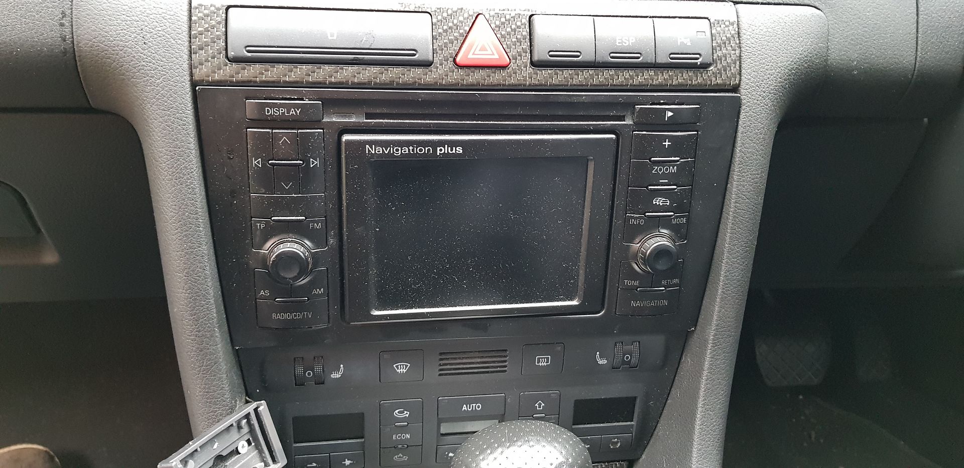

I thought that 2004 cars came with the later stereo?
Amongst the cash above, I found 4 stereo removal keys (the type that like to try to cut your finger tips off!) and the stereo wasn't fully pushed back so someone else has already been in here to look around.

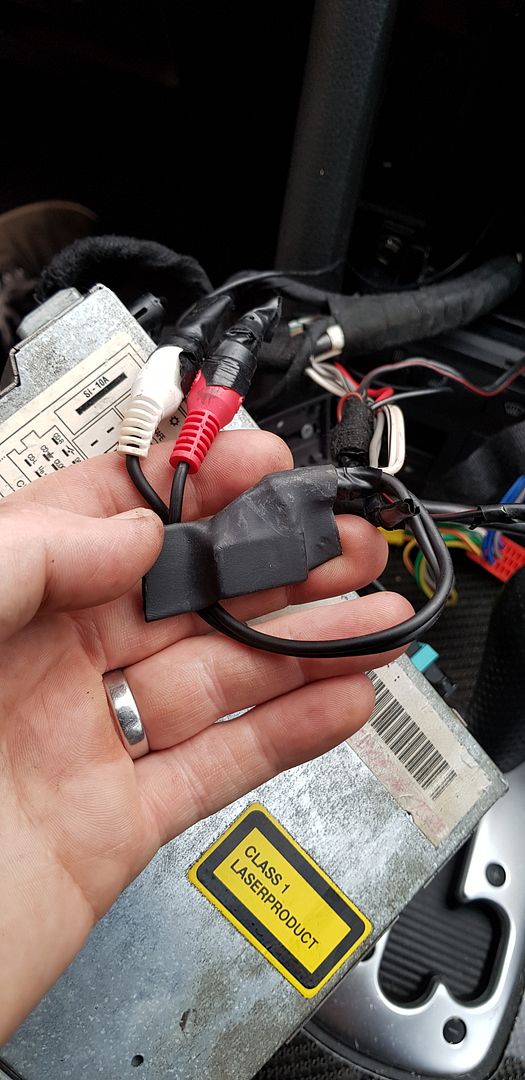

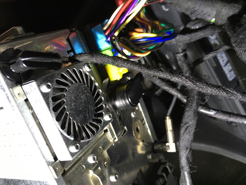

This is what's behind...
An extra loom that has nothing to plug into?
And some alterations to the original loom, an extra plug that has heat shrink over it along with some audio connectors.
Anyone know what's going on with this?

Looks like it may have had a RNS-E or aftermarket. Innit.

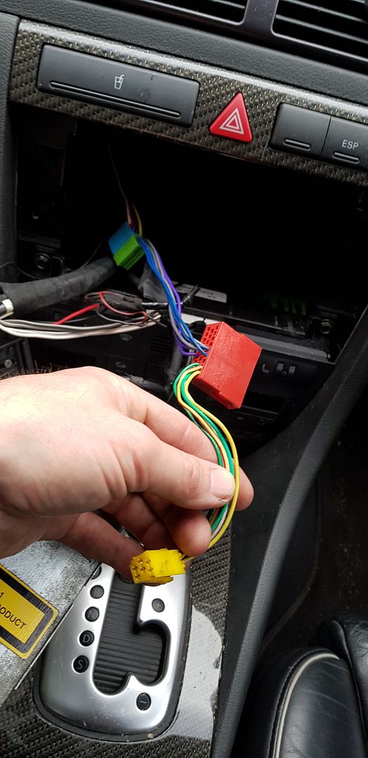

Have a look behind the glove box (5 bolts to get it off) - it might have a box with a lead coming out (3.5mm jack) for plugging in your music into, instead of the CD changer.
That yellow plug in you hand slides on to the blue and green one to form a single mega plug, which then goes in the back of the stereo... were they pulled out and separated already?
The connectors and wiring is exactly as I found it. There's no where for any of the above plugs to fit into in the back of the RNS-D
There is a wire kicking around the passenger footwell with a phone connector on it. I presume that's it.

Fairly sure we have the same stereo so this is how mine was setup prior to an upgrade (you can see the aftermarket plug that you had in your hand)

Hmmm, ok myabe I'm being blind. I'll pull it out again and have a look. Thank you :thumb:

If it helps, the proper audi harness (black, nicely taped up etc) fits into that red adaptor, then the yellow, green and blue segments all combine and fits into the stereo.
