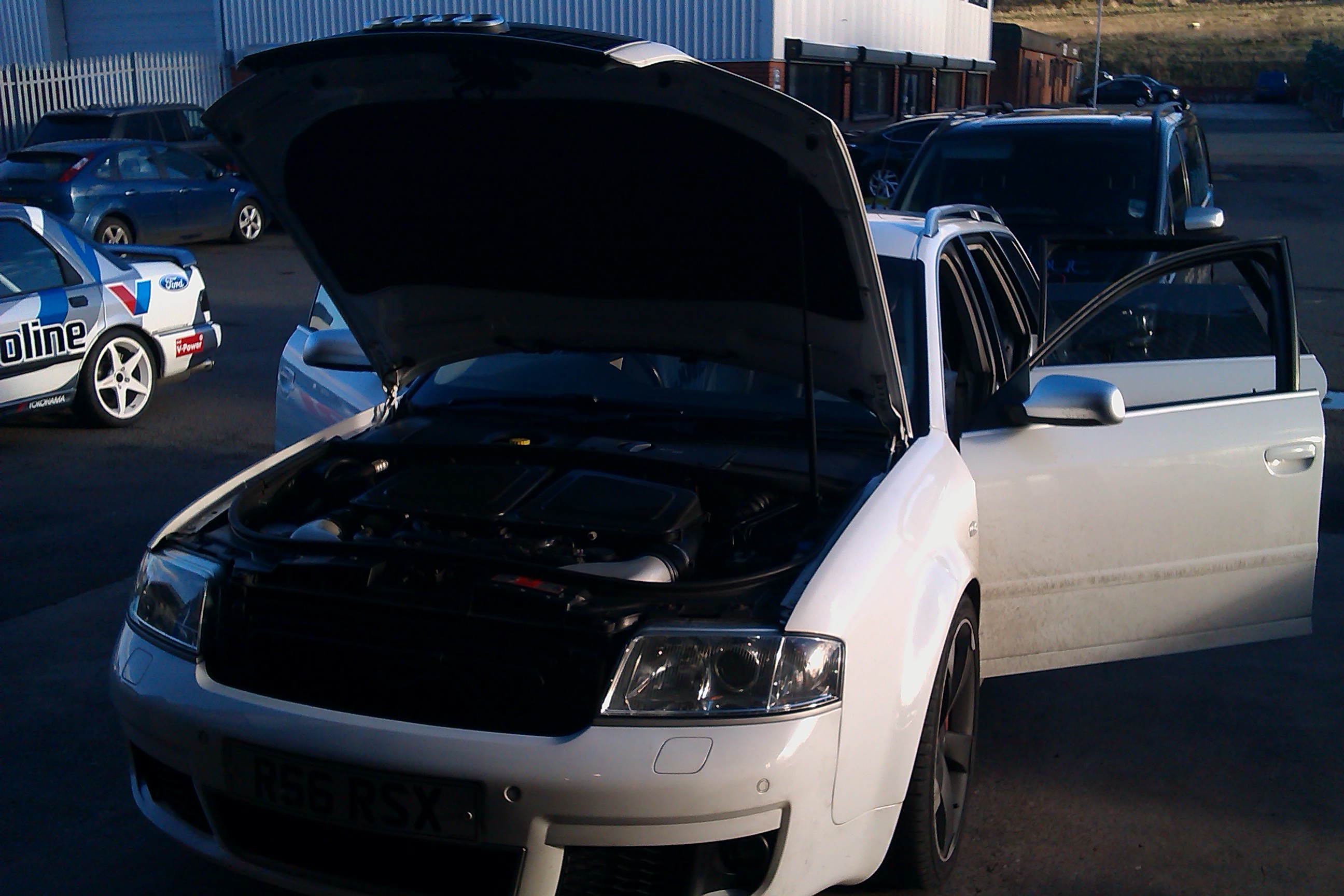

After some WOT action yesterday I noticed I'd developed a pretty nasty boost leak, sounded like a hairdryer was on full blast in the glovebox....
Had a quick check but couldn't see any obvious hoses blown off, IC's still all attached etc. so I called an end to the hooning and drove home like a nun.
Left it with them to have a mooch.....
