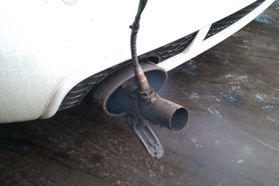

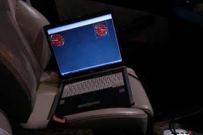

You need to get a data logger on the ECU and check your injector duty cycle at the top end of the rev range, plotted against boost and AFR. The standard injectors are quite small.
How far do you want to push the turbos & do you have a flow chart for them? At the moment, I'd start by seeing what my injector %DC was when I had the right AFR at peak revs, the size from there.
