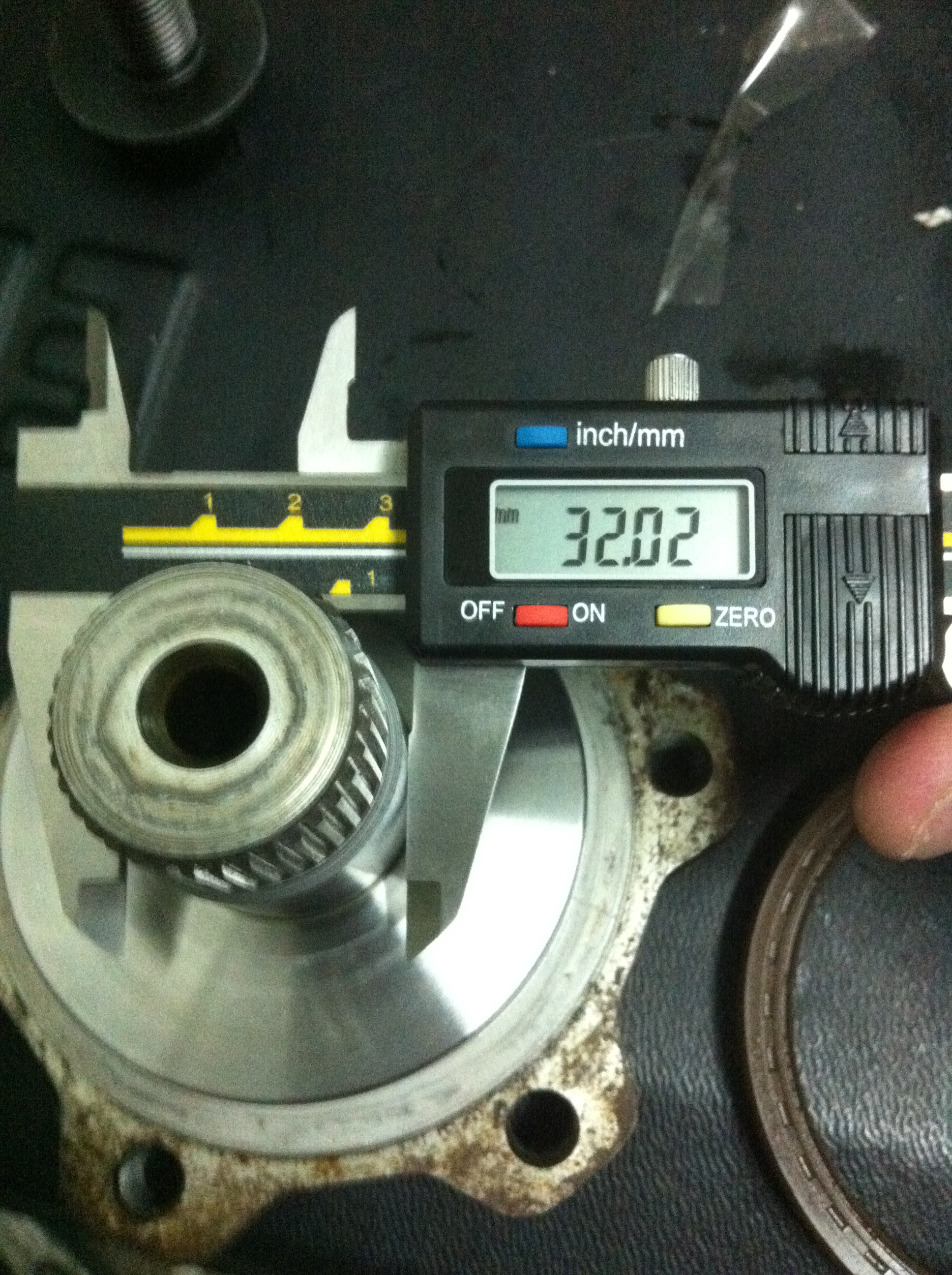

Came across this...
Im not sure if the RS6 flange has the same diameter as the S8 one...

Re: Clunking noise ...
Assuming the S8 flange axle has the same diameter, dont think mine is worn...

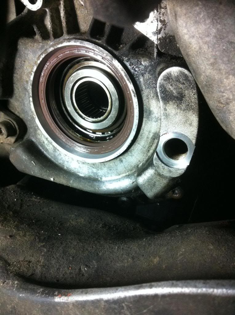

Doesn't look like it. I would just put it back with the new oil seal, clean up the area around the diff, then see how it goes. If there's no more leaking and no play when the axle is in, then your problem is probably coming from somewhere else.
yeah i hope the leaking is gone with the new seal in, but the seal wont solve the play (and probably the play will get it leaking again after some time). the part that touches the flange is very flexible. You can see theres a metal spring behind the part that touches the flange. it can be modded to tighten the spring, but i dont touch it. So i think (if it cant be solved without having to take the engine/box out) i have to live with the clunk or get myself a black plus
...so the new seal is in, waiting for the oil to be delivered today...

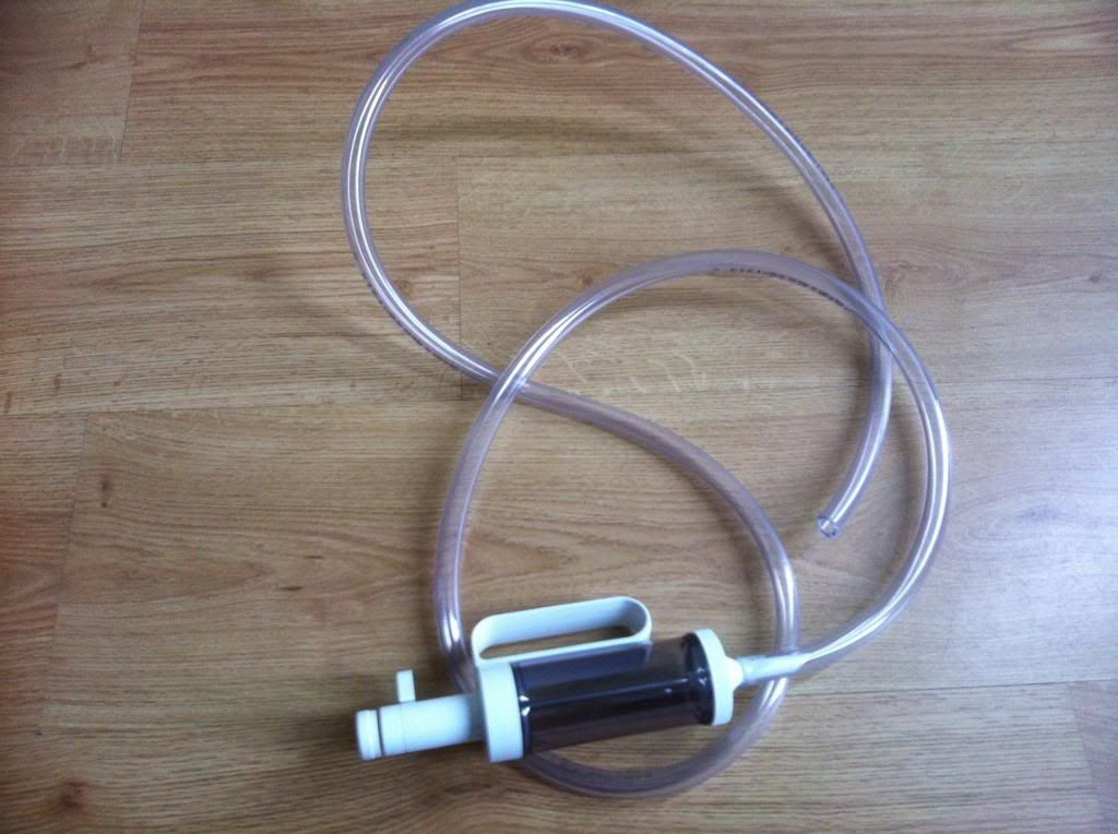

^^That is one weird Dutch sextoy.
How'd you push it in, in the end?
