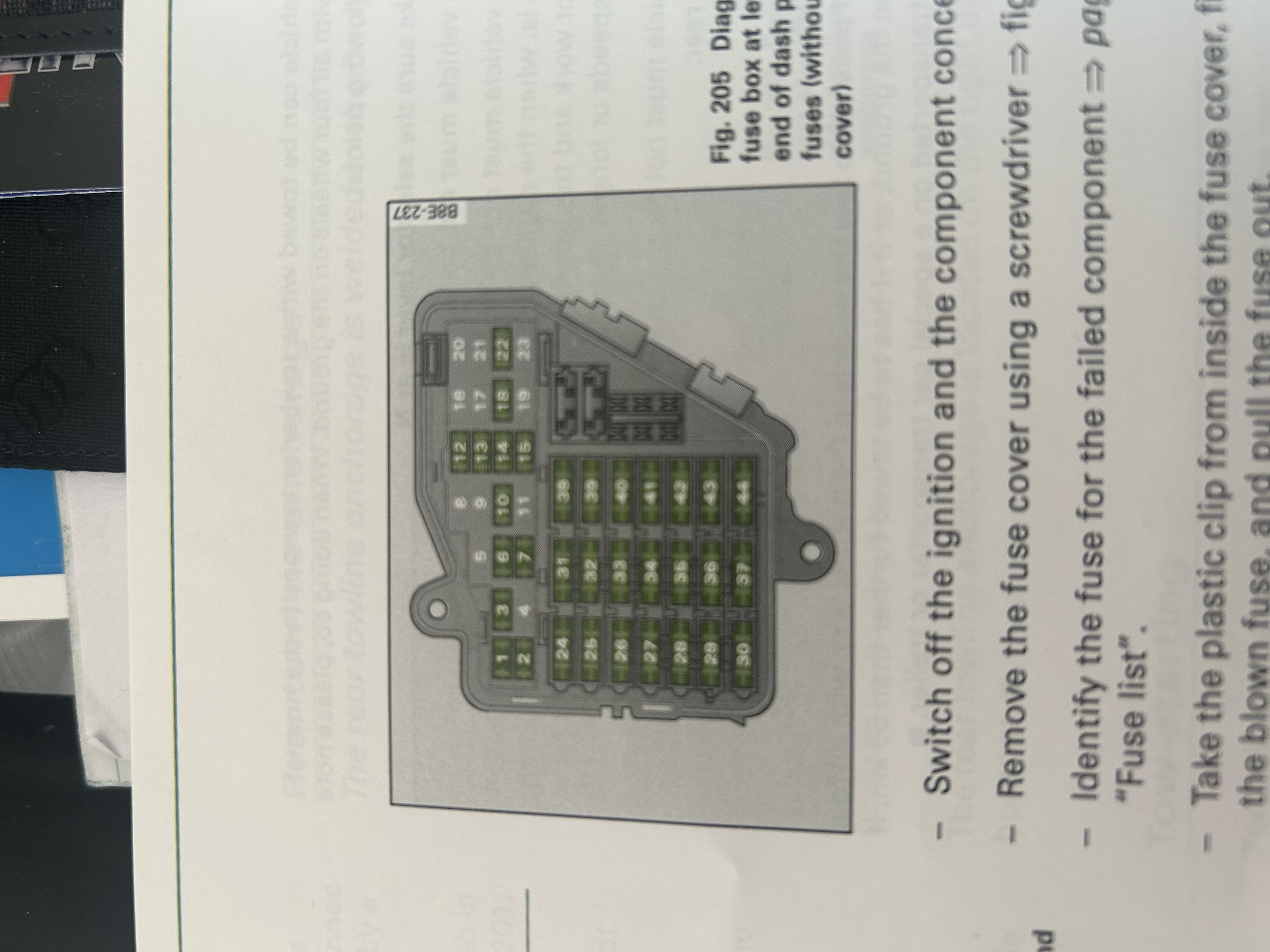

Fuse diagram here:
https://www.autogenius.info/audi-rs6-c5 ... x-diagram/
Number 37 I think by the look of it.

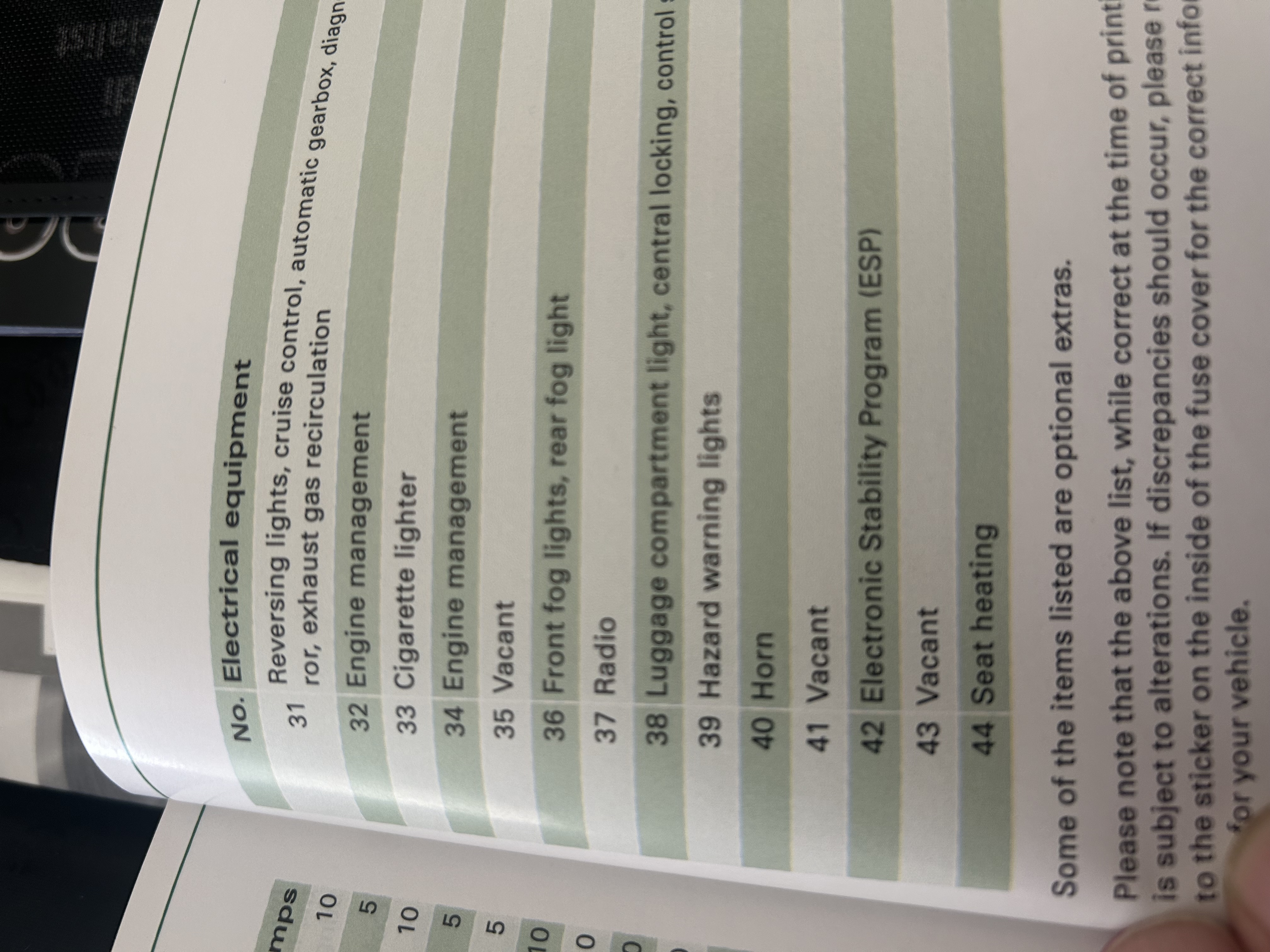

Hi Paul. As above fuse 37. According to my owners manual
Steve, that diagram doesn't tally up with my fuse box, number 43 is a radio fuse 5 amp. Strange, also that picture appears to left hand drive.

Hi Paul. My car is RH drive.
I will check my fuse box tally’s with diagram.

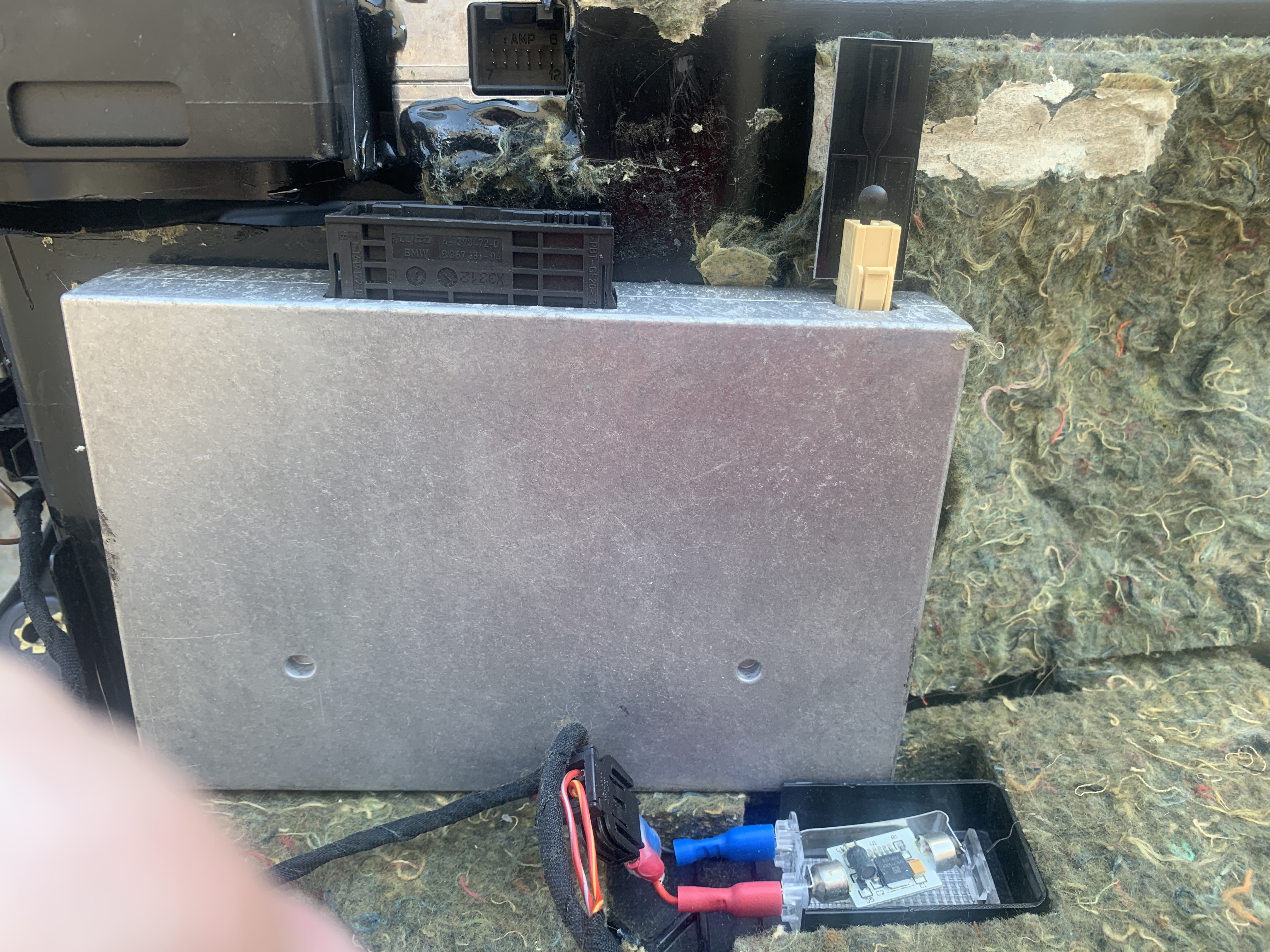

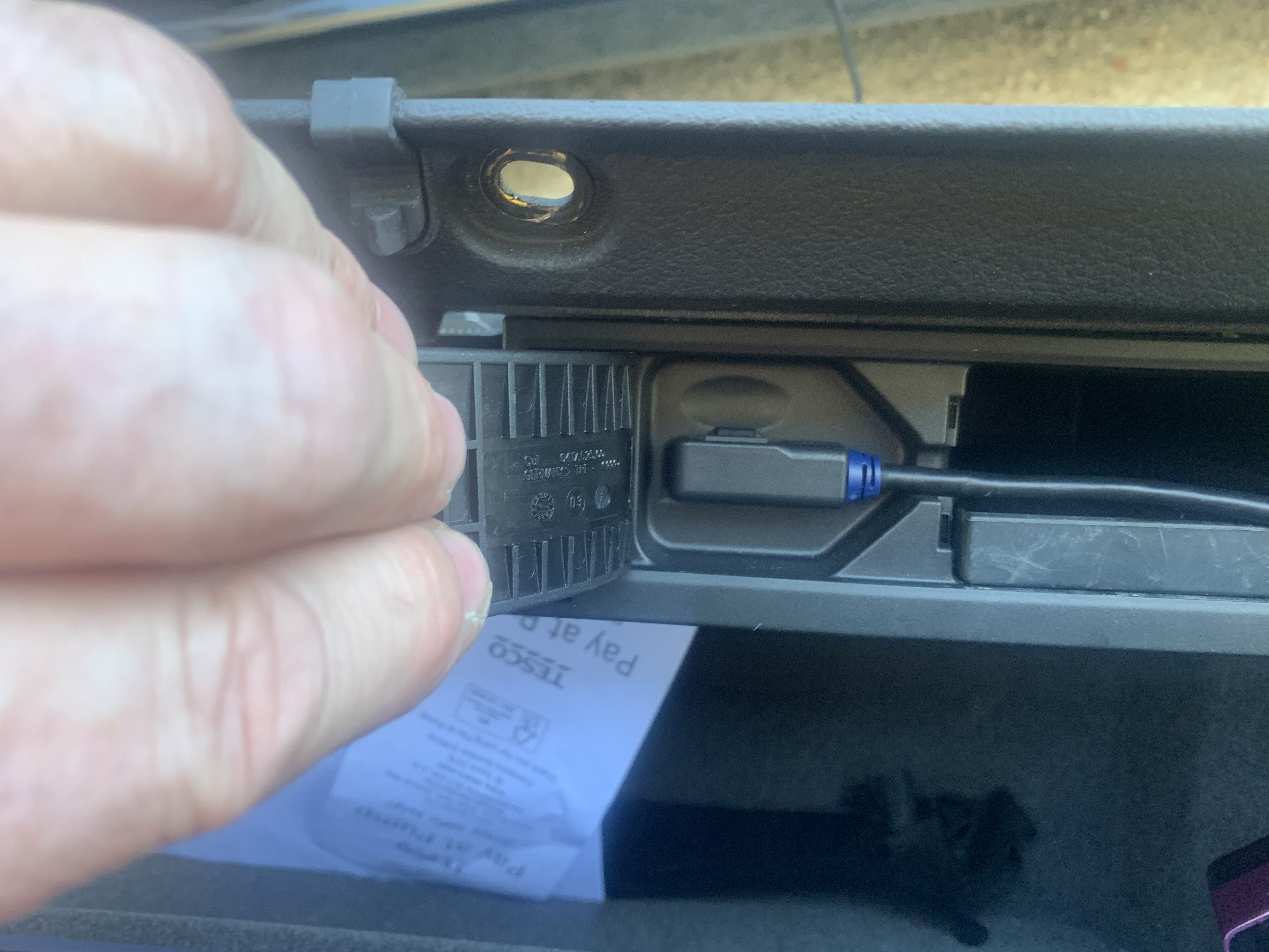

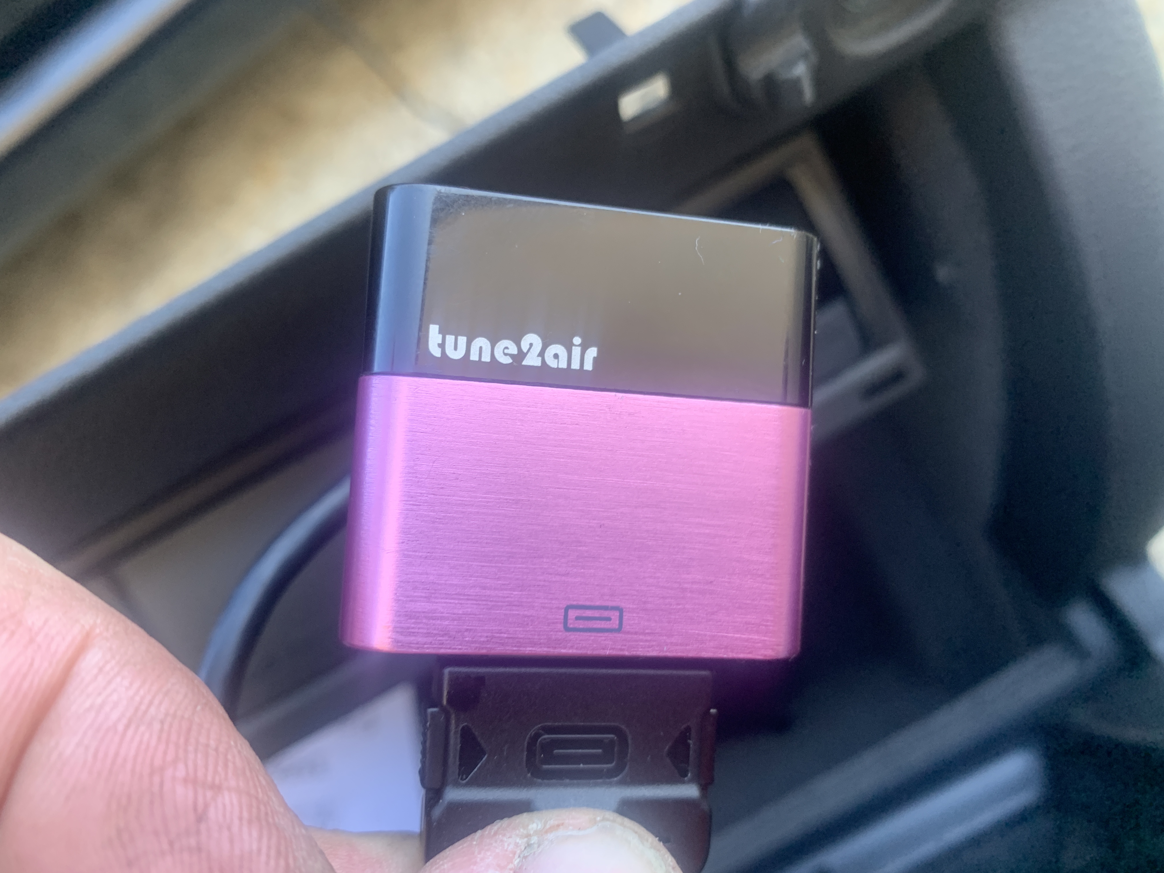

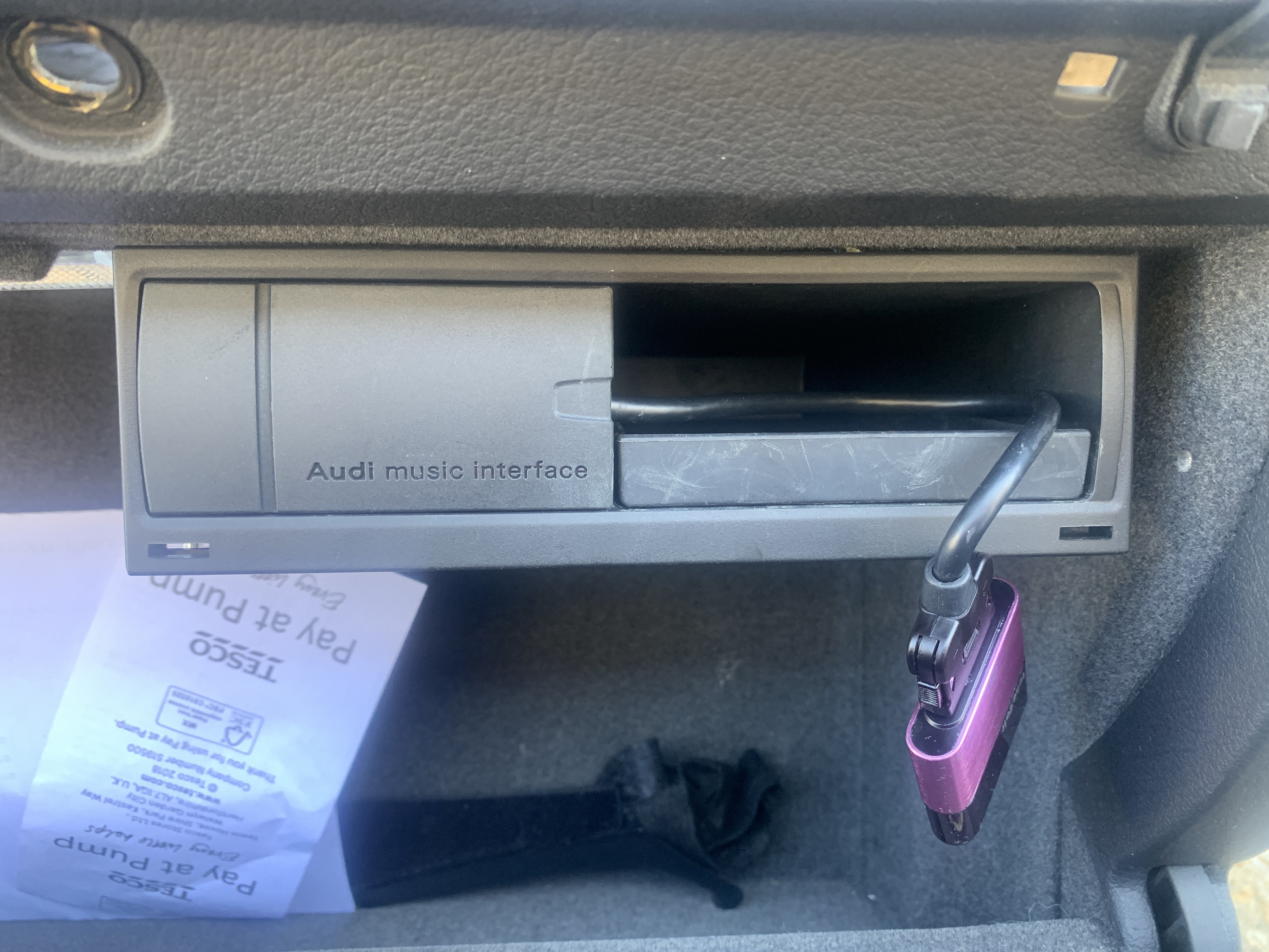

The plot thickens, just pulled glove box out and found this lot. Haven't got a scooby what it is yet but has an old Ipod connector on it. I know the big silver box is the bluetooth module.

What on earth is that Frankenstein bulb holder circuit? :shock:
That's one of the many LED lights thats Footers fitted, guessing its canbus error free with the circuit board :bigblink: Think they came from Trups.
