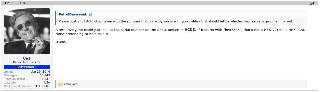

This is a most excellent outcome and I am happy to hear all is resolved regarding the authenticity of the cable - that comment from Uwe Ross, 'Chief Cook & Bottle Washer' at Ross-Tech really didn't help. As founder of VAG-COM you would have thought he would know betterandy28 wrote: ↑Mon May 05, 2025 10:03 pmGood evening all
I just wanted to provide an update as I have now heard from Ross-Tech and they have confirmed that it is a genuine cable.
My confusion was that I had spotted the negative clone comments about serial codes starting hex7386 (like mine) but the one I have is a genuine hex-usb cable and has a valid serial number.
I still have my error but I will get the cable transferred on their system so I can access their support.

Yeah, I've never been very impressed with the support at Rosstech.
Re: VCDS
I agree Topman, it was those comments like the one in your screenshot that made me doubt myself. Uwe should probably say it could be a clone or a genuine legacy cable! I’m glad it’s sorted.
I’ll let you know Shoppinit, they have been very responsive so far but I haven’t raised my fault yet. They might say it’s a compatibility issue as previously mentioned here but it says it works on 2015 cars so let’s see.
Re: VCDS
Yeah, my earlier comments (including that comparison table link and questions around age of vehicle, HEX-USB vs HEX-USB+CAN, etc.), relate to my continued suspicion that it may indeed be a compatibility issue, sadly - basically, that CAN-bus interoperability may be needed for the changes you're trying to make.
It is, after all (from what info is listed above), a 2003/04 cable that you're using against a 2015 vehicle.
I've experienced similar before (hence all the info-gathering questions!) when I used my old cable against a newer (CAN-bus) vehicle, and ended up getting myself a newer VCDS cable, as they're generally backwards-compatible but rarely fully forwards-compatible... as is often the way with technology, of course!
