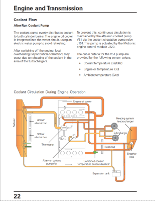

You don't want that one that Steve bought years previously. When this was available from Audi Main Dealers, you could only buy the pump with the bracket which made it very expensive when you only want the Pierburg pump. I believe that you wont this part number 077121599A from any of the normal parts suppliers. The only place you can buy it is from Audi Tradition (I can help you here if you need as I have an account) it costs approximately £300. But it's much cheaper to buy just the pump without the bracket from AutoDoc for approx £83 :-)
I have used this pump for almost a year now and no problems (as it's the same).
Don't be fooled into thinking this pump is not needed, its essential to the longevity of your turbos. I attach a page from the self-study guide for our cars so that you can learn how it work, it's quite clever. Mine wasn't working and I think this is the main reason why my turbos cooked (an expensive and time consuming job to replace).
Have a nice weekend - and don't trust AutoDoc to tell you what actually will work with your RS6 - we have the knowledge :audibash:

Thanks for clarifying Craig, you chaps are a font of knowledge :notworthy:
Seems that AD have no stock now. Damn, they were showing yesterday but stating not suitable for the BCY...should have just nabbed one with my other stuff.
I'll keep looking.
