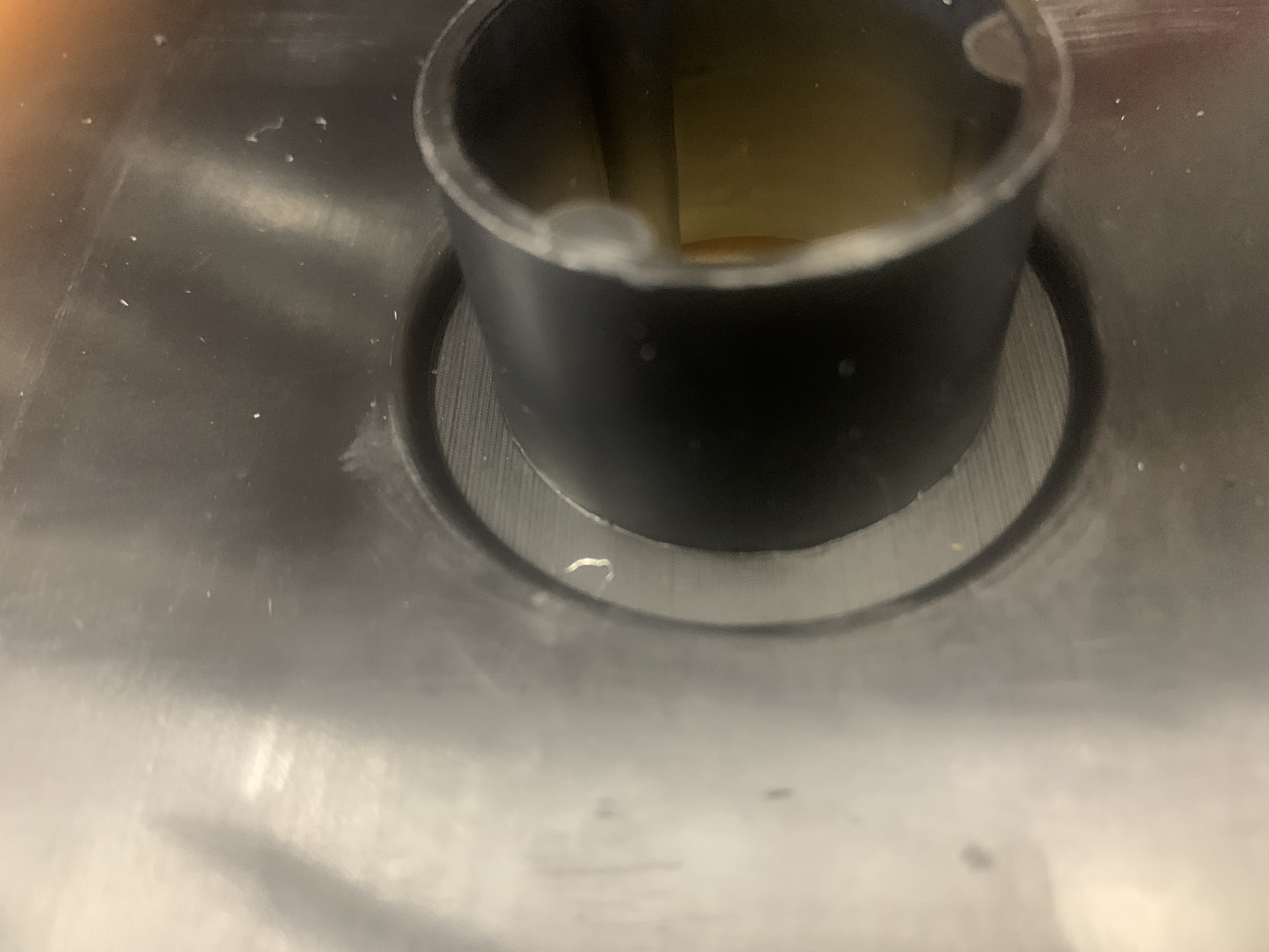

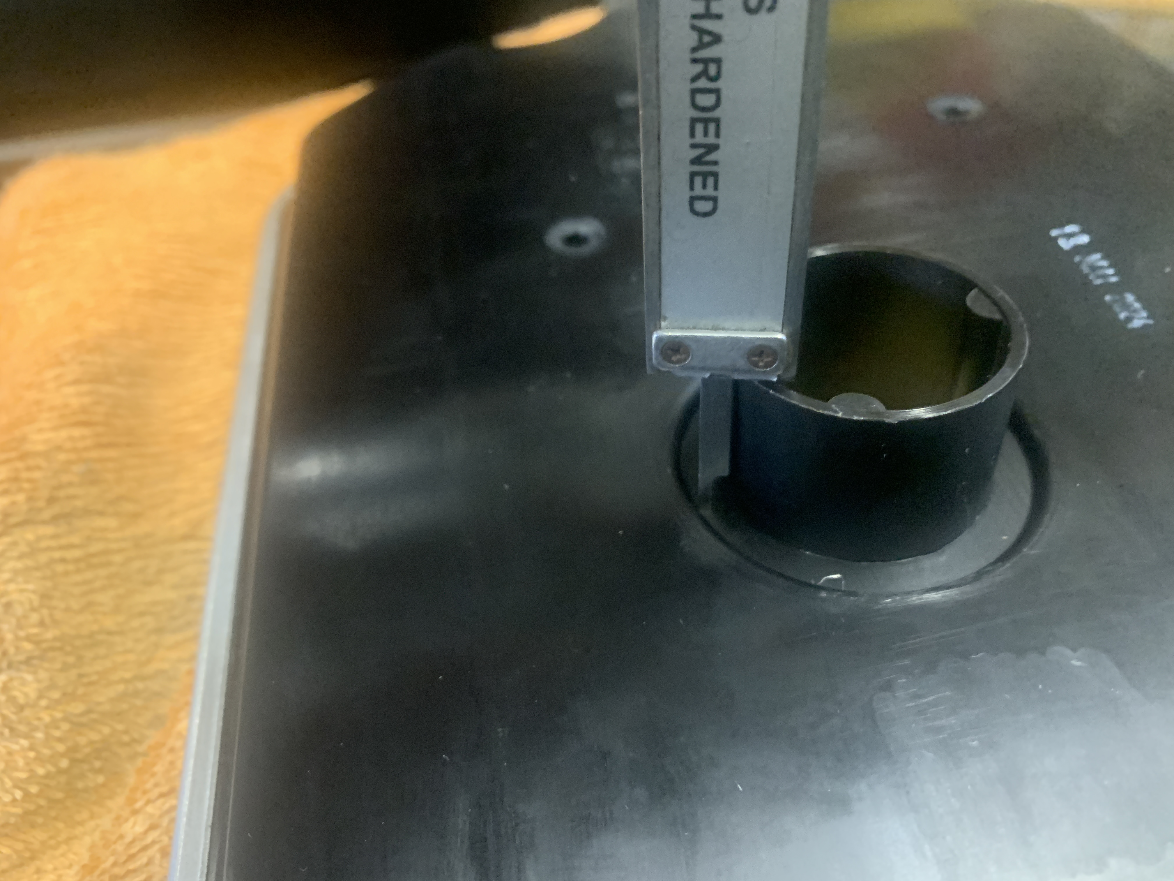

Steve its 20mm if i put the O ring on
Theres is a recess which is 2mm below the rest of the filters housing.
Re: Suction noise after transmission fluid/filter service
You're good. I didn't actually quite show in my original pic on my DIY, but the 20mm is from the flat surface, not the recess. If you look closely at the pic you can see the caliper is standing out a bit from the tube - but it's not clear. For completeness, would you mind taking a pic from the flat surface with the measuring stick on that I could use & add to my Filter thread above?
And as long as you have the part numbers matching my links above, it's spot on (which you do)
(FWIW I never saw a 25mm one - I know they exist for the 5HP24 box, but not for any of your Audis that I know of)

Hi bilco1.
Yes mate 22mm to bottom of recess.
20 mm was to flat surface of filter.
Although I used a vernier caliper. The garage used a steel rule. Hence 20mm became the norm for me.
After reading all of the above. I guess my original problem stems from the garage installing the wrong o ring.
Like Matt. I have never seen a 25mm long neck.
But they do exist apparently.
