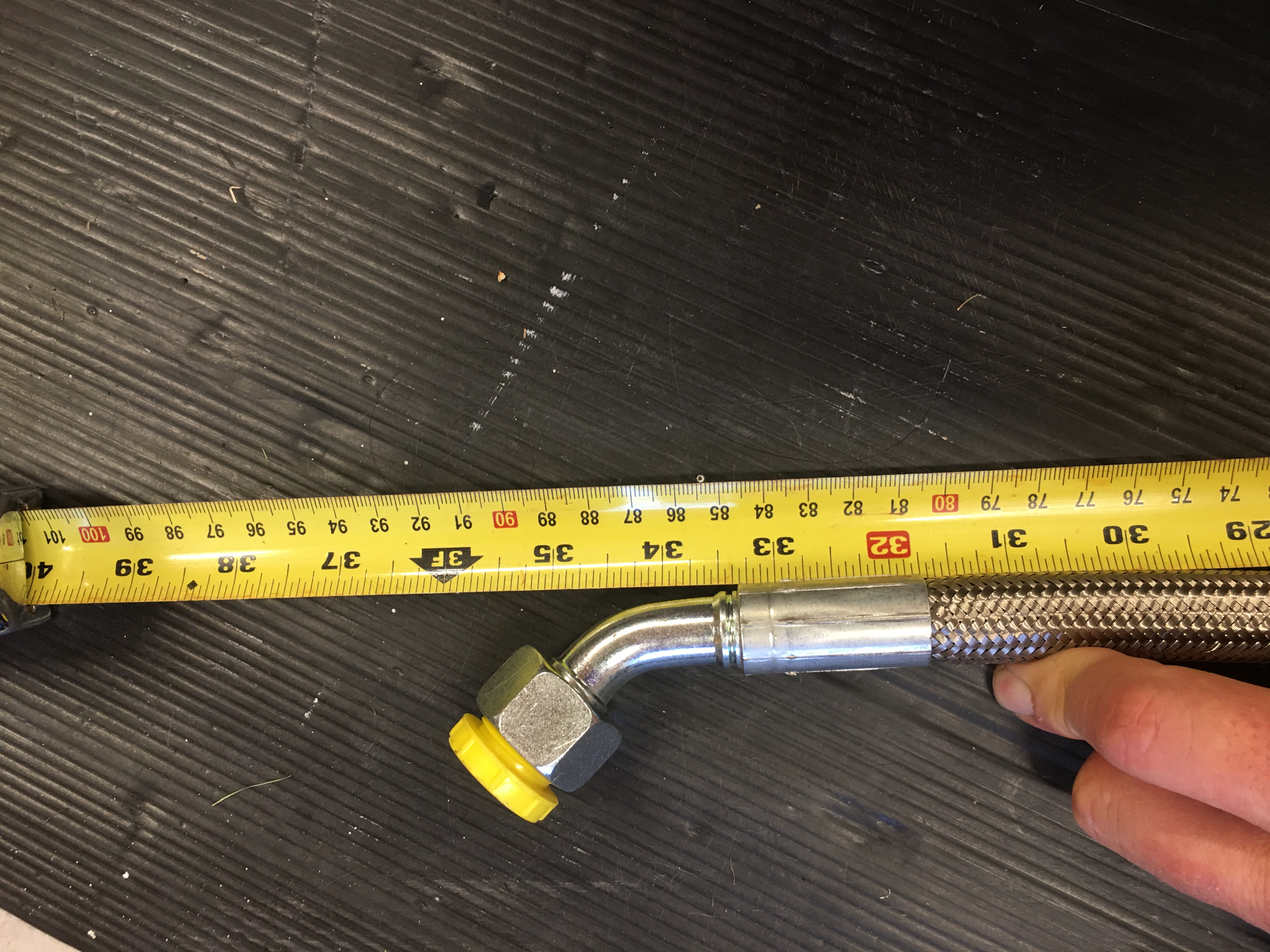

I plan to put all the replacement pipes out and measure the exact sizes and will post with pictures should anyone wish to have some made by a a hydraulic specialist which may help others in the future.

3 hoses for oil cooler lengths. Will add the relevant part numbers to the photos. Just need to double check them. Maybe of some help to someone in the future.
