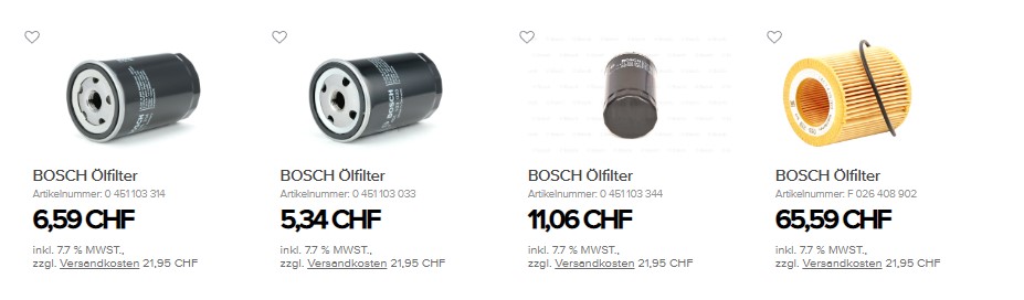

Looking at auto-doc I get about 4 different Bosch oil filter, ranging from 6 all the way to 65 european shillings (m539 :)). Confused. Any experience or advise would be highly appreciated.

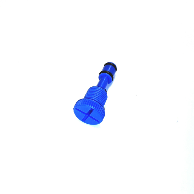

- 4A0121140 radiator plug :evil: :cry:

I'd get a Mann or OE filter.
Autodoc is being a bit crap there. The RS6 uses a cartridge filter like the first 3.
Why don't you cross-reference the OE part number?

Post by Astrosquirrel » Wed Nov 30, 2022 10:07 pm
I'll go for the Mann filter then. My biggest problem at the moment is the radiator plug. It's not available anywhere. I'm hoping I can reuse the radiator from the donor car.

Looks like it would be easy enough to machine a new one if it came to it.
