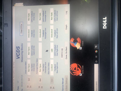

All DTC,s cleared.
When I lock the doors with the remote all doors were showing as safe.
When unlocked
3 doors are showing as unlocked and not safe.
The rear right door is showing as locked and safe
Re checked for DTC,s two faults logged for the rear right door again.

Did you also check the physical action of the door handles?
- Posts: 2956
Re: Door lock micro switches
Yes I could not open the rear right door from the inside.
Even tho it said it was not safe.
Could not open the other 3 doors.

So when all the doors were saying they were locked on the Vagcom you could still open the rear right door from the inside? What about from the outside?
When you unlocked presumably you could also open the rear right door?

Sorry Ben my mistake.
When locked with the remote. I can not open any door from the inside or outside.
When unlocked. The rear right door shows locked on Vagcom. But I can still open it so it isn’t really locked.

And when they are unlocked you can open them all?
- Posts: 2956
Yes mate see above your last comment.
OK, so the motors and the mechanism are working but the CCM isn't recognising the position switches.
If it were my car, I would remove both left and right locks and swap them electrically (they don't need to be in place to test them). Then if the fault moves from right to left you know it's a dodgy lock. If not then it's a dodgy CCM / wiring fault.
