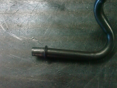

THere's a pipe than can crack that causes loss of pressure. It's accessible by removing the VB IIRC. It looks like this:Shoppinit wrote: ↑Mon Dec 23, 2013 9:37 amIt's either an ATF pressure problem (split pipe, cracked valvebody, worn pump, faulty pressure regulator) or a worn clutch pack.
It's possible that the former caused the latter, even in a short amount of time.
Or if the ATF is low then you could get it.
Or if the pick-up pipe is too long causing oil starvation you could get it.

Re: Solenoids in gearbox
OMG Shopp. Sure enough, it was that pipe.
Split on the flange.
Looks like that particular one might be under stress from new, as my new one need a bit of adjustment to get the ends in square.
01L 321 475.
Can't thank you enough.
Cheers, Phil.
01L 321 475.
Cheers, Phil.
