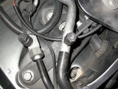

Am i right looking at the pss9 guide, the left and right top mount are hold by only 2 bolts?
The ones behind those covers? (This pic is from the right side looking forward...)

Re: On the road again...
Not sure if i loose those 2 bolts, the spring is loose too?
Or will it come out in ons piece and have to loosen the top of the shock shaft and get the new ones in and connect top new shock?
Because i dont have a complete new setup, i re-use the topmounts etc.
I thought the whole lot has to come out, incl toparms...
Be careful what bolts you undo at the top. You will need to get the geometry done again if you do the wrong ones.
Yes, that looks right from memory.
