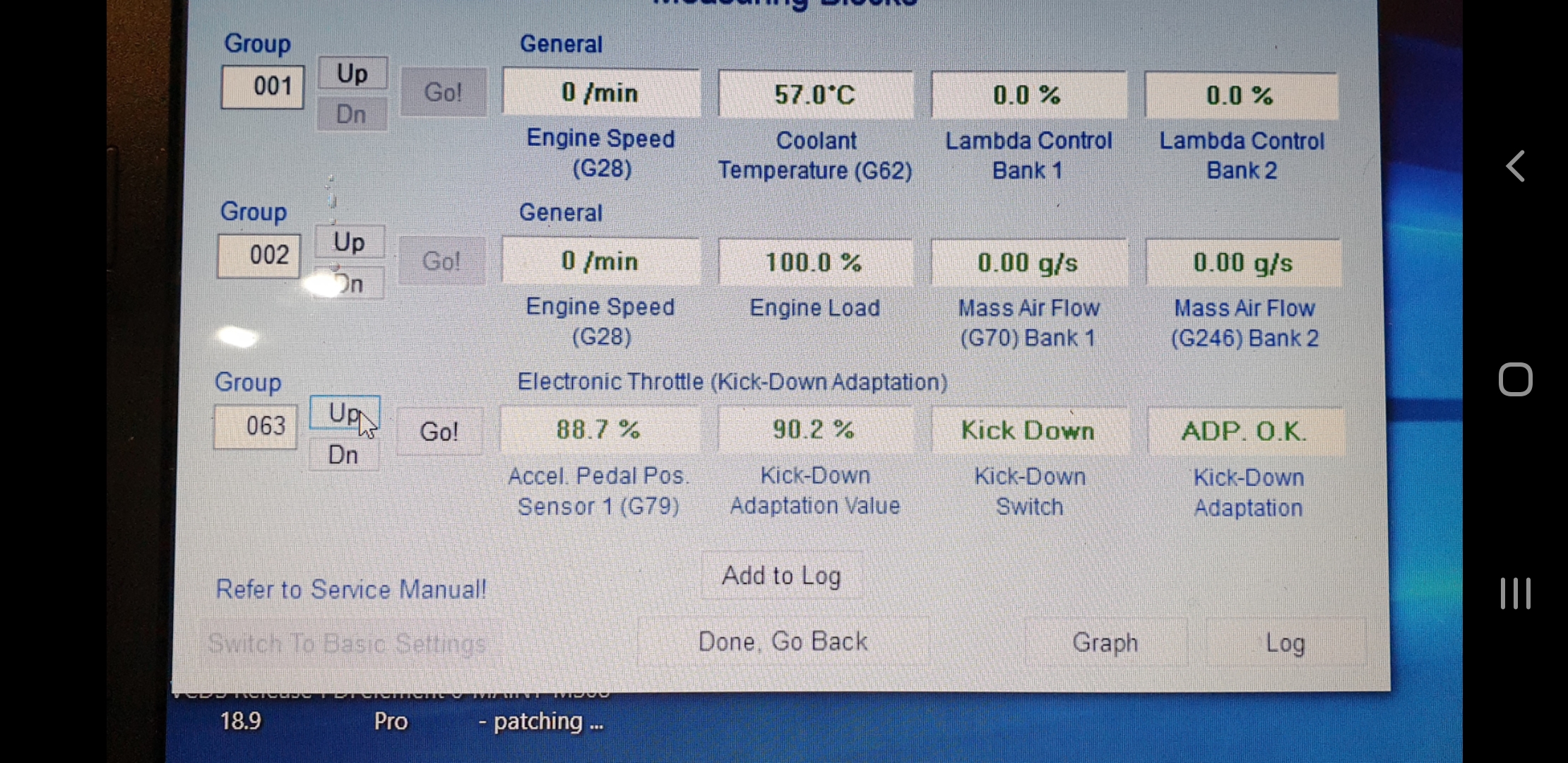

Cheers everyone, I will have a look st the mafs and check for any leaks as suggested.
Gearbox been playing up the last couple of weeks as in on the dash the drive doesn't lite up or its all red...no banging into gears or anything like that so I'm just looking thru all threads related to this and see if it needs a sensor replaced or wiring harness. Box has always been serviced every 40k last one was done last year.
This has just started so I wouldn't think its connected with the map on it.
