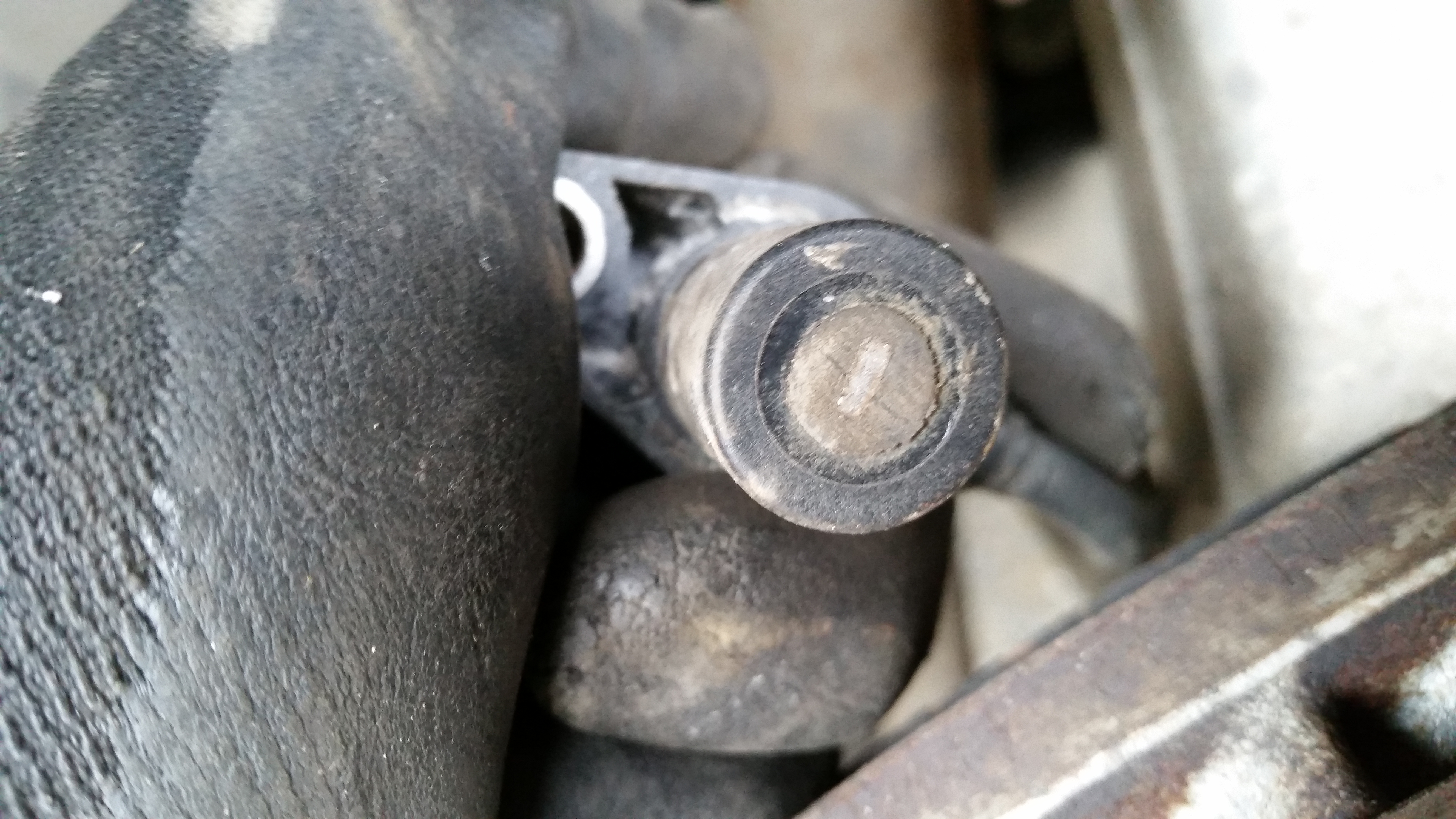

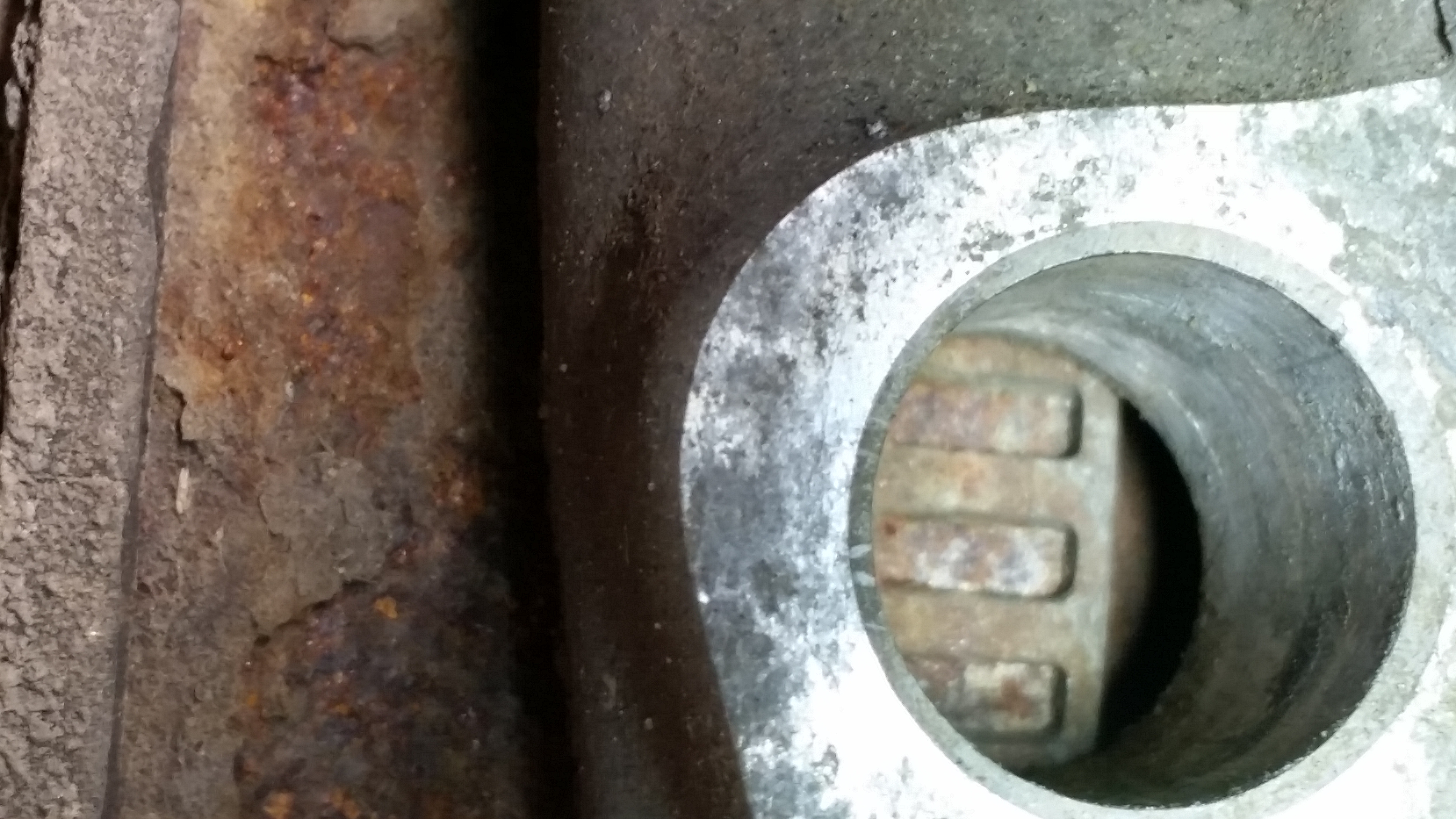

audi_driver79 wrote:My fault is still persisting and my speed sensors luckily came out easily. I really do think it's the ABS unit now on mine.
How did you get them out after removing the bolt? Was it vice grips and pull and twist or another method?

On a similar sensor, I used a wood chisel to tap in between the sensor and the carrier. Going all around it. Soak it in gasgas before hand.

No I just used the allen key and they slid out. I have heard they are a pain but in my 5 years of ownership I have never touched them but they slid out like a greased hooker at an arm wrestling contest. :biggrin3:

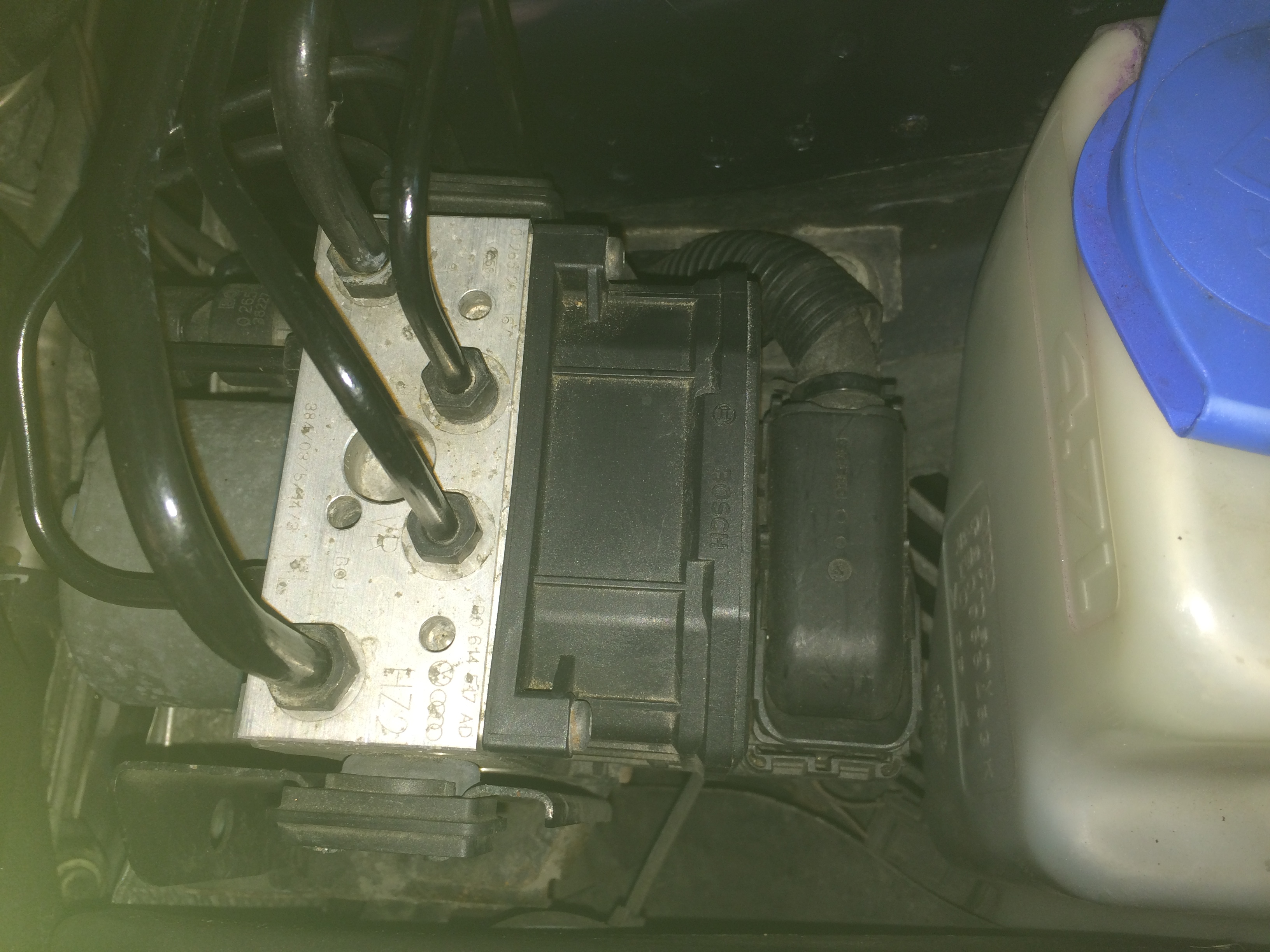

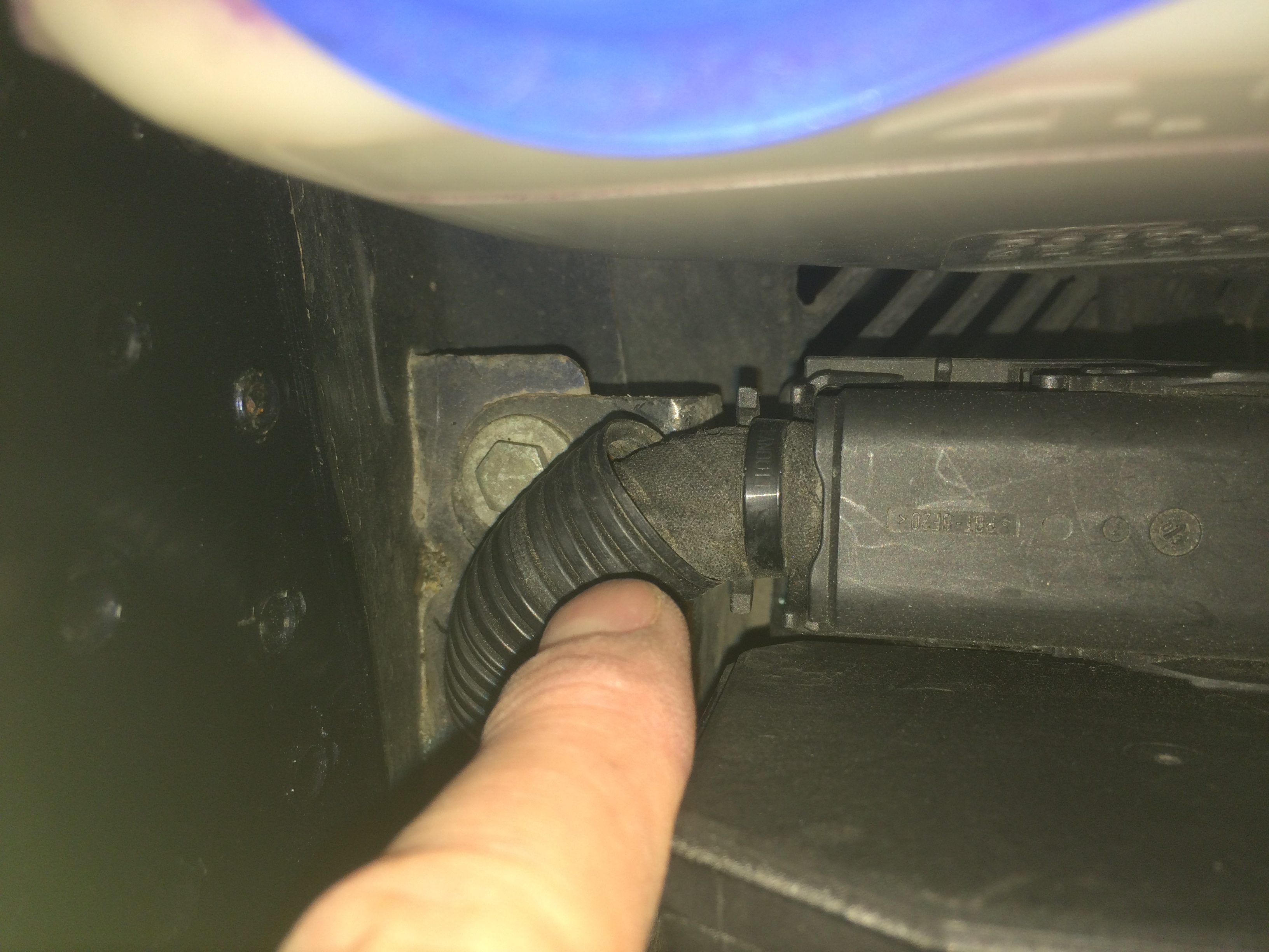

So today I had some time to look at this again.
Fault is still intermitent but seems to be able to be triggered by moving the bunch of wires going to the connector in the following photos.
Any ideas whether this means it's the wiring rather than the unit?
Also is there any point changing the wheel sensor that is showing as a fault if the wiring at this end seems to be involved?
Lastly if all else fails are MRC likely to be experienced in this kind of issue?
