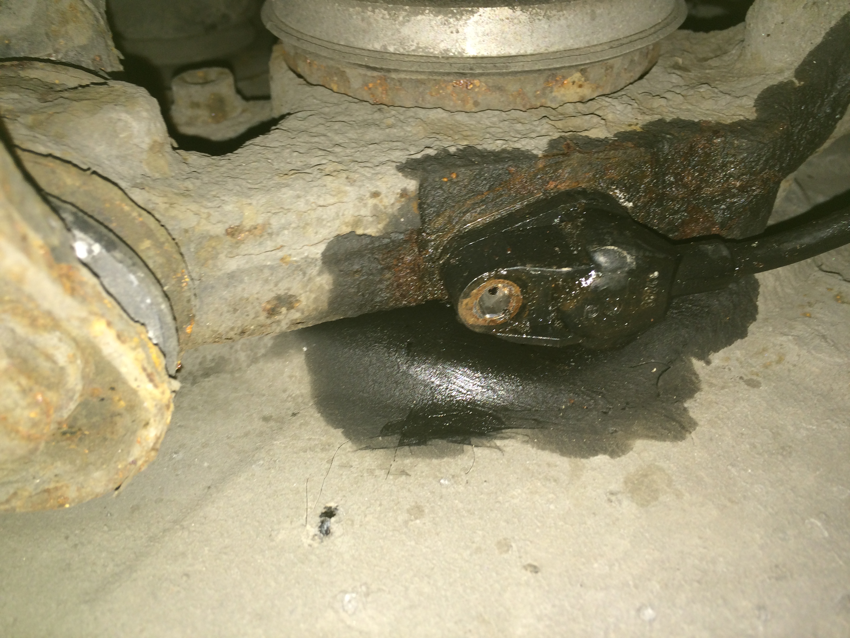

So I assume this is it . Removed the bolt but doesn't seem to want to come off. Is this a brute force to encourage it or am I missing something?

It appears to be a biatch to persuade out judging by the Passat forums, but I haven't done it myself.

So no success getting the sensor out. Online vids suggest that removal by trashing the sensor is favourite . I didn't want to do this as it has only happened twice.
Circumstances are that I had to pretty much emergency stop ( on the way to its MOT)and the lights came on at that time. Switched off and they went away then no problem for a few drives until I was in stationary traffic for a while holding the car on the foot brake and whilst stationary they came on again. Once I was moving again and could stop I did and again switched off and cured.
After trying yesterday to remove the sensor involving a lot of tapping etc a lot of crud came out of the disc so I'm kinda hoping ( yeah I know 'dreamer') that perhaps it was contaminated ?
Went out today lots of different driving lots of bumpy roads lots of braking, no sign of any fault......................?
