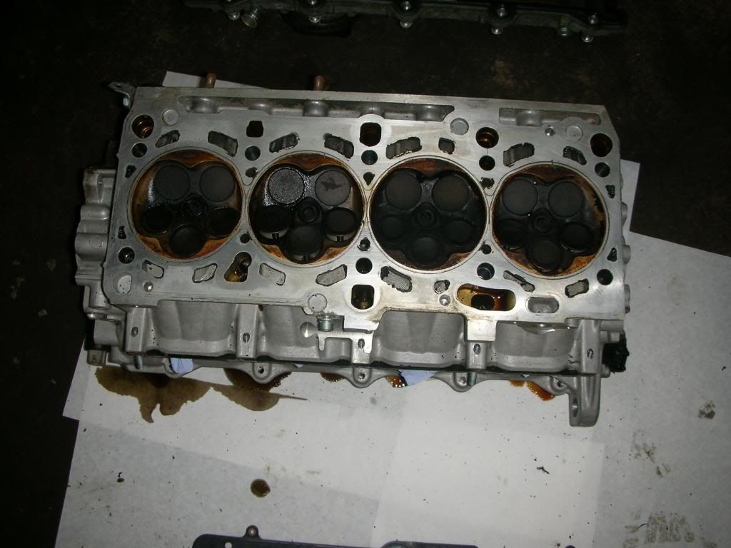

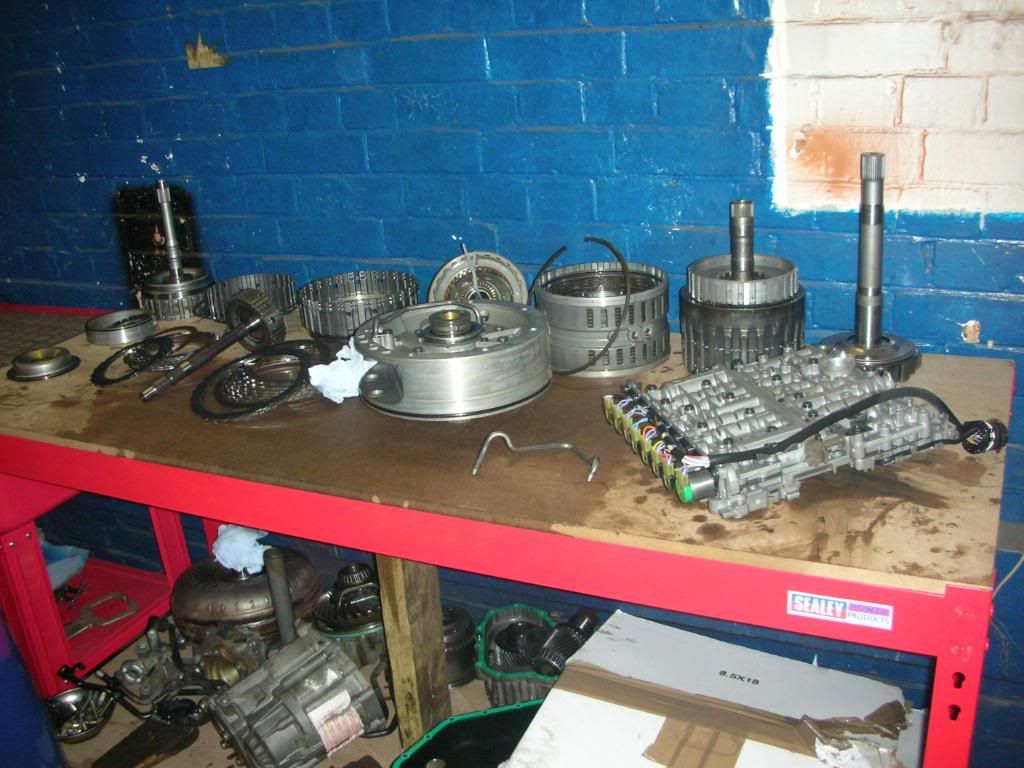

As promised some pics of head gasket & gearbox rebuild , still waiting for torque converter & forward drive drum this part is very common & is on back order .

Why you having the head gasket changed ????

blowing coolant out of expansion tank & 500ppm HC in coolant whilst running.

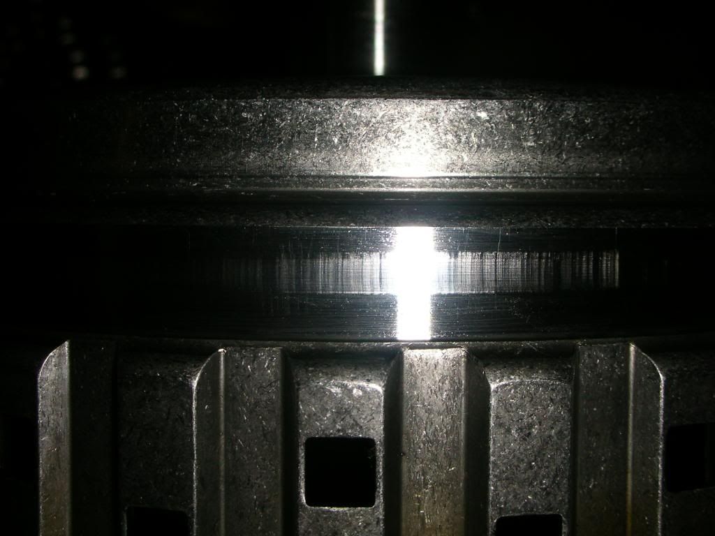

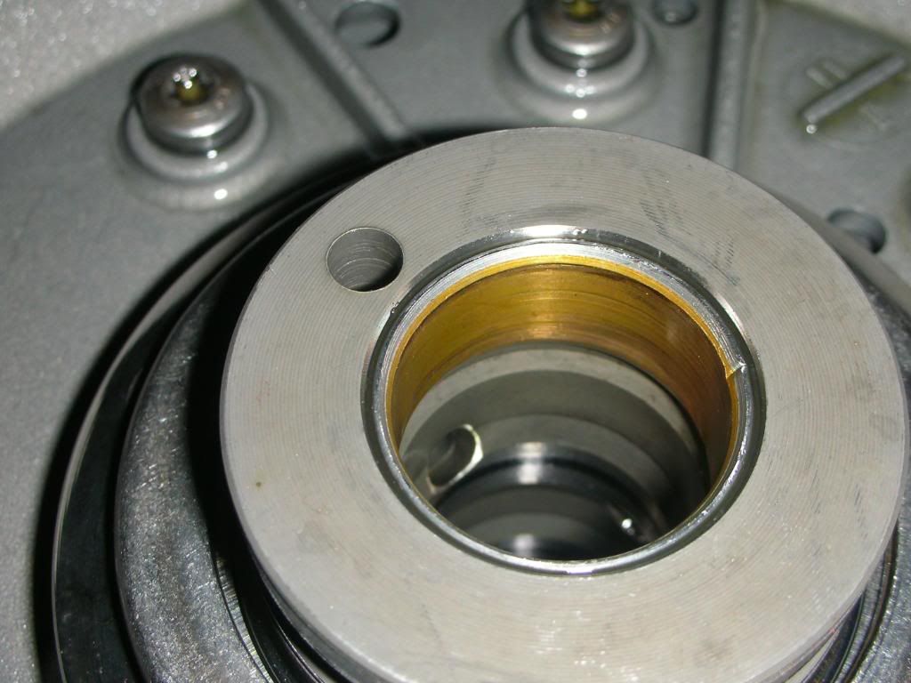

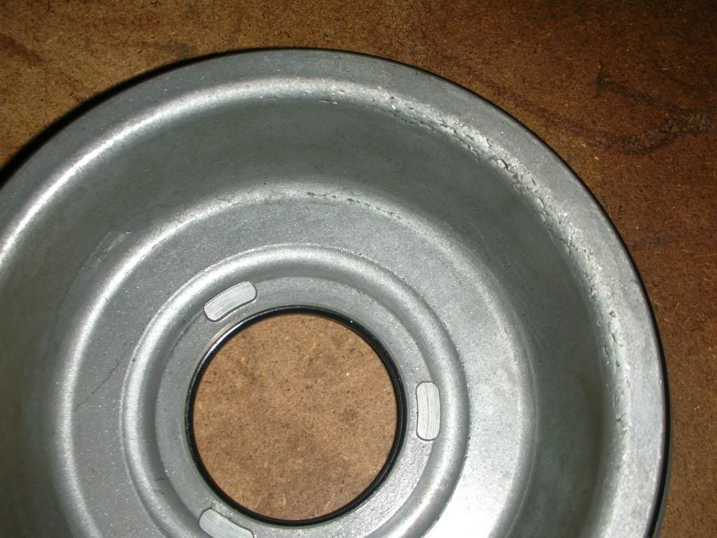

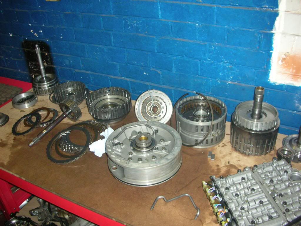

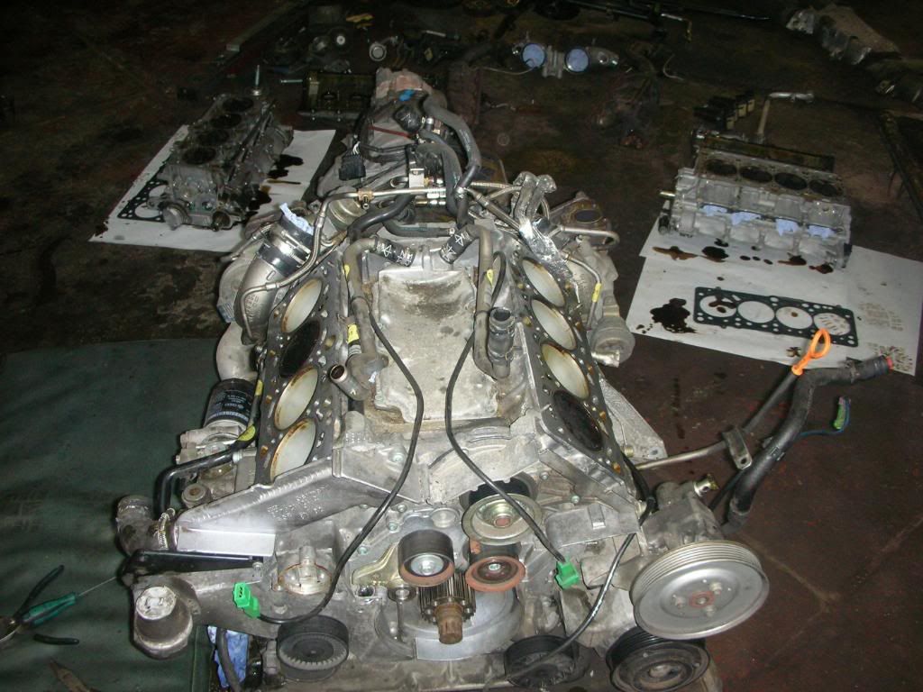

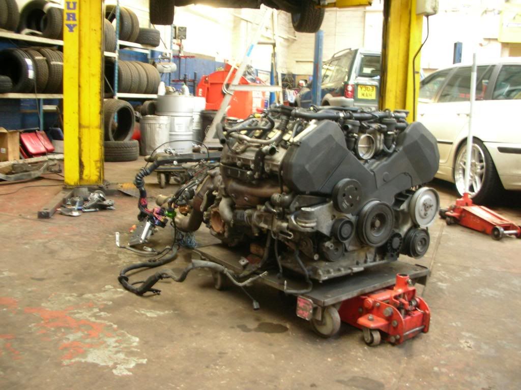

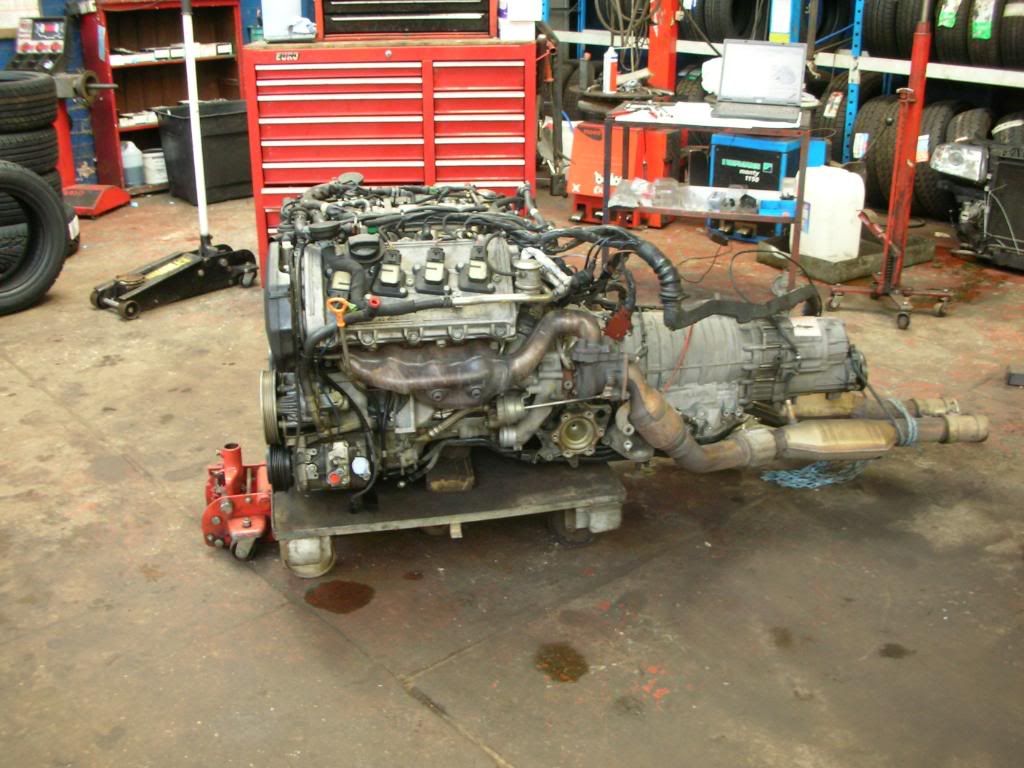

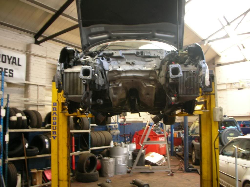

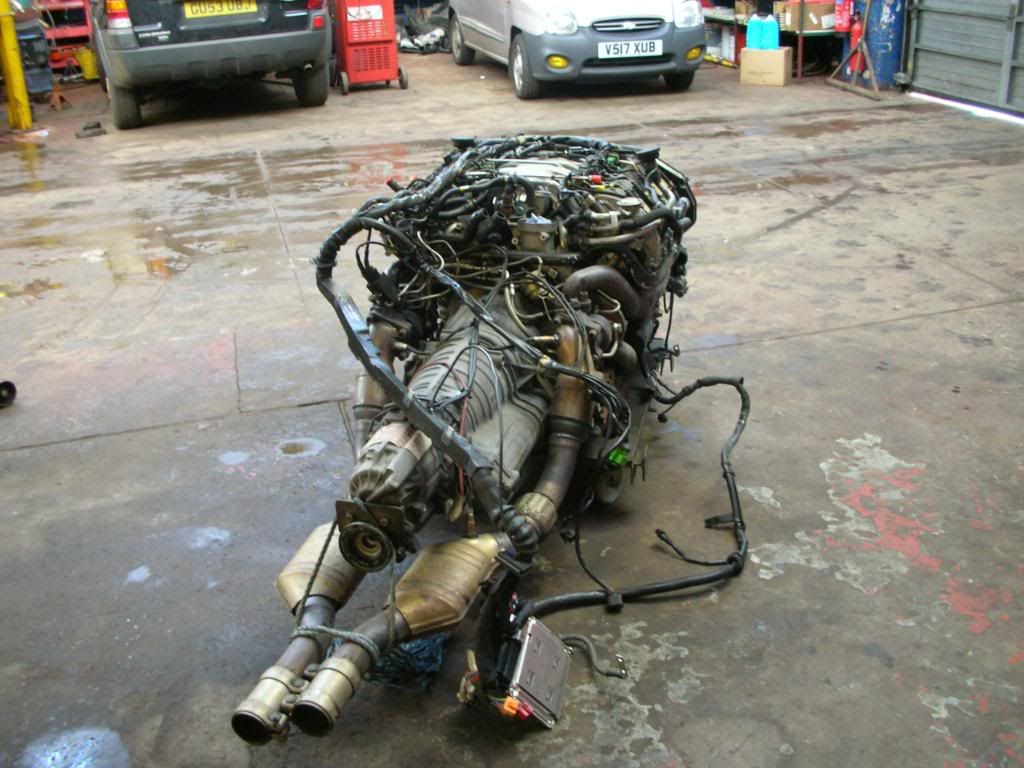

it turns out my car has allready head a new bottom end before i bought it,probably not done very well ,ive had it from 30k now done 60, anyway heres my pics,sorry about quality always too rushed to do proper photos
see the marks on the forward drum where fluid has been passing that pressure loss cold be the slight slipping i have & the pitting on the forward drum piston , also the converter is being rebuilt ie new lock up clutch , the forward clutch drum is on back order so its a question of waitingImageImageImageImageImageImageImageImageImageImageImageImageImageImage

Post by rob8457 » Mon Feb 01, 2010 8:33 pm
foooook hope he knows where every thing goes, great pics.

Post by estrop77 » Mon Feb 01, 2010 9:28 pm
OMG I wouldn;t like to put all that back. good luck with it though. Who's doing the work????

Post by kbee » Mon Feb 01, 2010 10:24 pm
im doing it myself,i own an independent garage in norfolk,with 5 fitters & other staff i dont get much time to play with my own toy, have to work on mondeos & vectras instead!its been stuck on that ramp for 2 months now,desperate to get it back as soon as the last g/box parts arrive,will post results as soon as its done.
