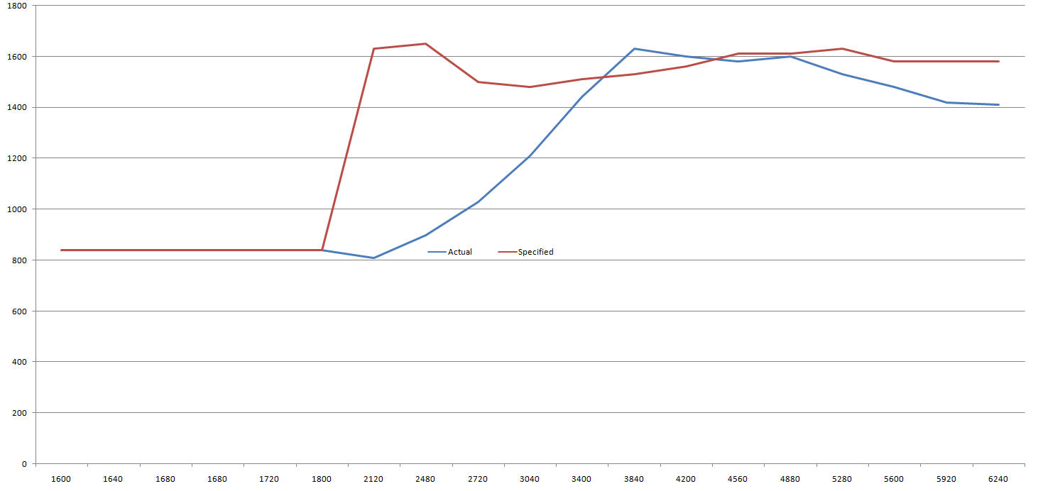

below 3400RPM it makes up to half the boost less than is should. Anyone with a healthy RS6 VAG log that we could compare to? I might just be a little too pedantic :p
RE: Highway pull VAG Log
I don't see that from your data. Here is a graph from your log:
The actual boost is following the specified nicely.
Here is one from my car that I posted a while ago:
I'm not sure how intuitive the boost pressure to RPM graph is, but I see what you mean. Looking more closely at your data, it's taking slightly over 2 seconds to get the boost to specified level in the graph above.
This feels too long. Looking at my data again, it looks like I'm taking about 0.5s to get to specified boost. Have a look and see what you think. I might be missing something.

Thanks man, as you say mine is much closer than before, the delay compared to yours as you say looks like about a second or so later it only strats boosting. on a 4.5sec 0-->100 car 1 second is massive.
Small other noteworthy comparrison
you go from 1960RPM to 6480RPM full tilt in 5.15secs
I go from 1960RPM to 6160 300 less full tilt in 6.1secs
Might be due to altitude etc. but i'm still betting on a boost leak possibly
