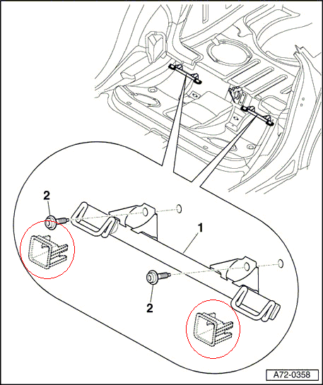

Sounds like a load of cobblers. If its the same as the RS4 then there are threads into the chassis for adding this, and its a half hour job.

Sounds like the stealer is ripping you off ! If you can take the bakc seats off you should see a pair of holes where the isofix brackets bolt onto. I had mine done by a dealer .... think was about £130 all in with parts. Fitting is a 15 min job.

Dunno why. According to VAGCAT diagram below, the holes are in the chassis.
Do a search on here for ISOFIX and you'll see a few ppl have had it retrofitted at relatively low cost by the dealer, parts alone will cost ~£80
ISOFIX installation instructions

Docklands are having a laugh , I've fitted Isofix to my sisters A6 with leather ,which is the same floor pan as RS6. They bolt in and the bar plus bolts is about £28 a side for the rear. You can fit these yourself or better still ring me at Camberley Audi. Recommend Isofix for all child seats as there is 0% movement when fitted correctly unlike belt fitted child seats .
