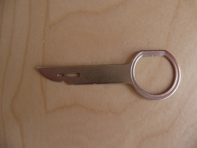

also can someone tell me if these keys are the correct ones for removing the RNS-E
Virdee Autos
Trader (Expired)
Posts: 2546
RE: Re: RNS-E issue
Post by Virdee Autos » Wed Apr 22, 2009 6:06 pm
Yep they look good enough to me!
They will only fit one way though.
