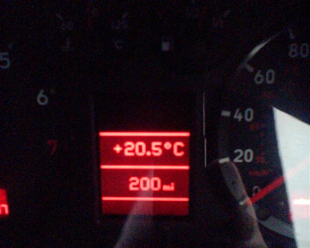

Anyway, got it going but now have a problem with the top section of the DIS in that nothing displays there (CD track listing for phatbox or road name if using the navigation system), but when I turn ignition on, I get the amber 'OK', so I know the display works.

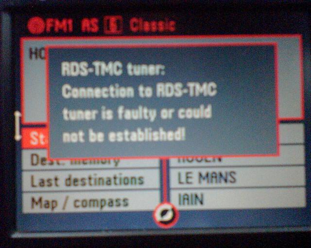

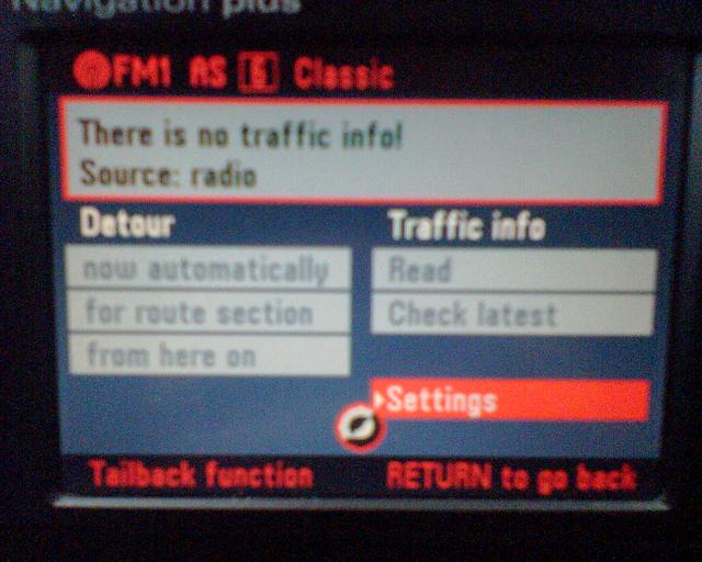

The navigation system works fine, except TMC. I get this message when I turn the radio on:
'RDS-TMC Tuner: Connection to RDS-TMC Tuner is faulty or could not be established'

Well it's definitely something to do with your TMC/CAN gateway. Try checking the configuration with VAG-COM.

TMC/CAN is indeed a dual function device. It receives the traffic signals and it also converts the serial bus of the SatNav+ to the format that the DIS understands.
I have never got as response from my CAN gateway with VAG-COM, yet mine works so I don't think it is that.
Unfortunately the only circuit schematics I have are from my Bentley CD which only covers US cars and they never got SatNav+. I'm sure the TMC is fused, however it will likely share one so if the fuse had gone I'd guess you'd see other equipment out too. If yours is a factory fit, the TMC is mounted on a bracket just to the left and below the steering wheen column. If you remove the knee bolster (4 screws two behind the fuse panel) you can get to it. Check the wiring because the fault code -
01311 - Information Data Bus
37-10 - Faulty - Intermittent
- suggests maybe a problem there.
If the unit is gone then you can try a replacement, but you'd need the right variant. They are bound to be expensive new and maybe hard to find (even on www.ebay.de). I think I got mine for about £50 but was lucky as they used to got for twice that. And what if you got one and it still didn't solve the problem?
Im in a similar position to you. My multifunction steering wheel controls are intermittent. I have tried to get a replacement on e-bay but I can't find the right variant. A new one will cost me about £150. But I don't KNOW that it is at fault. It could be the control module in the steering wheel or the SatNav+ head itself. Unfortunately I can't afford to fault-find as I seem to have another problem (probably the instrument cluster) which drains the battery after only an hour or so. So I have no choice but to pass the problem over to my Audi dealer.
In your case all I can suggest is to fault-find the wiring. If the unit is powered then really you'd need a scope to see if there are signals coming from the SatNav+ head but not getting to the other side of the TMC.

is this not a code refering to the boot mounted cd changer based system and not the nav-plus system?01300 - Control Module for Navigation with CD-Rom (J401)
