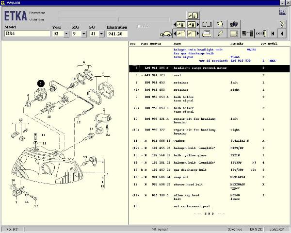

MarkB
Posts: 5695
Post by MarkB » Wed Sep 27, 2006 1:09 pm
I found this...
Range control
Range control.jpg (54.77 KiB) Viewed 536 times
Mark
MarkB
Posts: 5695
Post by MarkB » Wed Sep 27, 2006 1:10 pm
It's for an RS4 but just did it so quickest way to find a xenon installation. I can email you the full size .jpg if you like...
Mark
