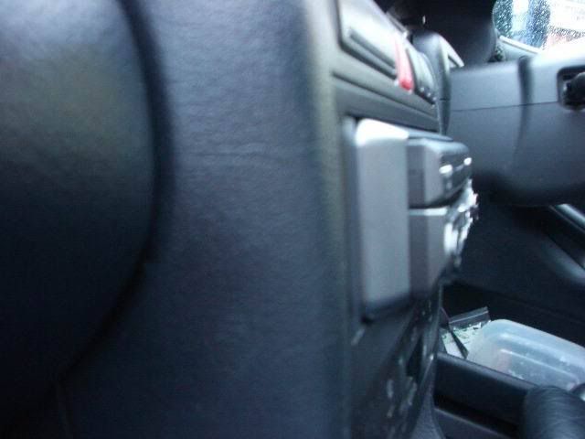

Which facia did you buy? I'm looking to get the FP-05-05 from here http://www.nexxia.co.uk/Car_Stereo_fitt ... udi/A4.htm
Thinking about it I'm going to go for the PC9-410 which uses the RCA's. At the moment your pioneer must be amping the signal and then the adaptor must be removing the amplification level and then the bose is amplifying it, maybe a reason for hiss? However this is exactly what the adaptor was made for so should be ok.
I'm not too far from you so maybe we can compare once i've got it all in, or if you wanna listen before I put it in.
How comes the unit sticks out an inch?

the facia i got was just the end caps, the one you say about FP-05-05 looks like it would set my headunit back a bit, which would look better, but there aint much cable room behind the pioneer!
think it sticks out so far as its that bit bigger than a normal unit.
