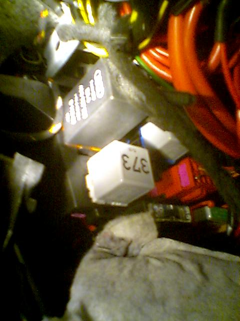

Solved.
Thanks to ShineyDave, and I mean a big thanks, this mystery is now solved.
Dave has spent hours of his time scouring wiring diagrams with me and finally resorted to pulling his car apart to get to the final conclusion.
My red door open or door warning lamps were also not working.
The problem was entirly the +ve feed as applying +ve feed from elsewhere fired all the lights into action.
We figured the time delay feature on the interior lights cuts the ground, while the footwell/red door lights time out by cutting +ve.
Anyway. The relay no. 382 mentioned earlier in this thread is the one I required. However, it's not the one shown in the pic (a few posts above) of my relay box. There is another relay panel behind this one. I had over looked this panel as mine is entirly empty (was) - apart from the contacts that the missing relay should have been in. It was position one, just as the diagrams and my Audi parts man had said.
The pic below is of Dave's car. It's the black relay above the one marked 373. Remember my relay board is empty, or it was.
Anyway, it turned out to be as simple as that. Now I have the red door lamps working and the foot well lights, I think it was really wortwhile doing, not to mention the satisfaction of resolving something that was bugging me.
I personally think that relay was missing from factory - I think all S4s were meant to have this feature and with what looks like an unmolested, example............but I will never know.
Thanks again Dave. Hope this helps someone else.
