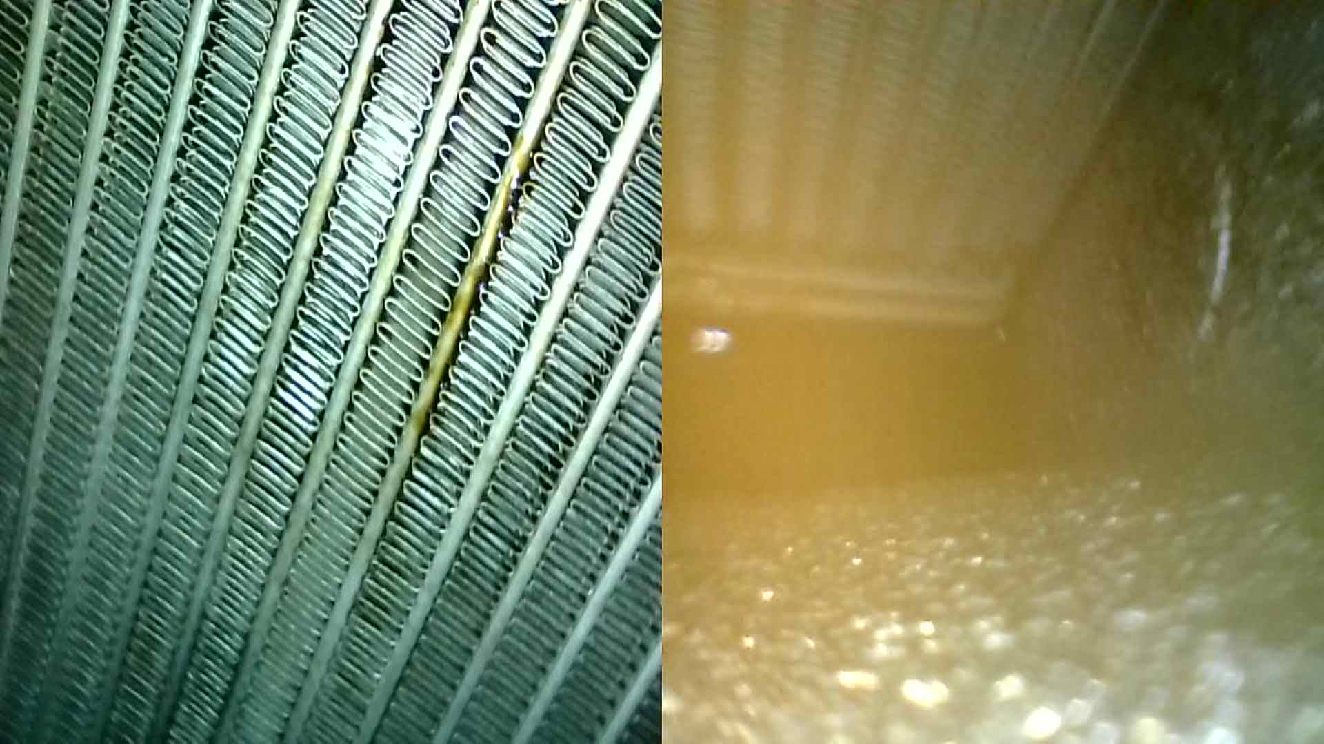

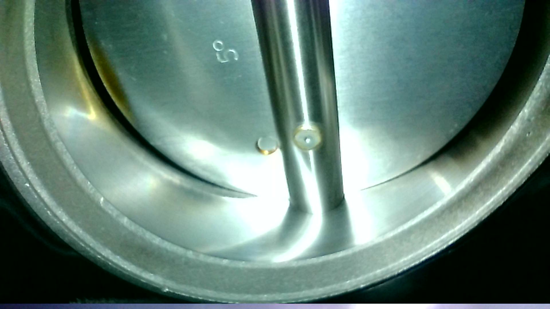

While diagnosing another fault I noticed that I had lost about 350ml of coolant. Roughly 200ml below Min.
There are no visible external leaks to be seen any where.
I decided to check the intake system after seeing a YouTube video on an RS with a leaky charge cooler and voila! I have a small weap of coolant into the charge cooler that I found by removing the return air pipe from the charge cooler to the throttle body and looking at the side and bottom of the heat exchanger element. There is a small weap of water from the elemet and a pool of coolant at the bottom of the charge cooler. There are also signs of small amounts of coolant on the inside of the charge pipe and throttle body butterfly.
It looks like I've caught it early and will be replacing it ££££

I've attached a few pic's inside my intake system, one shows a drop of liquid on the butterfly of the throttle body. Then a splt screen of the side of the charge cooler core with liquid running down it (LHS) and you can just make out the reflection of a small puddle at the bottom of the charge cooler case on the RHS. I also found some on the sides of the two delivery pipes into the inlet manifolds.
I'm looking to see if the water matrix can be replaced as a new OEM unit is £1200, an uprated after market one is £2000 and a full after market charge cooler & its radiator is £3000 (Stage3)
I figure if I can refactor it for maybe £400 it could be forth running a part exchange scheme.
Apparently the main problem is getting the air side to seal correctly after you have had it apart as it's running at upto 2 bar depending on your tune if you have one.
