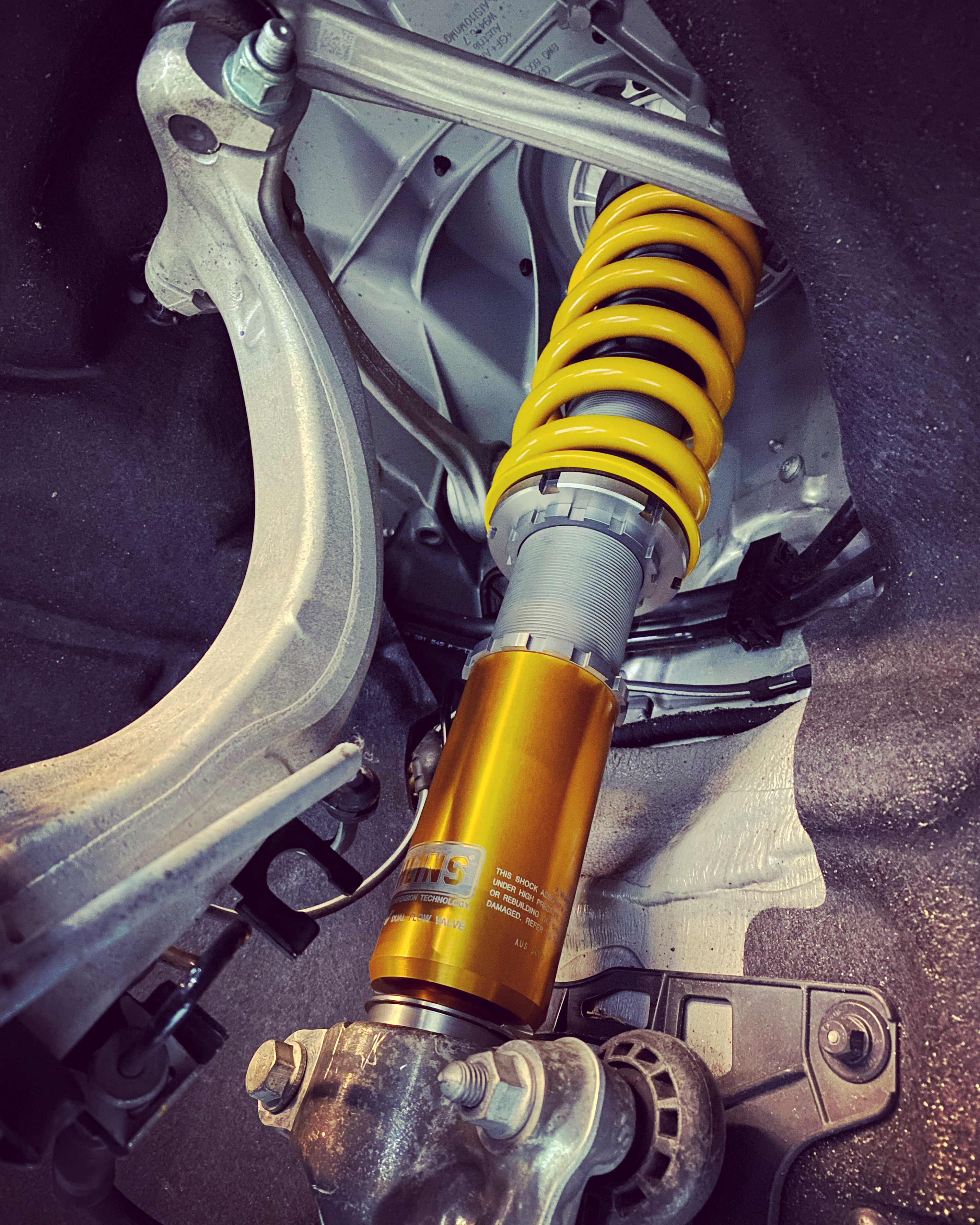

So I bit the bullet and opted for Ohlins Road & Track instead of KW V3 that I usually used on all my previous cars. I ended up using 100N/mm springs in front and 120N/mm springs in the rear, and i must say that the car is just as comfortable as stock but a lot more compliant over rough roads. On the stock suspension the car can be a bit of a handful when driven hard on less than the best roads, but know I laugh at uneven roads.
Some pics for you.

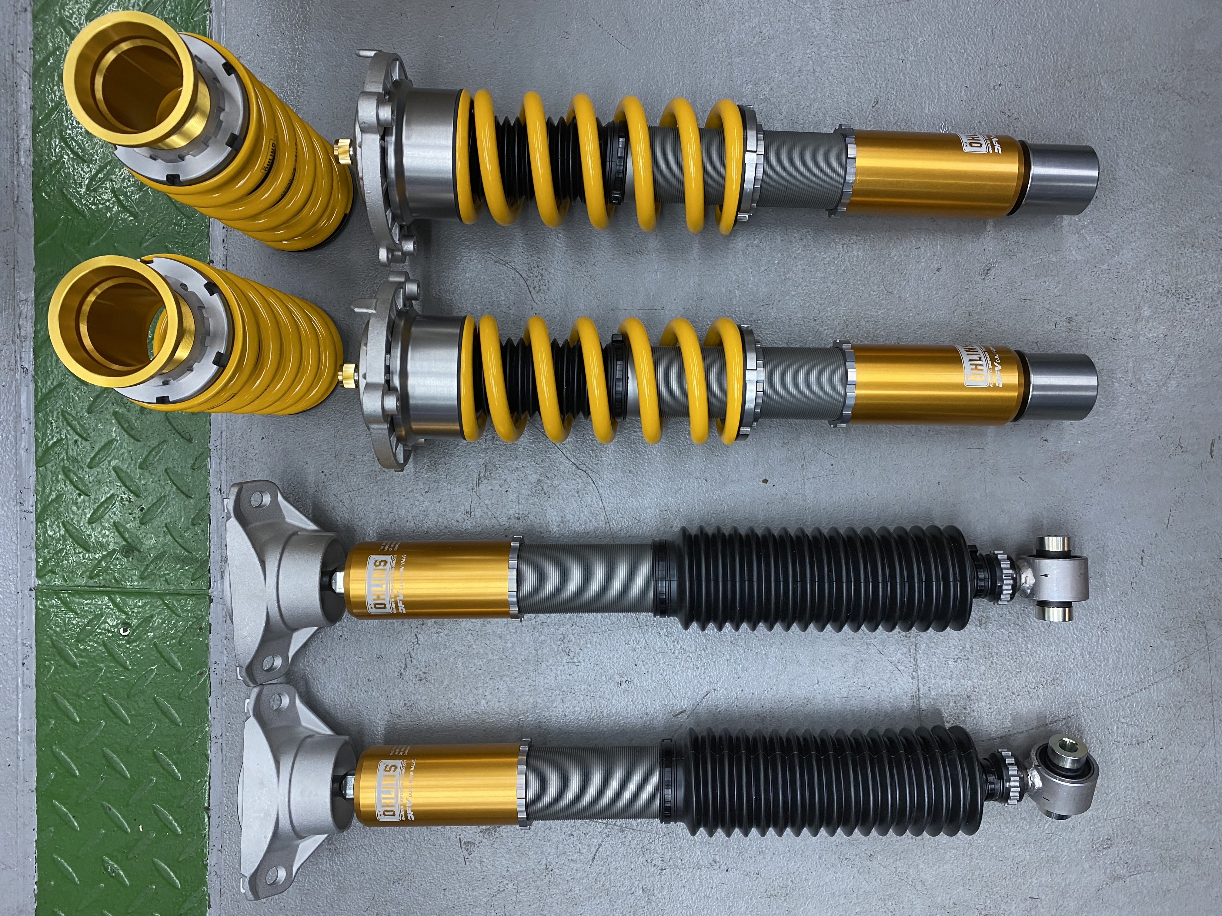

Post by initiala4 » Sat Jul 03, 2021 8:35 am
Here is how the kit looks like ->
I retained my stock height, and had the car corner weight balance as well.

Post by Avantgarde » Sat Jul 03, 2021 10:51 am
Did you run their recommended 120N front and 140N rear springs?
