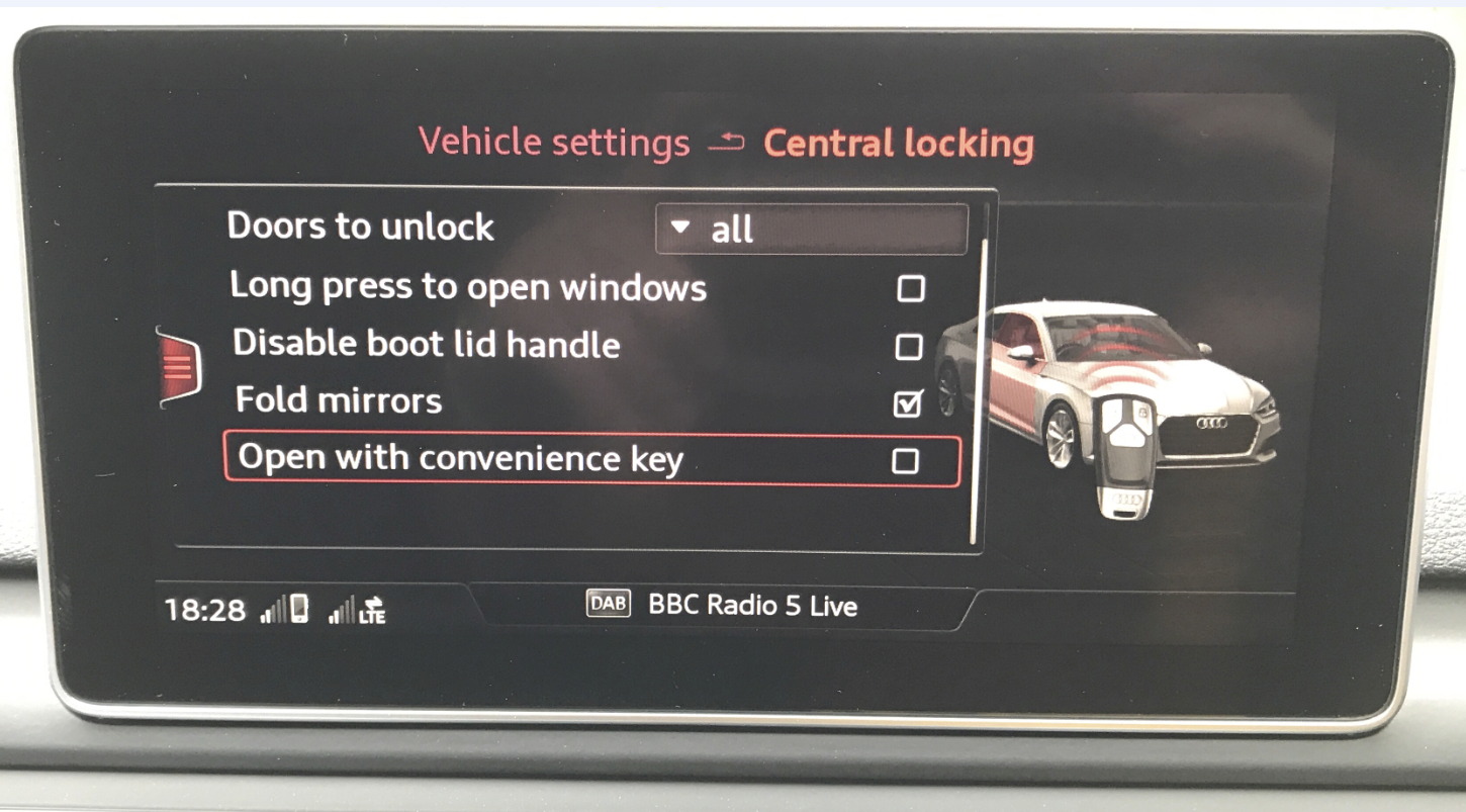

Not posted for a loooong time but I have been lurking....
This thread has been very interesting to me as I tend to worry.
I initially bought a Faraday Key Pouch but getting the key in and out (and remembering to do so) is a real pia. I'm just lazy - and forgetful.
Biggest worry was not so much when the car is parked at home, but leaving the car on a Restaurant Car Park and have some t**t relay it from there while I'm inside.
So I've have had the Open With Convenience Key option un-ticked for most of the 2 months I've had the car and this makes me 'feel' a little better.
The only pain now is having to press the unlock button on the key. It's like being back in the 00's......

At the moment, there are only 2 choices 1) open the door with the keyless entry or 2) disable it and use the remote button.
The fact is the current implementation can be relayed with kit costing £15 as demonstrated at the white hat security conference in 2017 by Qihoo.
In their report, Qihoo describe how the technology can be made more secure but Audi use off the shelf chips that cost pennies (as do other car manufacturers) so the system is likely to stay relatively insecure.
I expect at some point, the Thatcham security test will include relay attacks on the keyless entry, and when that happens, all the manufacturers will make their systems more secure but until then, sadly just the 2 choices.

You do realise you have only turned the “unlock” feature off. You can still “lock” the car via touching any of the touch pads on the handles.

Correct. Only on opening the car you need to press the button on the keyfob.
Not really a bother for the added security.
