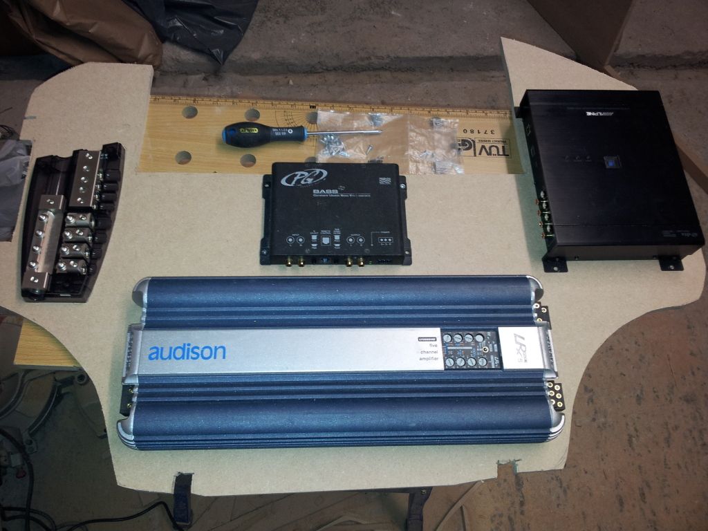

Upper amp rack started

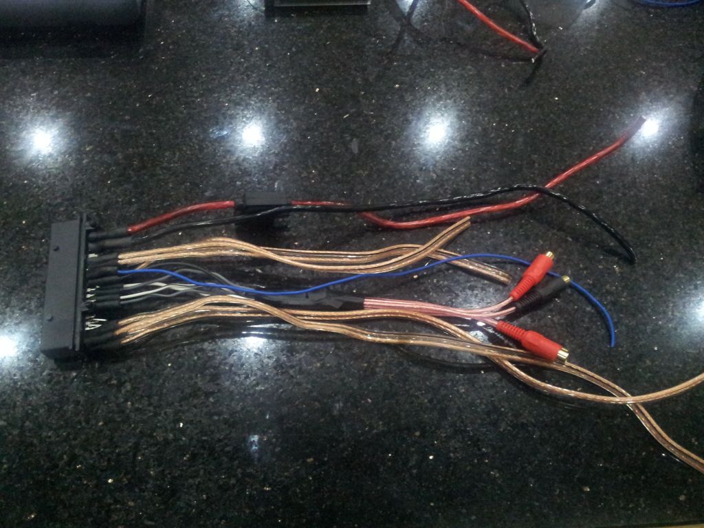

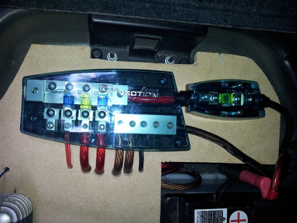

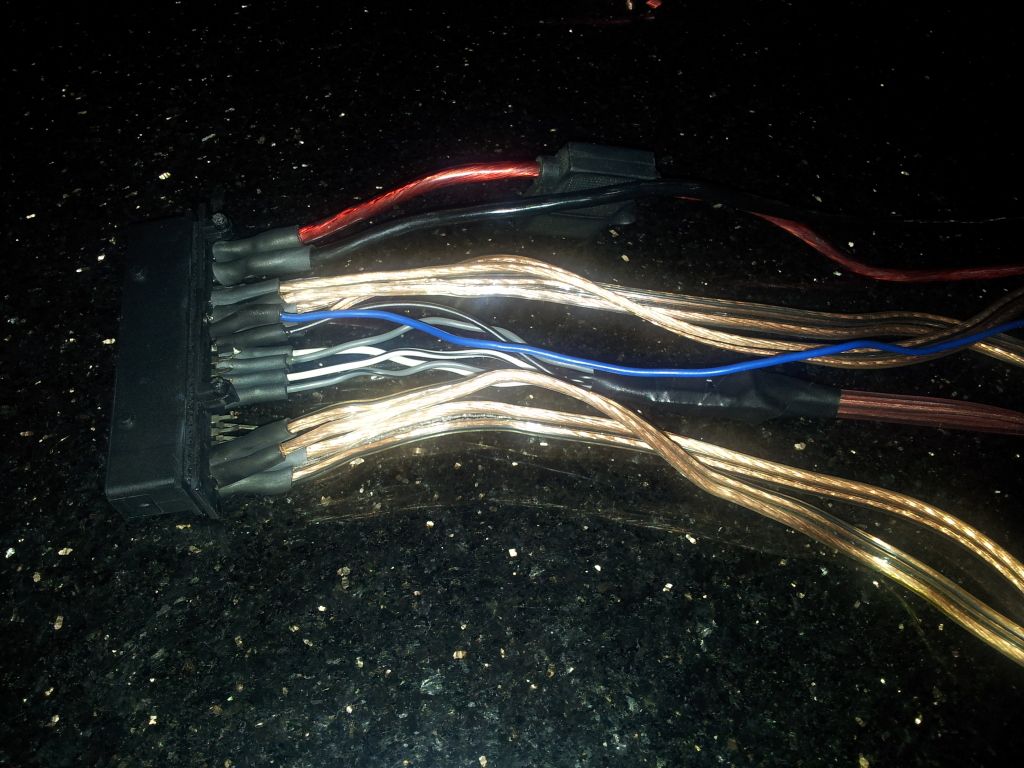

To get the line level signal from the RNS-E I bought another Bose amp and ripped it apart for its terminal block. I used the block to interface with the cars original loom. This mean that I had available to me in the boot a +12v and ground (didn't use these to power the amp as they are too feeble and the battery is right there anyway), but more importantly I had a remote turn on wire to switch the amp on, I had front and rears line level outputs (which I converted to RCAs sockets), and speaker wires running to all speakers. So this was connected to the amp. It also meant that at any point I could just unplug the loom from the butchered terminal block and plug it back into the original Bose amp (which is still there and I'd still have sounds via the Bose and (and focal speakers).
Bastardised Bose terminal block
Notice I added some wires to the +12v and ground (with an inline fuse) just in case I wanted a quick, low current power supply for something later.

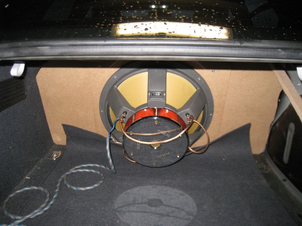

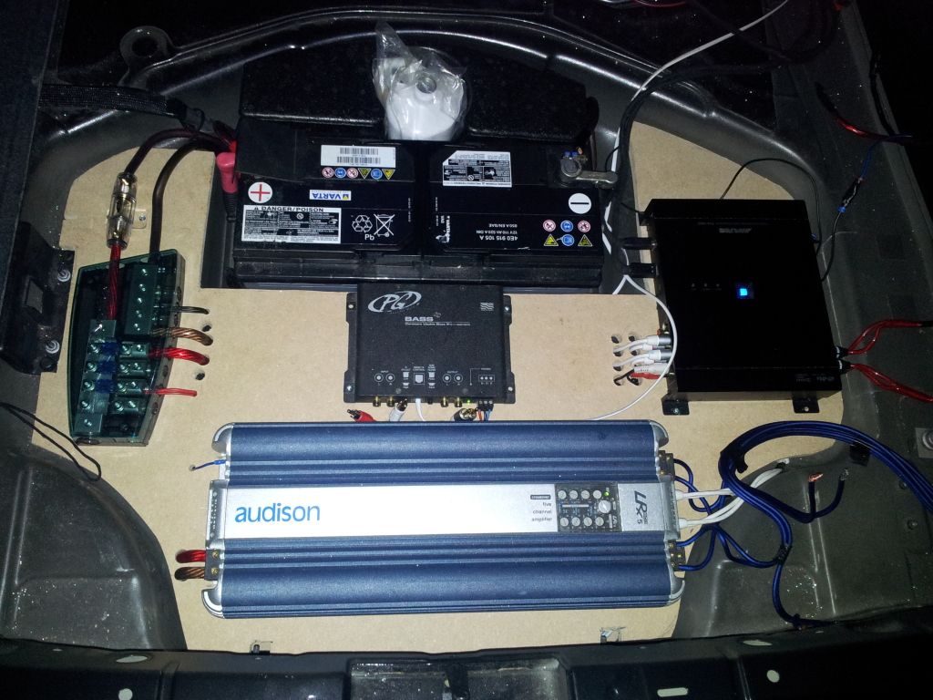

So, I needed some bass! I threw in my old JL Audio 12w7 sub in a box. It was good but had plenty more potential as it was seriously underpowered by the Audison.

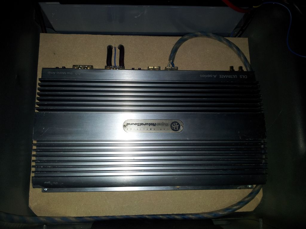

So a DLS A6 amp went in the spare wheel well to power the big sub alone. This lives under the Audison amp, still in the spare wheel well. Massive improvement! Where the sub sounded like it was reaching its limit previously, it was clear now that it was the amp that had reached its limit and was distorting and not the sub.

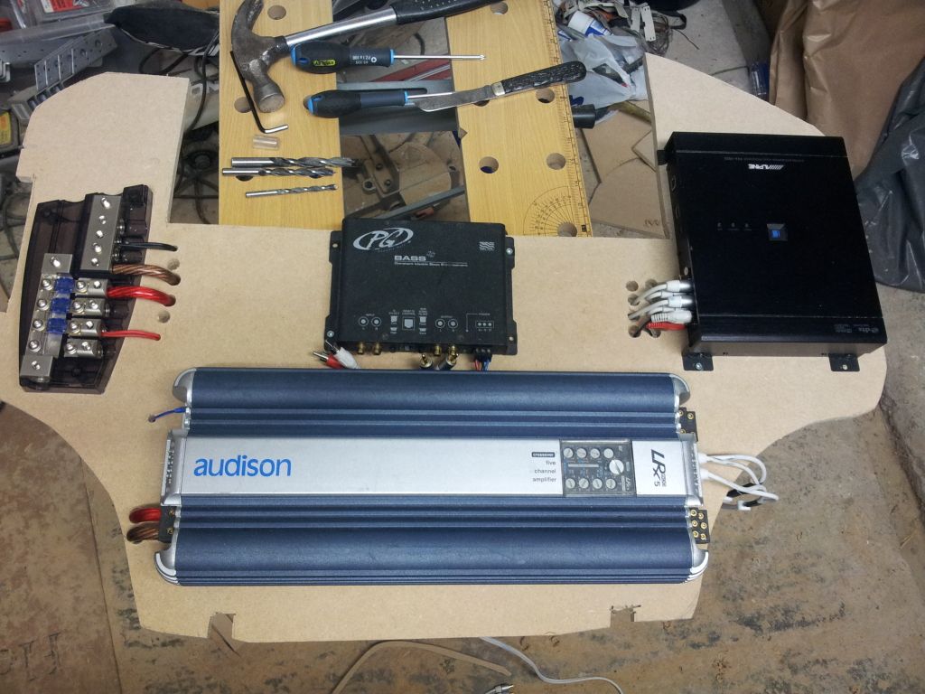

Lower amp rack

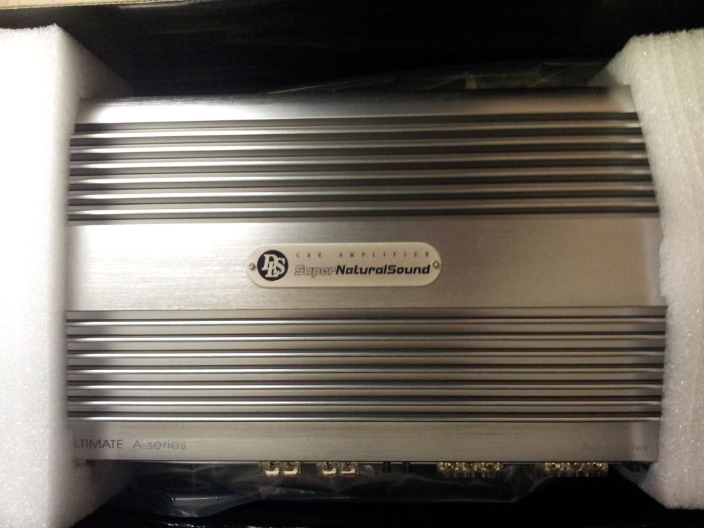

I bought another 3 DLS ultimate amps to power the mids and tweets and get rid of the Audison amp but I haven't figured out where all these are going to go yet.
One of the 3 extra DLS amps awaiting installation:

I struggled to decide whether to fill the boot with the DLS Ultimate series amps or the Mosconi’s. Although the Mosconi’s look the part (more so than the DLS’s) the reviews on them differed quite a lot and it is difficult to compare the 2 side by side so ended up with DLS as there is no-one that has a bad word to say about them, and they are still winning SQ competitions.

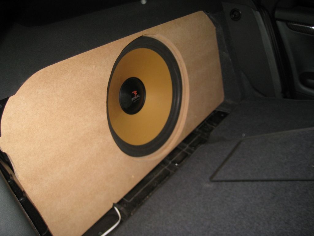

The JL 12w7 ended up coming out as i needed boot space for weekends away with the new born baby (carry cots / prams / sterilising equipment etc plus all the normal luggage for 4 people). So I got a Focal 18" sub and mounted it behind the rear seats as free air. Although this is not a free air sub I thought to myself it would probably need a box not much smaller than the boot anyway. Although nowhere near as tight or controlled as the JL it was better than no sub and actually hits harder when pushed.

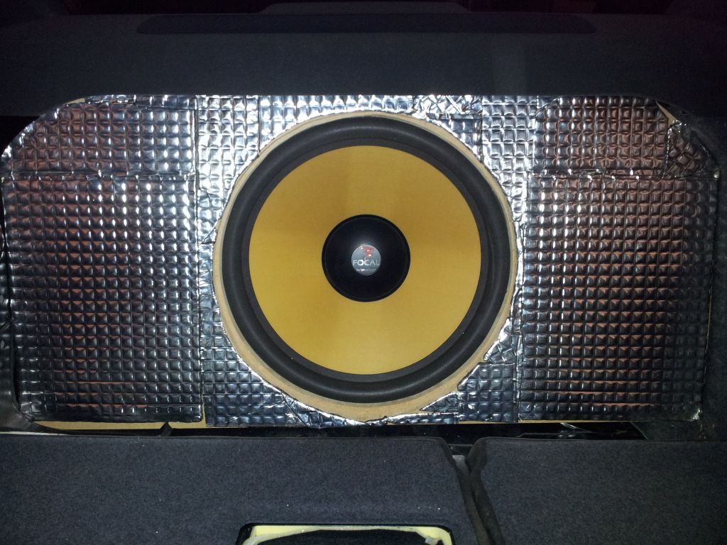

Sub:

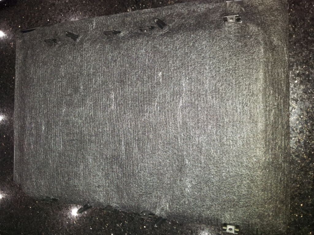

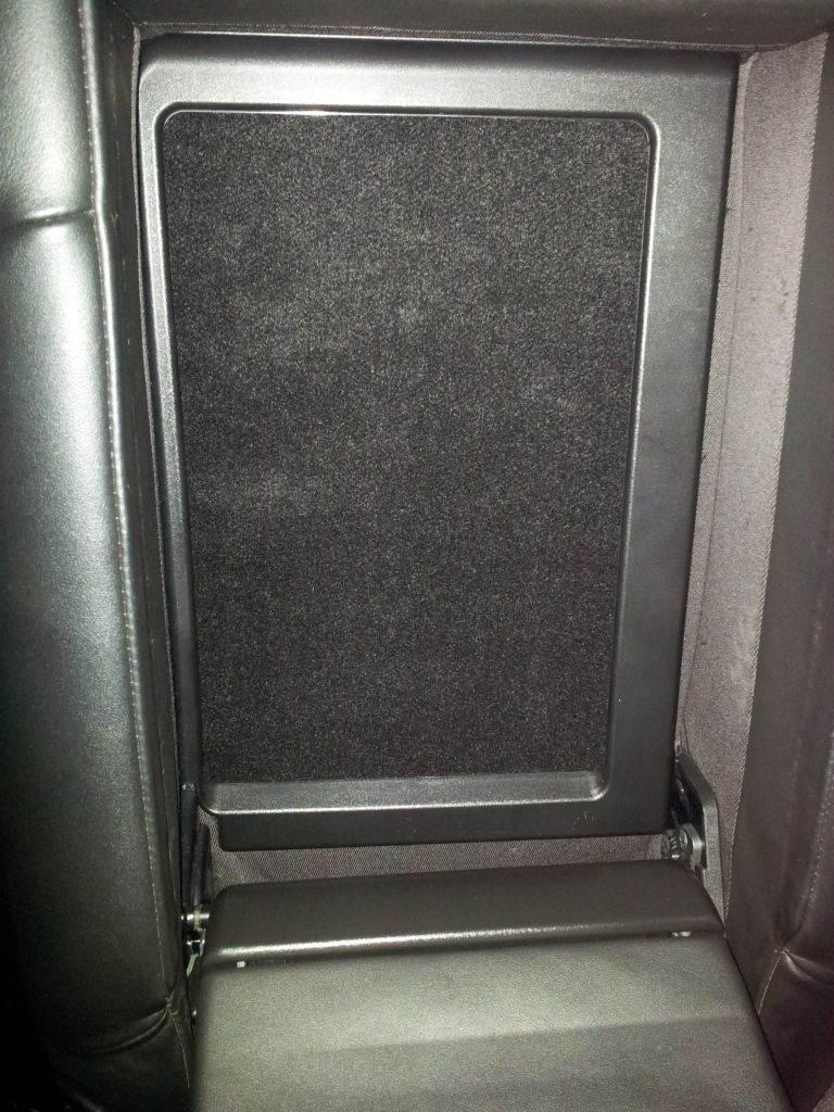

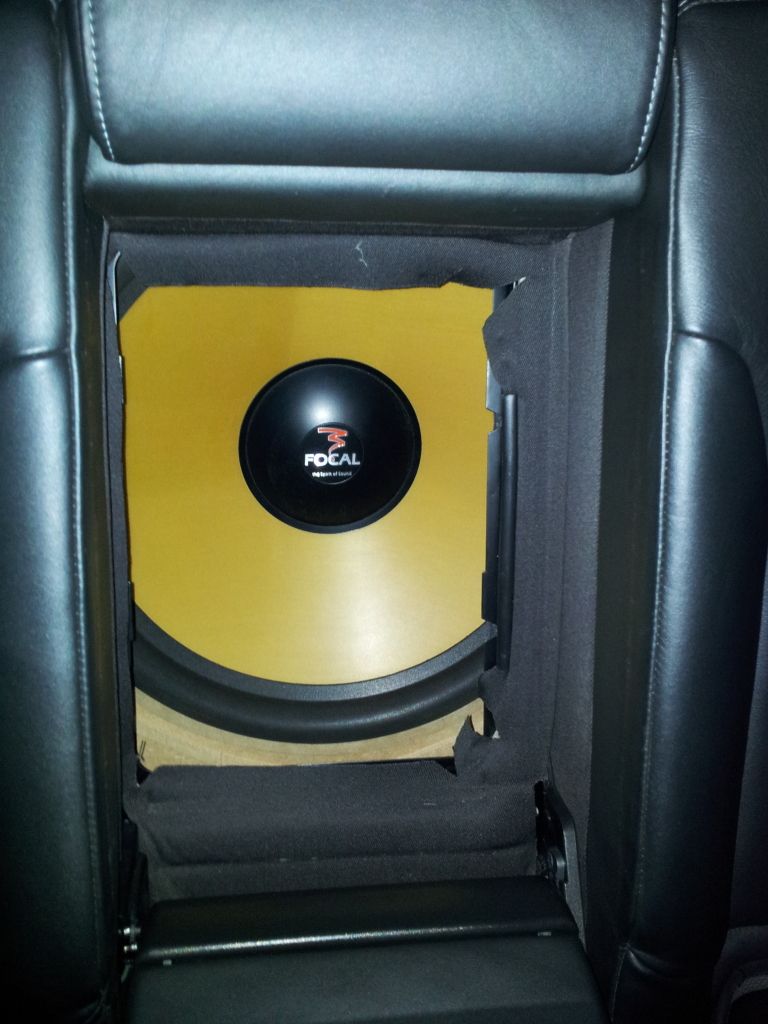

It also made a massive difference when the back seat was dropped so began my next project of removing the ski hatch that lived behind the arm rest. This came out but left an untidy finish and also left the sub visible from certain angles. So I got the frame of the ski hatch and stuck some acoustically transparent material to it; job's a good 'un!
Ski hatch removed
Back of ski hatch frame covered with acoustically transparent cloth
From the front
And fitted

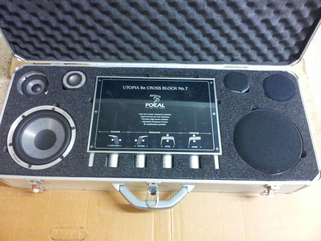

I also bought a set of Utopia 3 way passives, which gives me another set of utopia mid bass (identical to the ones I’ve already got), Utopia mids & utopia Beryllium tweeters. This all comes with the amazing Focal Utopia 3-way Crossblock (passive adjustable crossover). None of these have been fitted yet, but I'm intending on the crossover to live in the back shelf where the stock sub goes and to make it lift up to adjust. See further down for photos of this set.

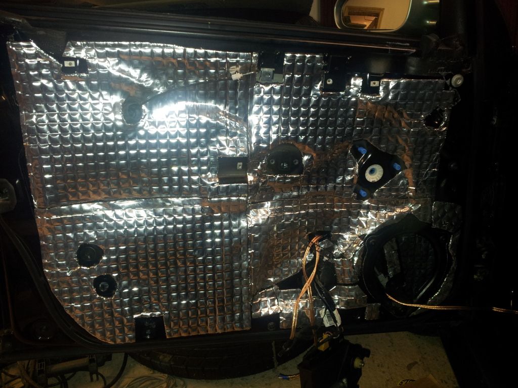

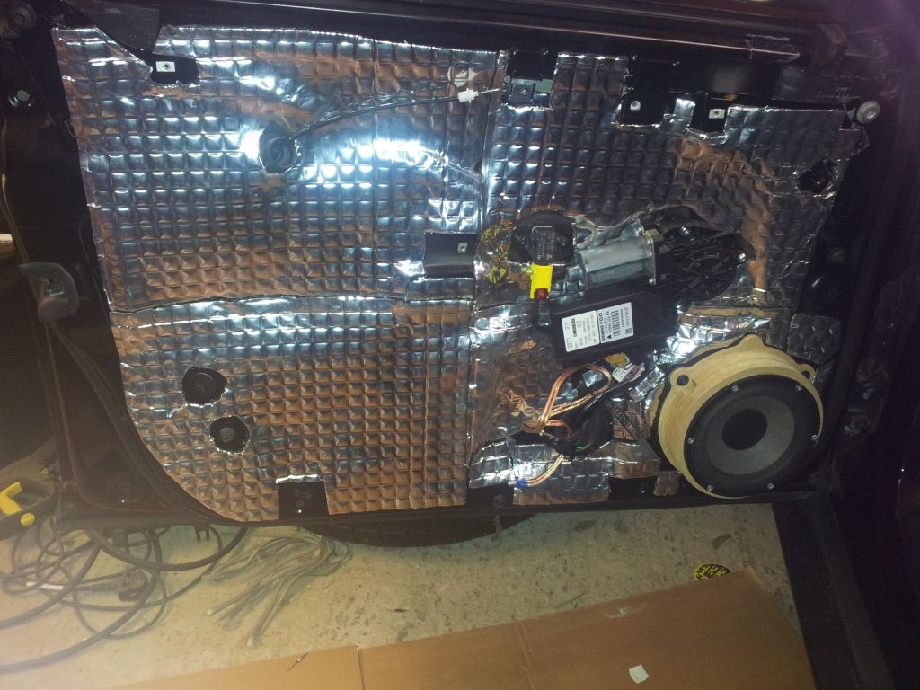

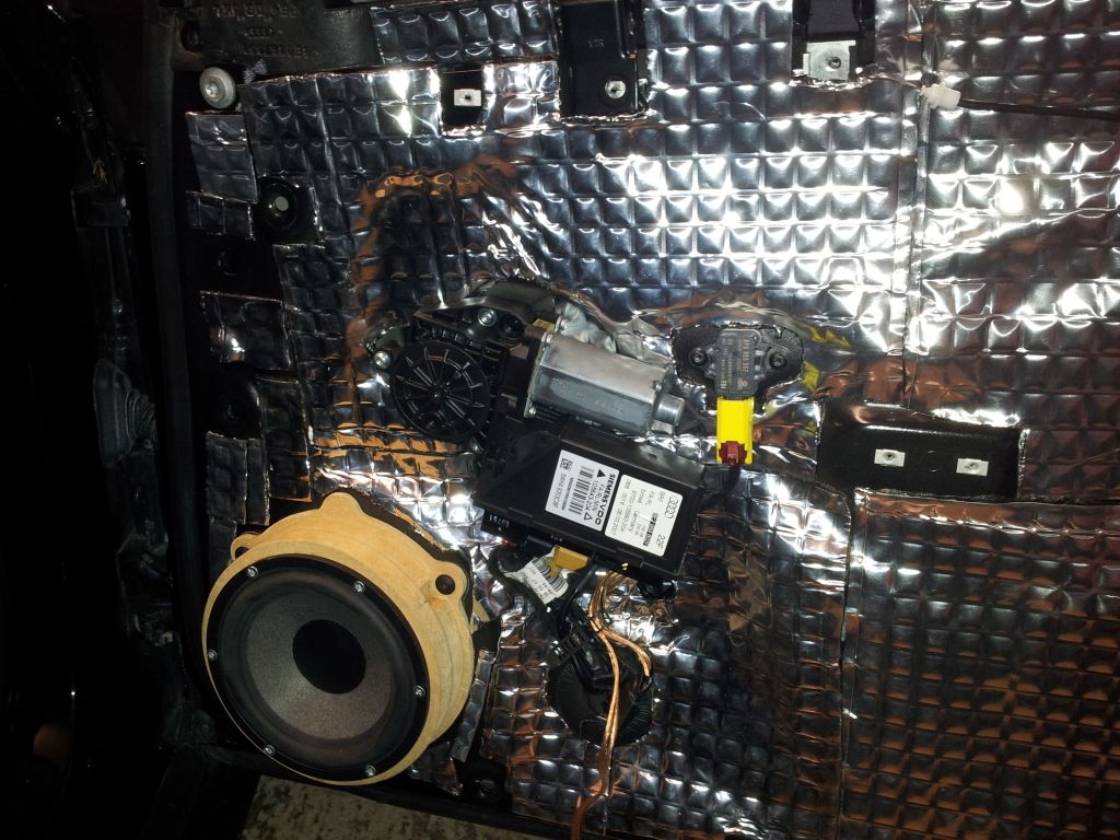

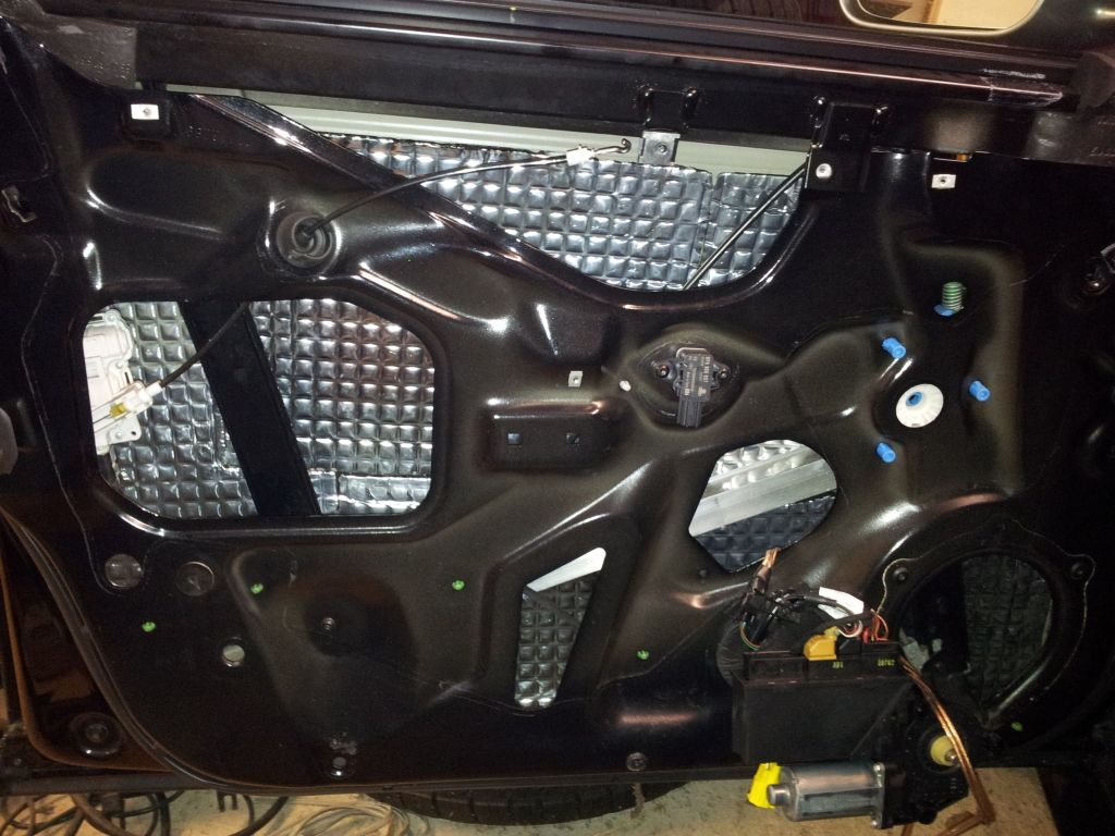

The last thing I did was deaden the front doors, I haven't got round to the boot or back doors yet. Will start again once it warms up a bit. I might actually stick the car in the garage tomorrow night and line the mdf that the sub is mounted on then cover it as I have started driving my truck to work as the wife is complaining about being woken up (and waking the baby) every morning with my exhaust. It means then that I can work on it each night when I get home even if it is dark / wet / cold. At the same time I might screw the sub mount to the car frame as currently it is supported by a bit of wood on one side (and a very tight fit). This means that it annoyingly squeaks as I am driving. I am also getting a little alternator whine but as it can’t be heard at normal listening levels I haven’t got round to fixing it. I think it is coming from some of the over long RCAs on the amp / processor picking up some noise from the power cables as it is all in quite a tight space. I’ve been meaning to get some shorter RCA cables in.
Door before deadening:
Outer skin done
Inner skin nearly done
Passenger door done
Drivers door done

To be honest I didn’t notice a great deal of difference when deadening the front doors. They certainly feel and sound more solid when you tap them from the outside, but as I had my front mid/bass quite light on bass there wasn’t really much to tell. However, the other day I was playing around with the setting and turned the sub and rear doors subs off and turned the crossover down on the fronts and they dropped quite nicely so maybe that is the deadening doing its magic. I now lots of other people who have used this deadening (not Dynamat, its Silent Coat Extra, which is cheaper, works better (so I’m told) and is a lot easier to work with) and they have claimed about how much difference it made and apparently the doors now make a solid clunk as they close (Peugeot 205 etc, so no wonder). Perhaps it’s because the doors were quite well insulated and built in the first place.

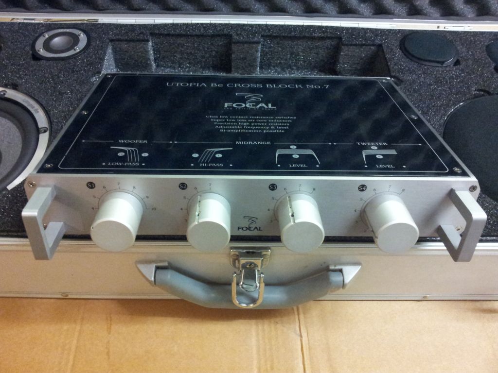

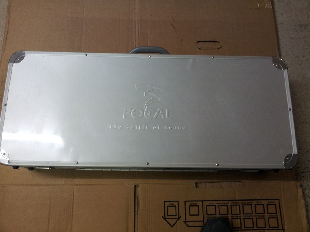

Come to think of it, have you ever seen a speaker set that comes in a metal flight case?

I think tomorrows job is to start deadening both sides of the sub mount and then later in week cover it and also look at bolting it in place as it only went in temporary.

Managed to stick the car in the garage and grab an hour to deaden the mdf panel that the sub is mounted on. Hopefully get the rear side done tomorrow. Not sure how much effect it'll have but worth a go. Now I need to get some grey auto carpet to cover it. The front side is not so important as you won't be able to see it unless you drop the seats but I have to cover it anyway. I couldn't have a listen to it as I'd need to start the car and that would wake the whole house up!
