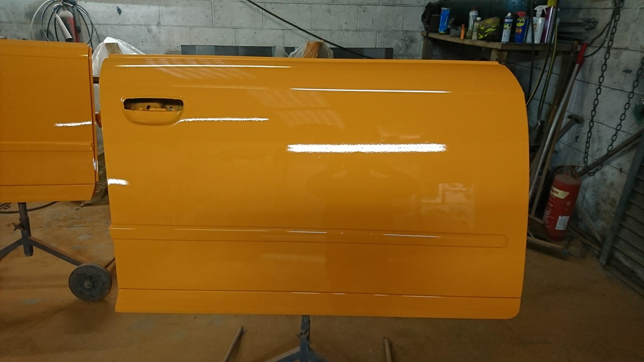

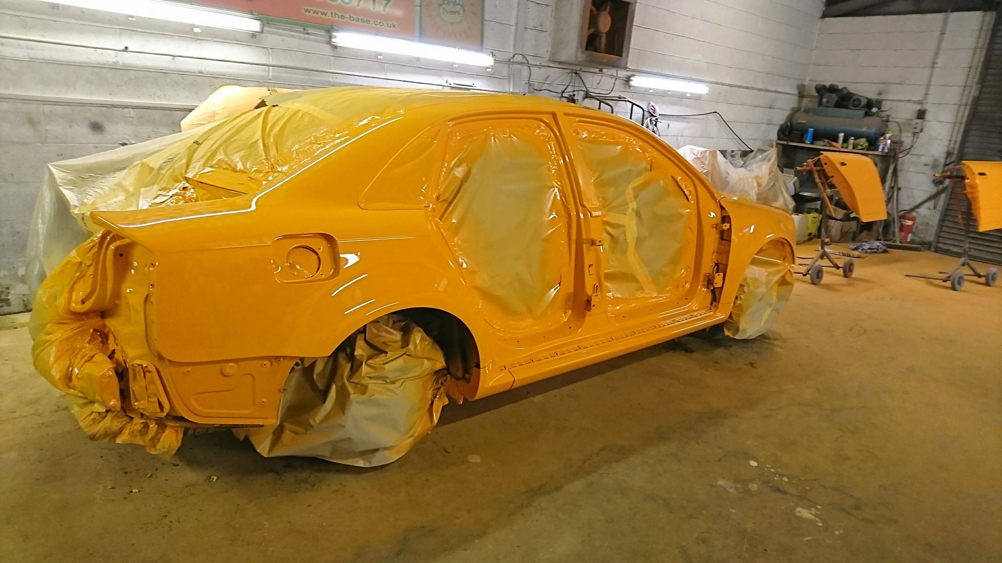

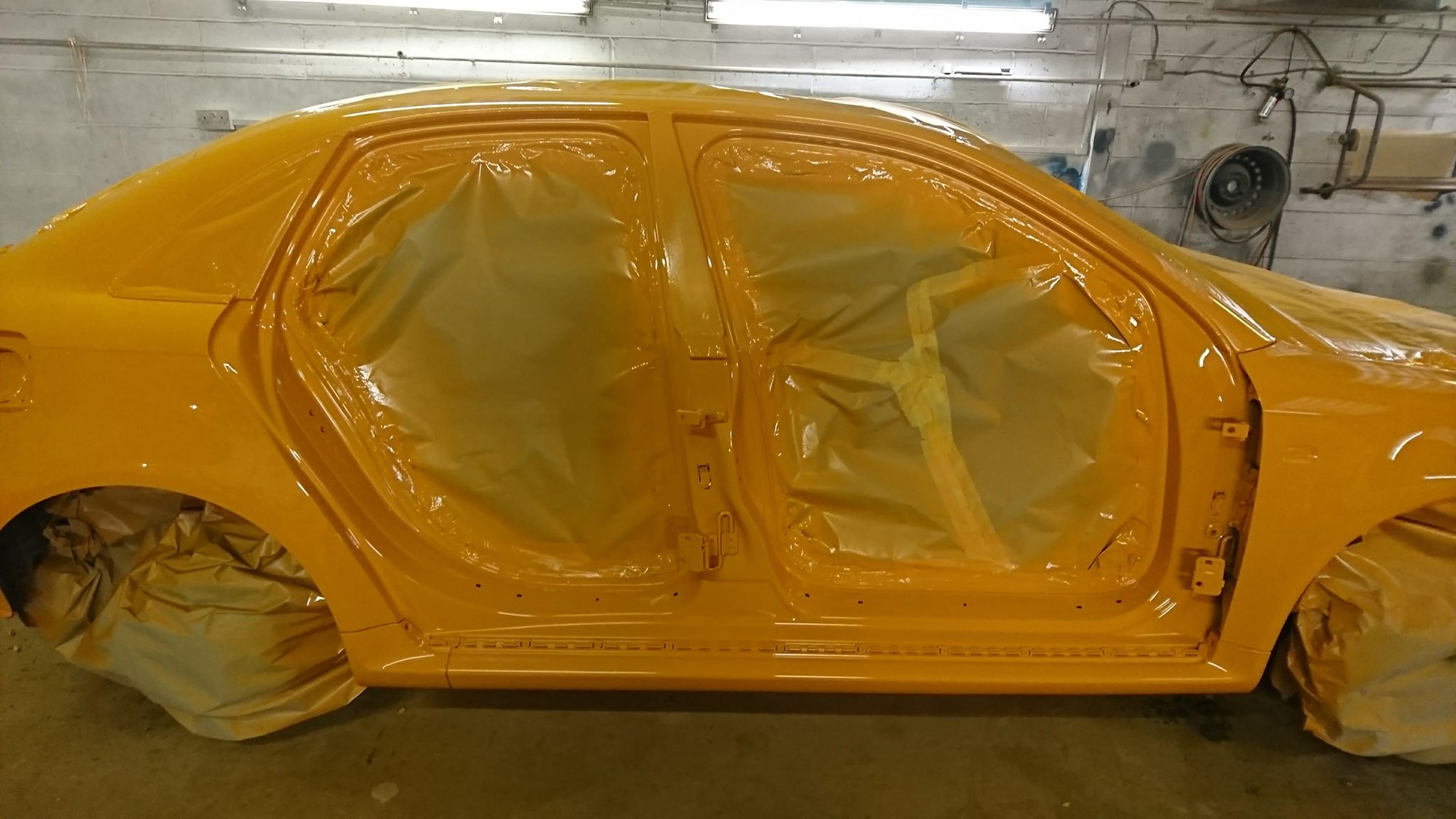

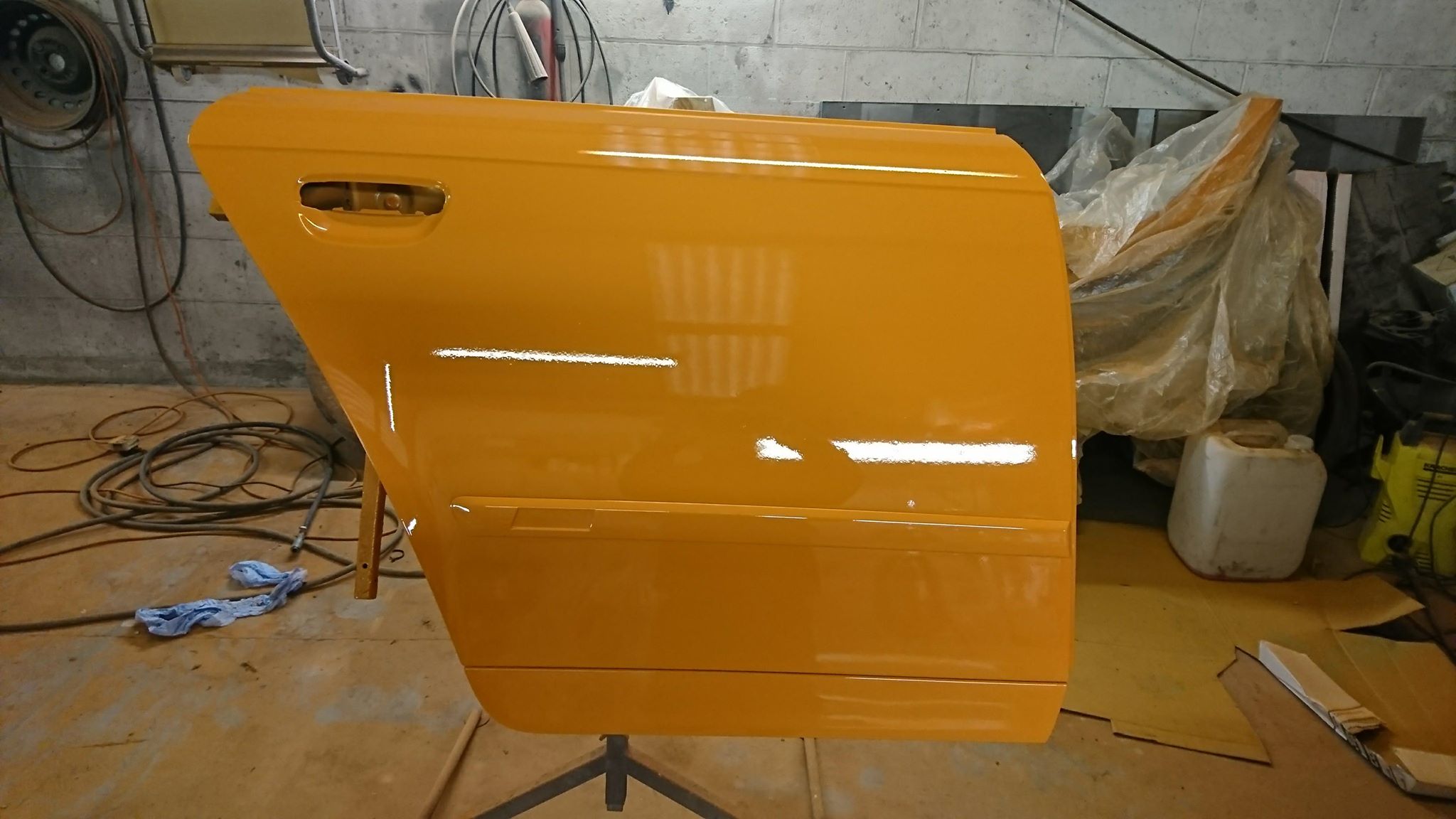

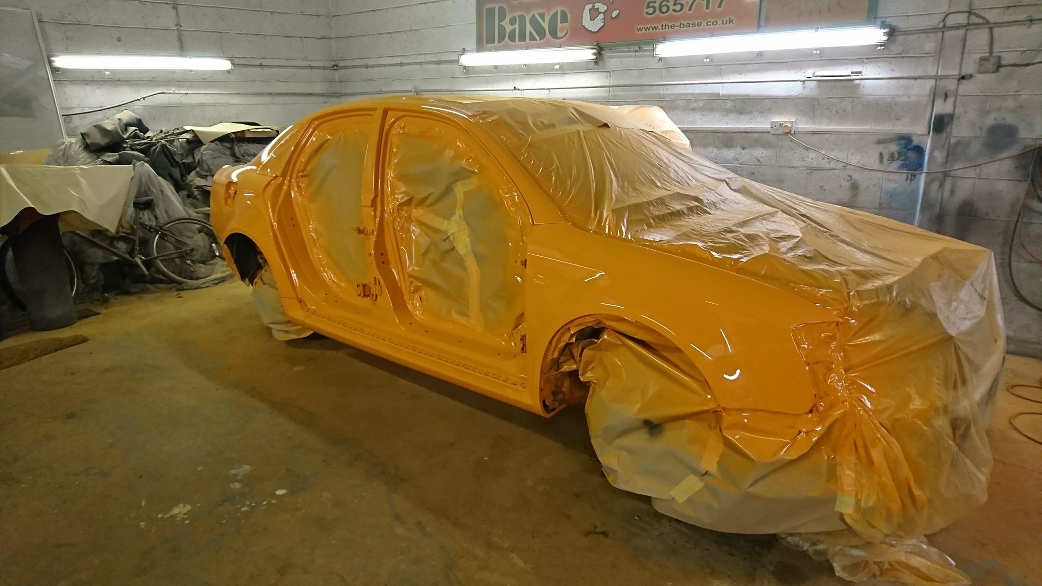

Today's update: doors painted and it looks like lacquer has been applied to these and the side panels. Really starting to come together now!

i dont want to be negative here but i have to agree with some of the other posters about your painters technique/working practices, they are not what you would expect from a "professional" paint Shop. if you have paid decent money for this job i would be very concerned.
i hope it works out for you and your happy but i can see trouble ahead...

I can defo see a lot of “Orange” in it but it’s the “peel” of it i can see more.

It needs to be machined yet don't forget. I do see the peel though and I hope it flattens out with the polish.
...If not I'll take it down to Jim White and he can work some wizardry on it.

I was speaking to Clive at Motocraft yesterday and I mentioned him not wanting to paint your car. He said he would have done it for £5-6k but didn’t think it need it and was offering professional advice not to do it. With regard to how your painters working. Said paint should stick but it’s not the best way to do it on a mint car. The lack of primer to bond to means you may have issues with stone chips and jet washing near stone chips

absolutely not true, primer doesn't need to be used for adhesion perposes. as long as the original paint is sound, keyed/flatted correctly and cleaned correctly the new paint will stick just fine.
