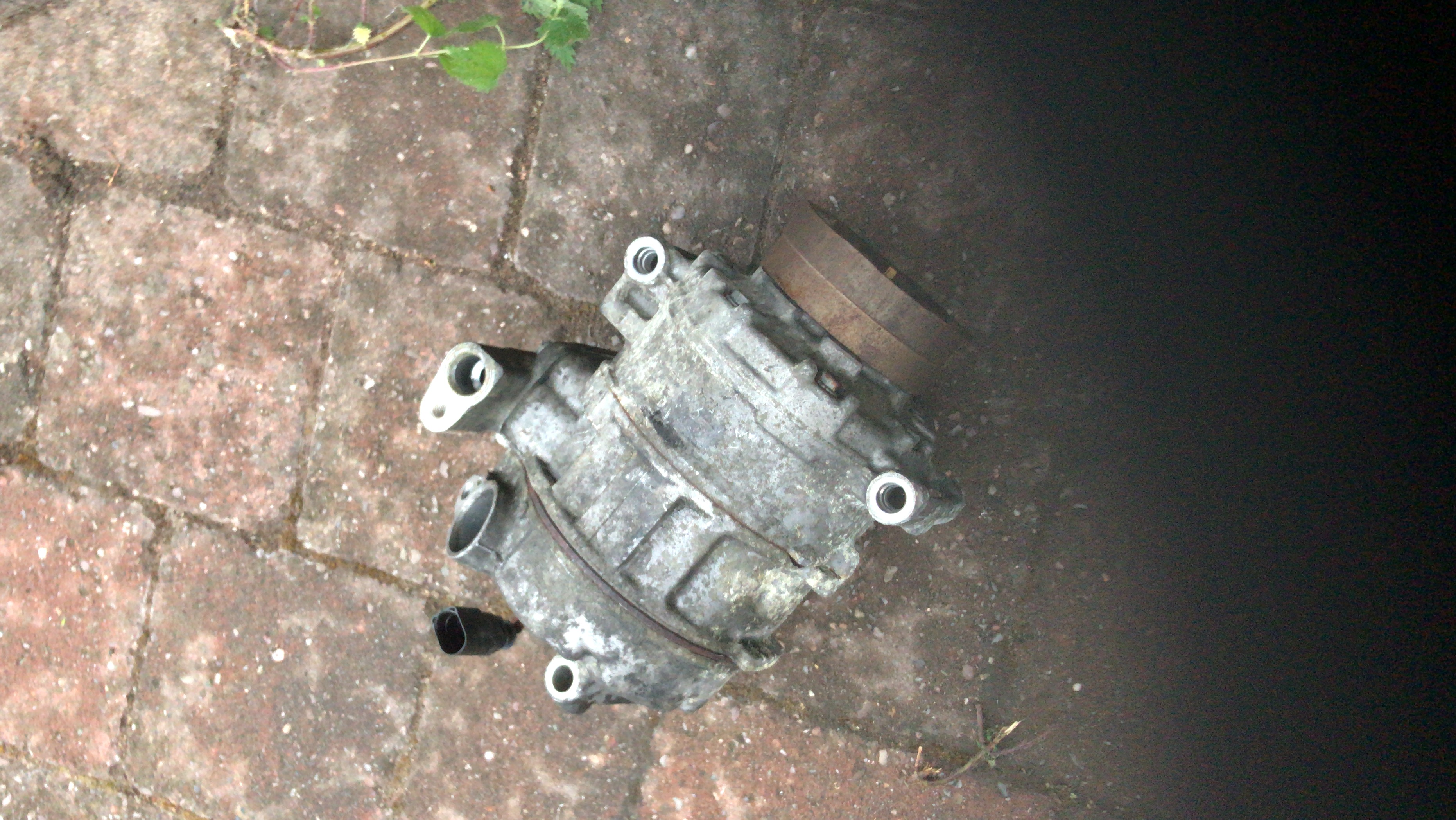

Cheers mate, not updated it in awhile.

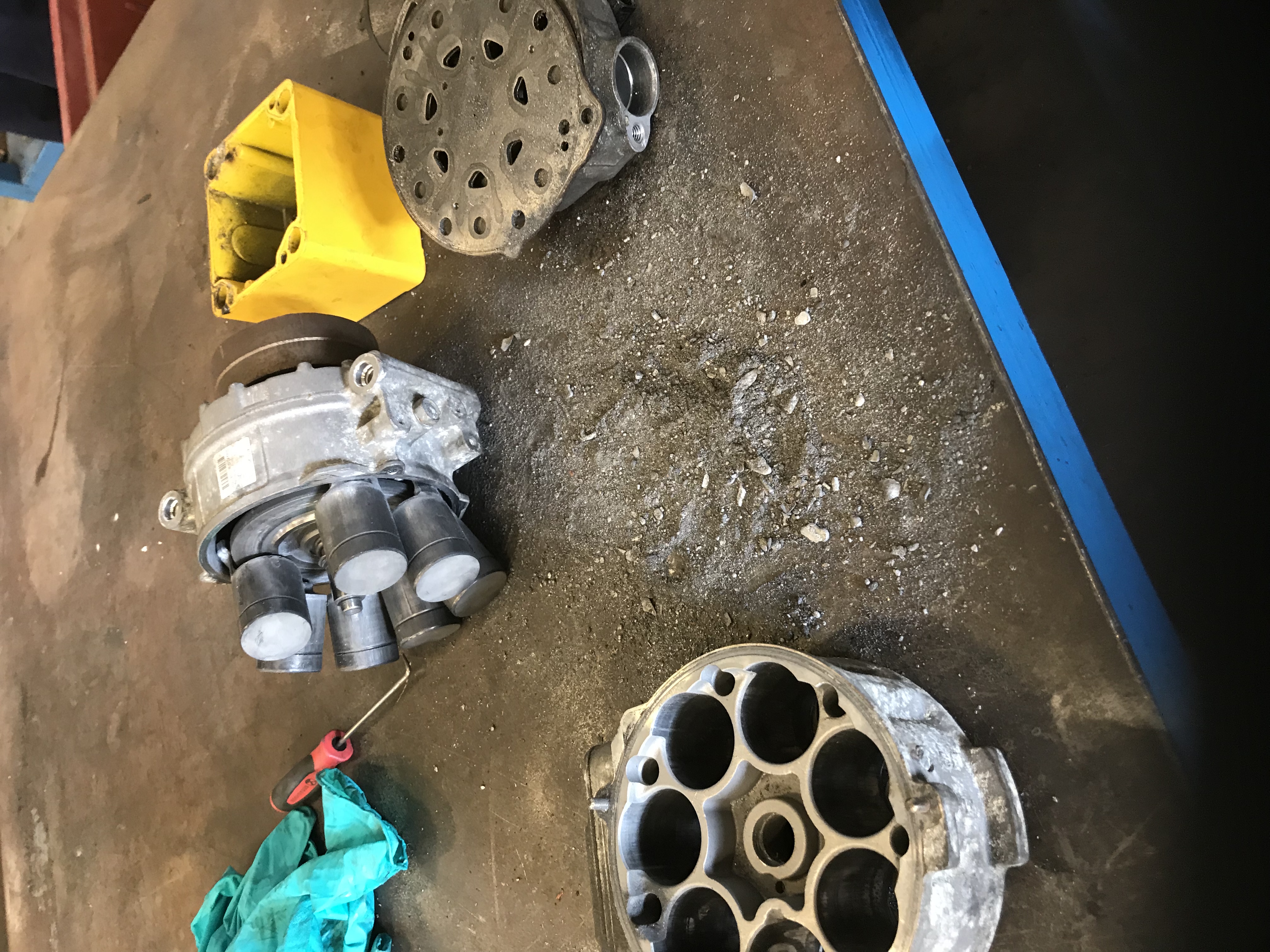

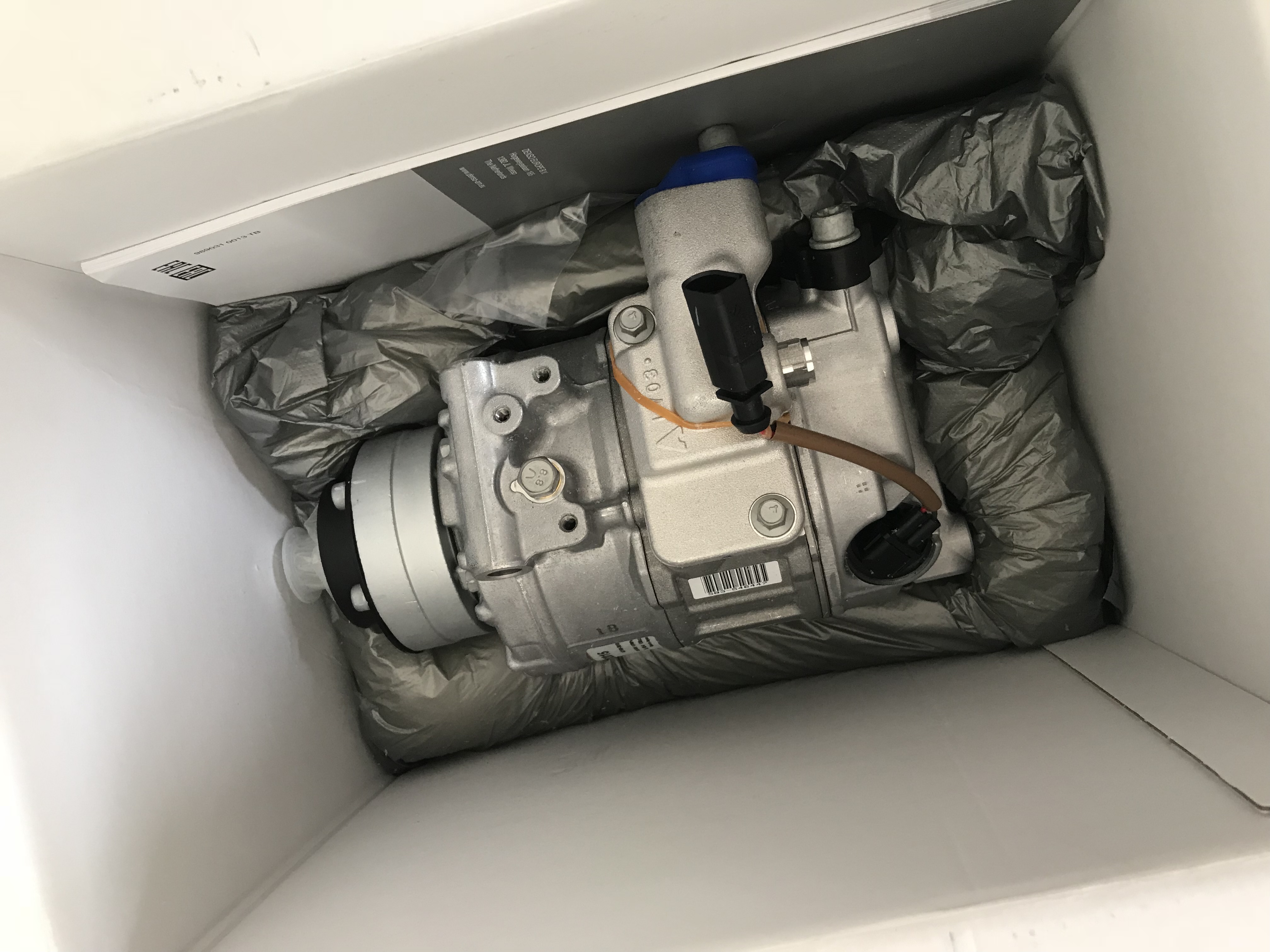

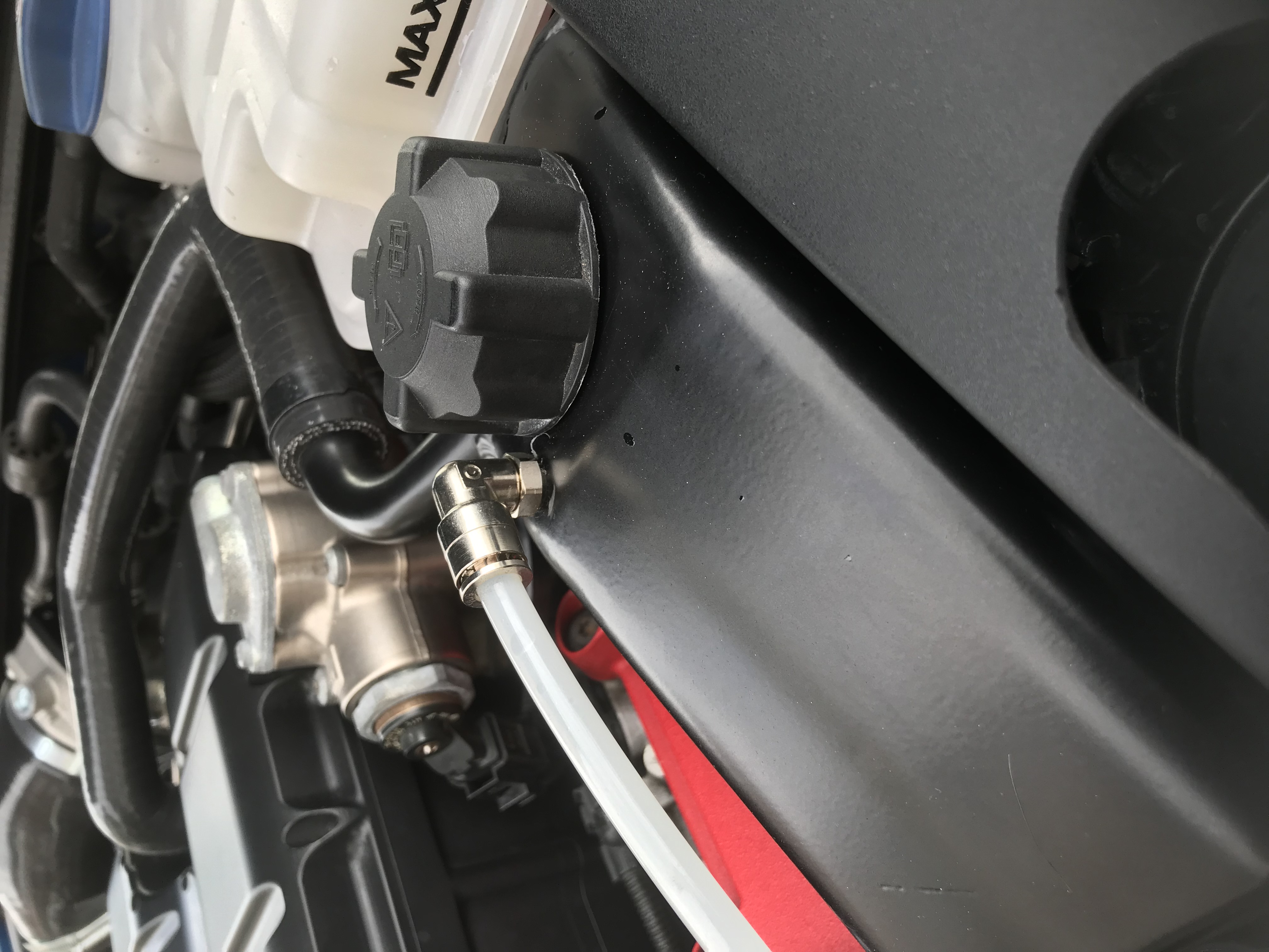

Only thing done really is changed the aircon pump and new set of spark plugs.
Oh an put a pipe on the water tank to stop water goimg on everything in the engine bay. Was looking a mess

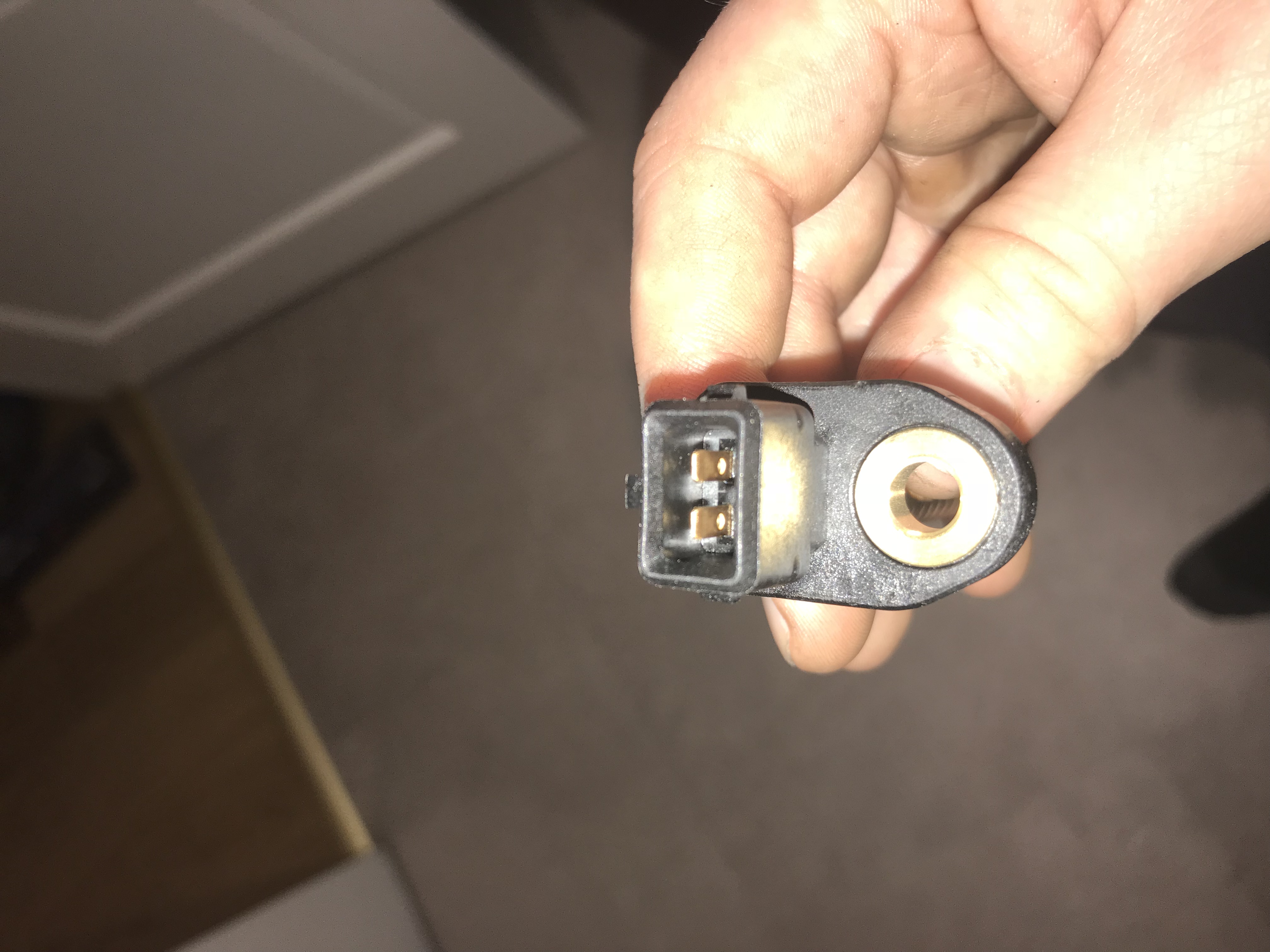

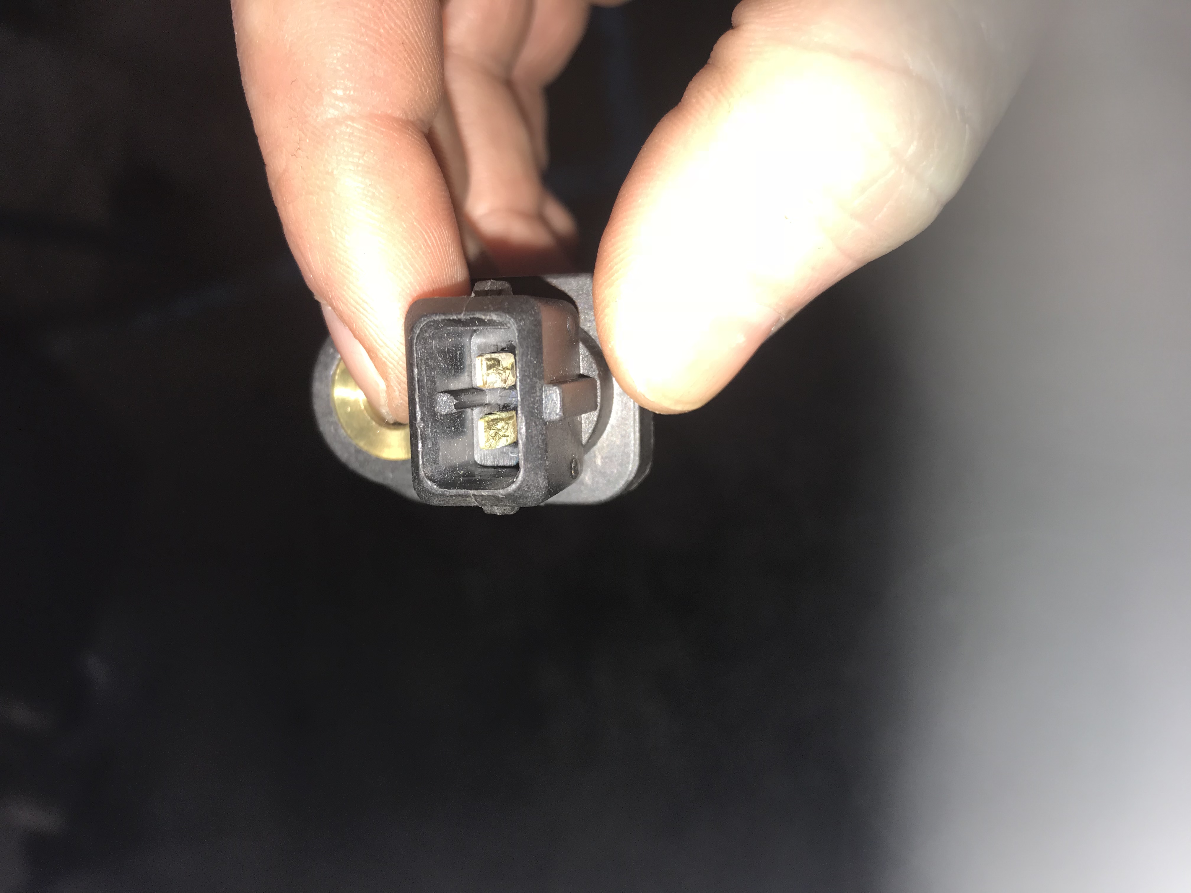

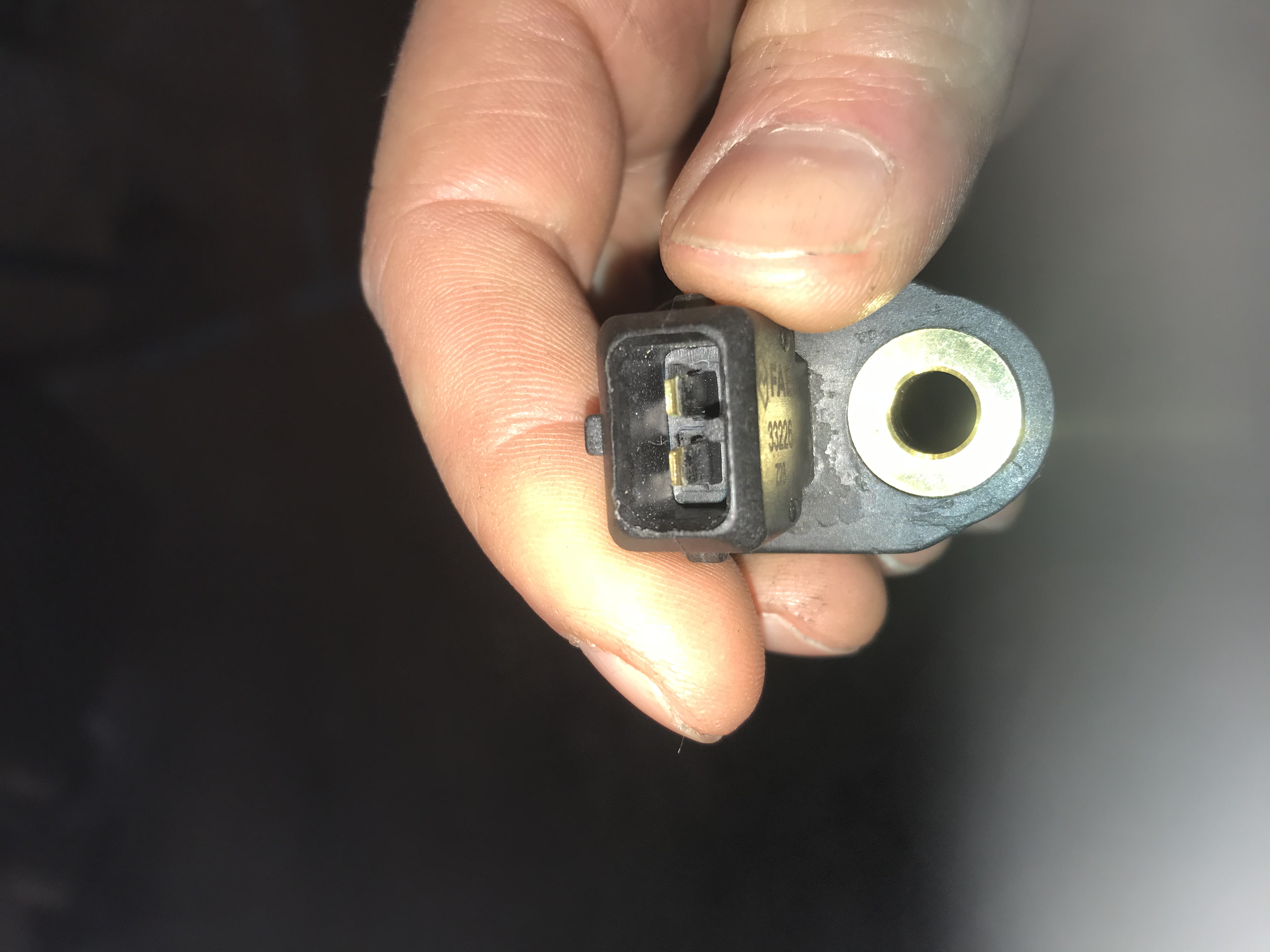

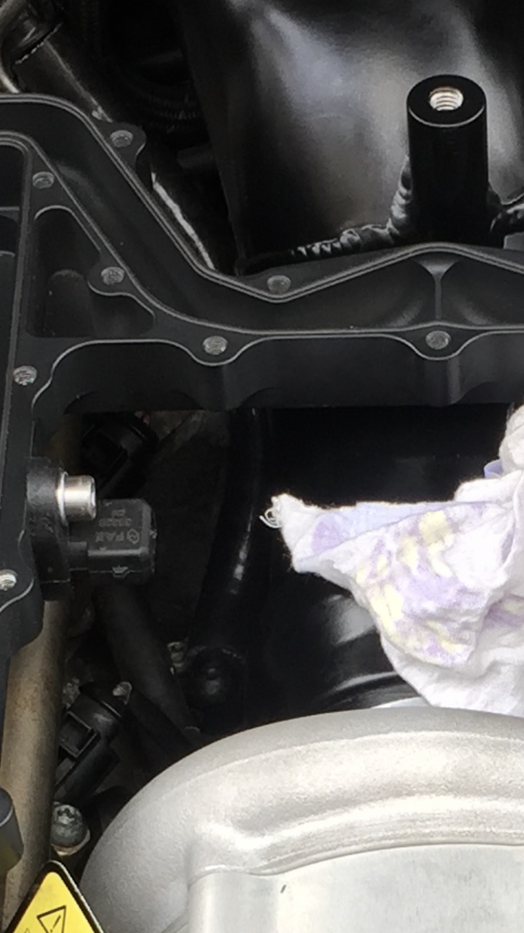

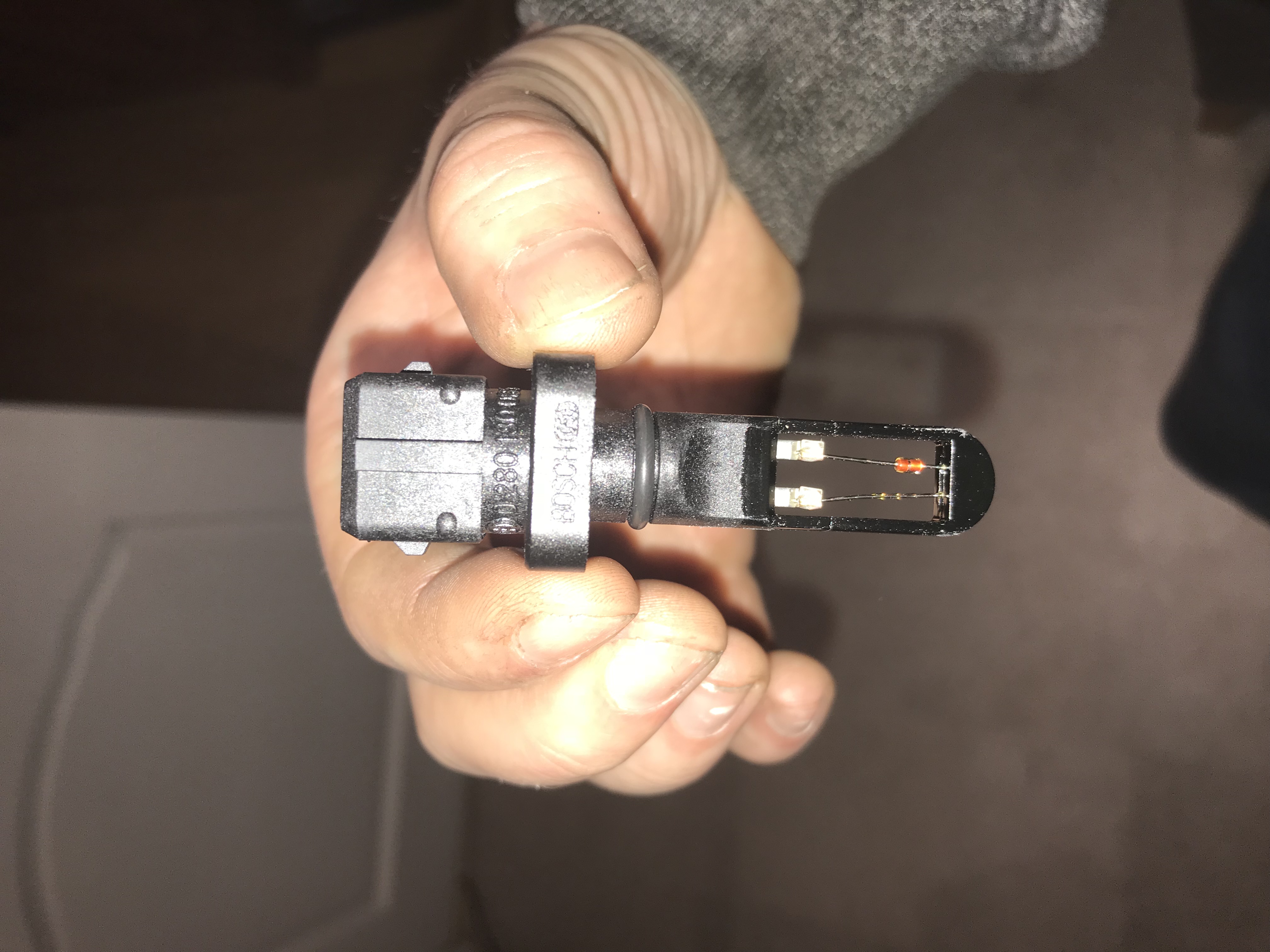

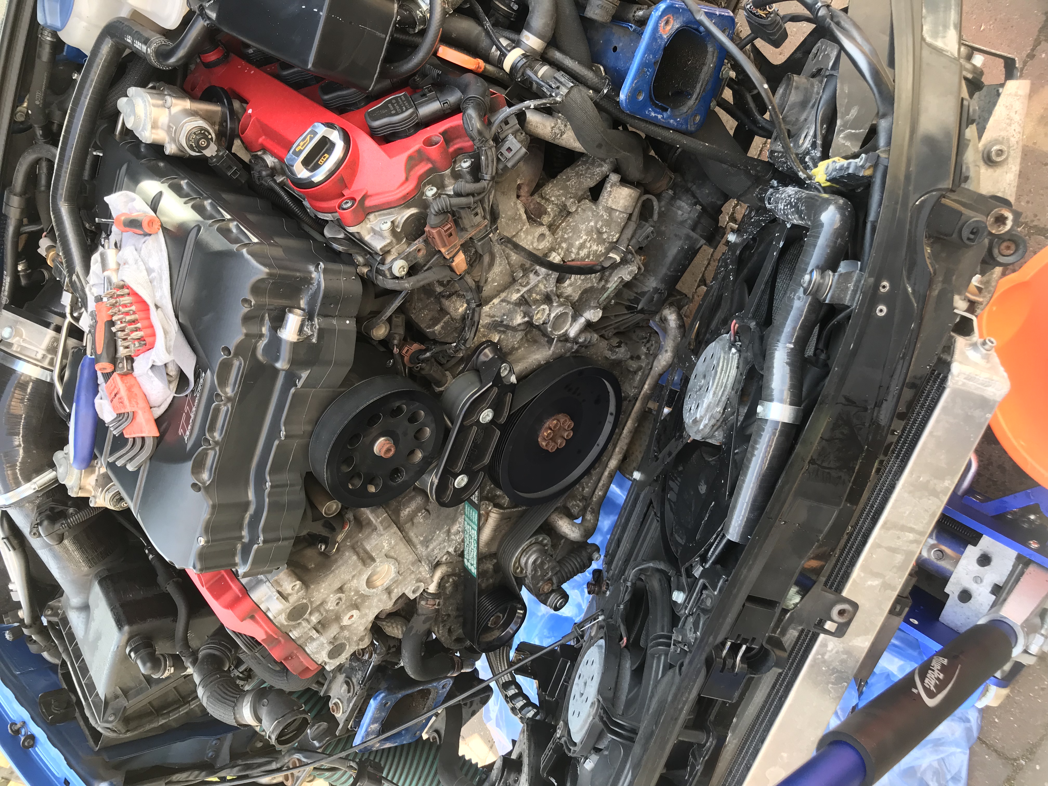

Update on this.

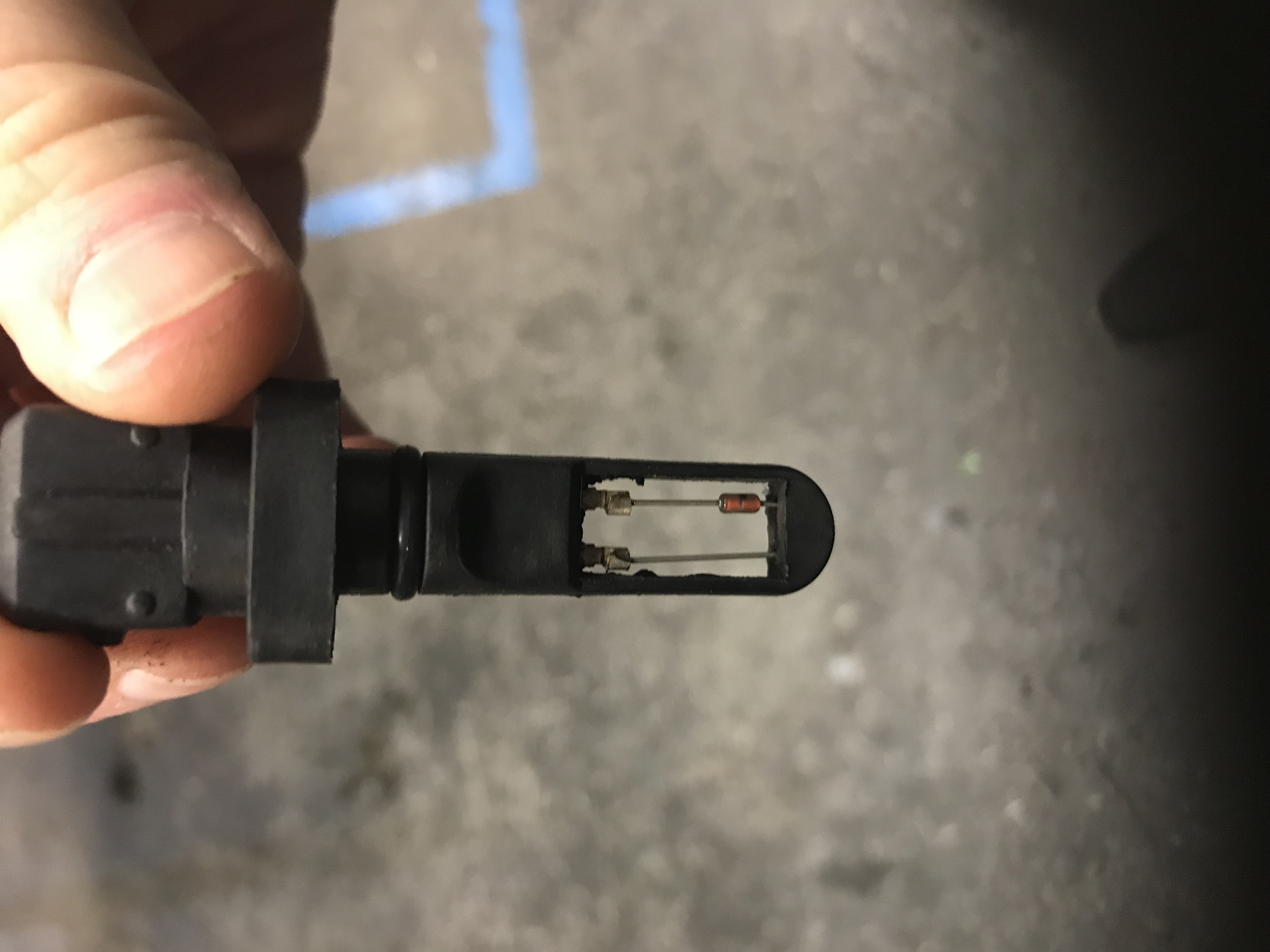

Had a on going issue with the air in take temp sensor since fitting this kit in march 2017, some times working some times not.
Freeze frame reading -40!?.
Had a word with mrc (doug) about this an they said at the time it wont be a problem with sensor because its a genuine part.
Checked wiring an all is good an done other checks aswell.
Anyway had enough last weekend an striped it down an pulled the “genuine sensor” out, turns out its not genuine!
In all fairness to MRC they didnt know this crap sensor as you will see in pictures was been supplied by TTS. It even had plastic on the terminals of the sensor!
Refitted with a bosch unit an all is well, no fault codes and silly -40 readings.
So just a thing to look out for with anyone else with a tts kit.

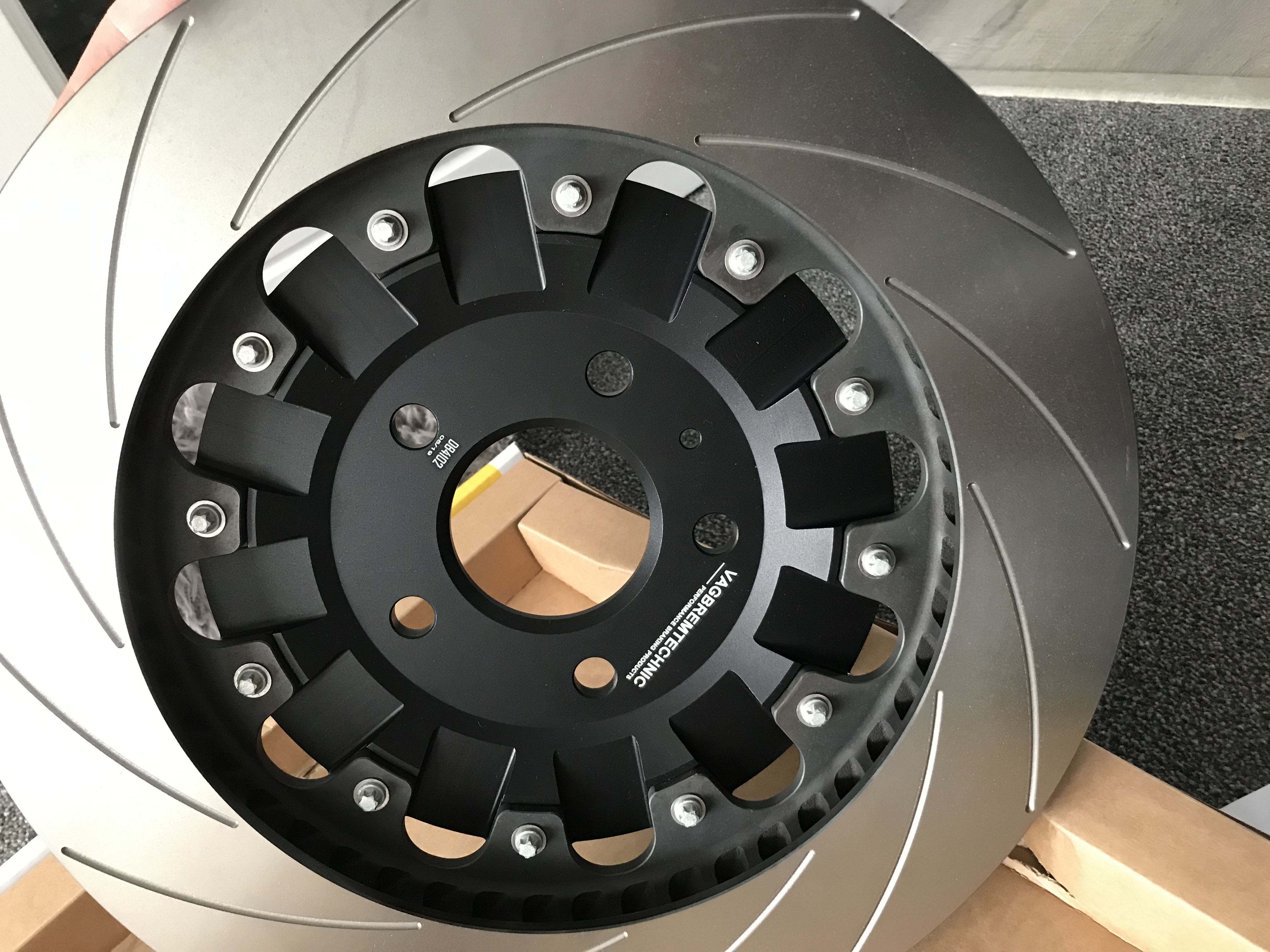

Post by Lukes3 » Sun May 26, 2019 7:23 am

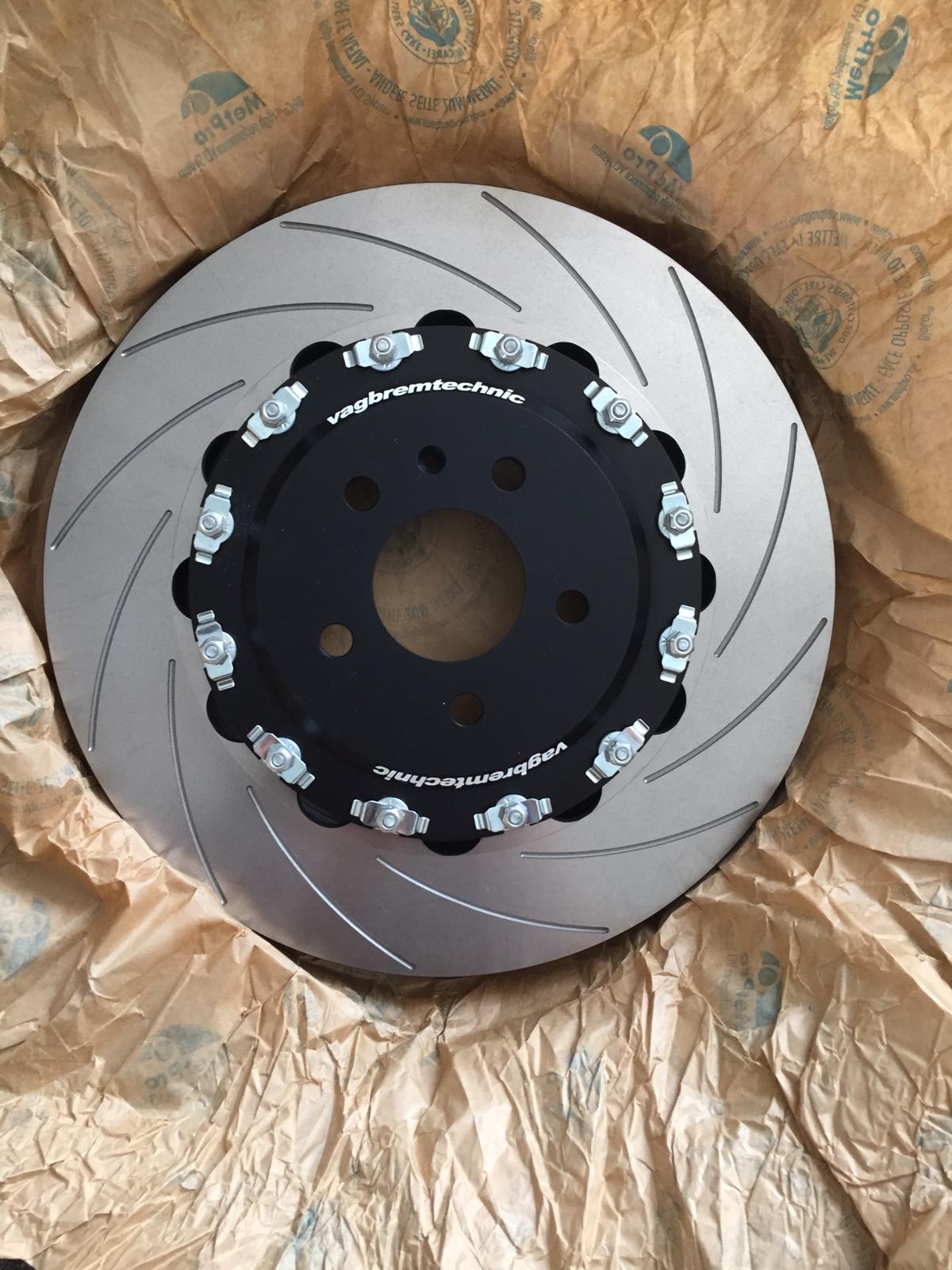

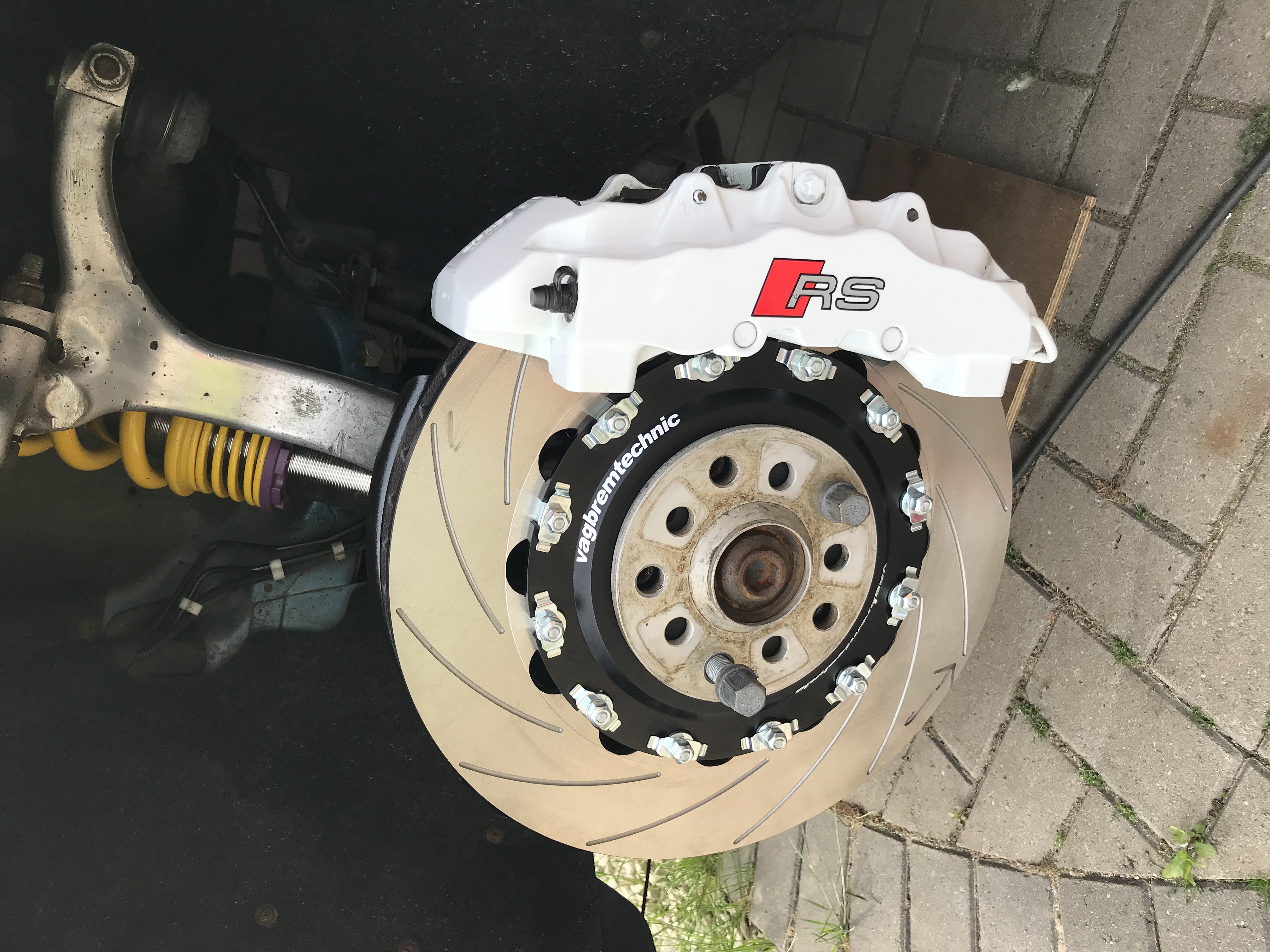

New brakes fitted thanks to vagbremtechnic nice bit of kit these are, with ap racing rotors.
Also replaced prop-shaft centre bearing.
