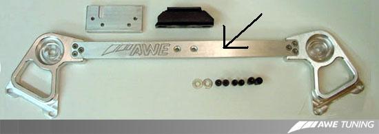

clive , which part has broken ? is it the main bar ? if so i would do as nickb834 suggests and get it welded up.

My thinking was that the (OEM) bar that was removed when fitting the DTS was giving some support to the transmission (and the fitting instructions tell you to support it before removing any bolts), but now I come to look at the instructions, the bar doesn't seem to be supporting anything at all, unless the gear box just sits on the OEM bar?
Welding seems to be a good solution though - not being an expert in such matters, how well does aluminium weld up?

Where did it break?
Post by CliveH » Mon May 07, 2007 8:01 pm
@grizz, this is where it's snapped...
Clive
