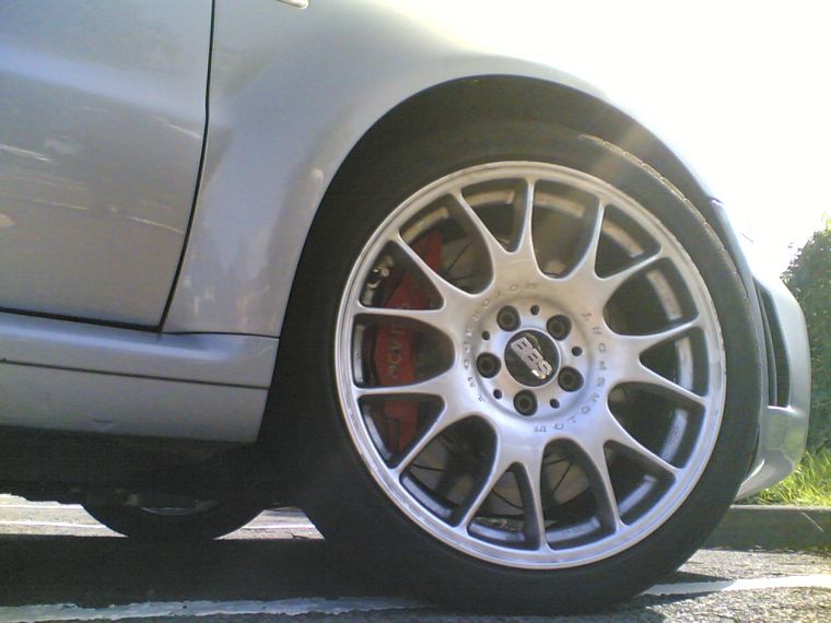

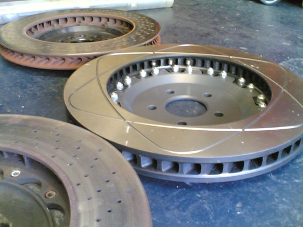

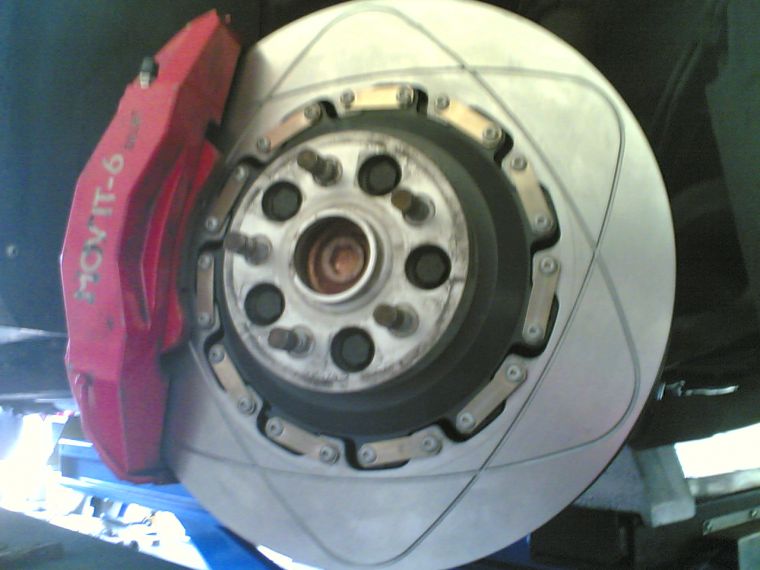

I have decided to bring up this discussion as a result of my experiences with the Brembo/ movit brake discs.
I paid £5000 plus travel cost to buy these brakes from Germany Movit.
The company are and were a lovely group of people.
Only had one real issue with these brakes and that is the disc life.
DaveP and I bought them
Bushy had bought the same or similar a few months previously.
This was around 2003-4

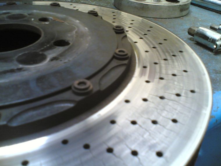

From day 1 Dave and I were concerned by wobble and cracking.
We got around 5k per set of discs but were really fed up as these discs were supposed to have better life than oem, we lost confidence on track as the discs cracked dangerously after half a day or a day on track. Basically they could not take the heat.
We discussed the issues and wrote 10,s of emails; movit sent new discs same issues continued and another set and so on. The power was fantastic but disc life not at all acceptable, movit said they would send better discs and they would re engineer but to date 3 years later nothing has been done or forth coming.
They say new discs are coming but always the same issues returned, as the design is not good. (Drilled/ cast and not floating)
Personally I went thought 4 sets of discs they all cracked to the edges in no miles, there was plenty meat left on them but the drilling of the discs meant they are weakened and they just did not last after tracking.
Whilst all this was happening both Dave and I contacted other owners who bought the kit.
Stevesme, Tom - VST, Lucas-Hutch, Waitey 1, Dave P, Jani.
Basically the issues are clear to see on other cars like 6 pot Porches.
The heat is not so intense when a 4-pot calliper is used on the same disc, as the heat is not as great.
So those who spent serious money on a six pot front system had huge breaking power but not so powerful disc life. Many Porsche people have up graded from drill/cast Brembo discs also for the same reason.
I was either going to sell my car or solve the problem.
(Dave sold his car and said the breaks were a definite factor in this decision)
So I went to AP.
I had a fantastic Responce from AP and in no time they designed a fully floating 36 mm thick strap drive disc to replace the movit disc, it’s a simple swap.
Same disc is used on an e60 M5 upgrade and the AM Vanquish.
AP madder the brakes for the Veron, so they know their stuff, Movit sell rebadged copied Porch kit.
The day I had my new discs fitted was the day my car felt as it did before the movit discs were fitted. (Sorry movit but its the truth)
No wobble at 50-60 on light breaking.
A beautiful silky feel to the breaks - like a normal car!
But I had 36 mm 378mm monster discs of a fully floating strap drive bell by AP (not the 32 -365 OEM skinny cheap discs on floating pins.
So they are proper big and up for it.
This is without doubt my trouble with my breaks over. It was embarrassing and annoying to have been told by many people to give up on the movit breaks as these people did not realise- I forked out 5 k to try and get good safe brakes so I did not kill my self on track getting rid would either give a friend the same problem. Not my style.
I also had to face a company who already do a fantastic kit for the rs4, a British company whom I should have gone to, but I was faithfully assured movit were the best and to trust this advice.
So any way I’m going on and on.
The problem is solved.
Ill posts some pics if I can.
Please guys if you want to sort your selves out some serious discs at a seriously discounted price, let me know, as I would like to return some discounted directly priced orders to AP in return for developing this product.
Ap have not worked a fully costed price yet but if you want some strap drive discs for a current Ap set up or the movit 6 pot set up the retail cost for the Ap 365mm ones is £1000, Pete at AP said the price for a group may be in the region of £600.
He will do his best for us. These new discs could retail at over £1000 so a hefty discount.
What can you say, Fantastic!
My discs have no issues and have had serious hammer, I don’t worry about this issue any more
THANKYOU AP RACING.

My experience with AP hasn't been the most positive. I have the non-strap original version and have had the following issues:Chubby wrote:AP Racing have spent consideralble time and effort on getting there brakes right. Ther first disc, which was not the same as yours had the same effect as your movit brakes...
I have been through three sets in 12 months, with little or no help from AP Racing, infact they started by saying that the brakes 'are not designed for track days', and did not give any reasons to the cracking in the discs.
The cost of buying the new sprung discs are the same as buying a complete new system of the RS4 b7, which in my opinion are better than AP and Movit.
Let alone the waiting times you have to get the disc's (7 weeks) and the price of the pads, which I have gone through in one track day, and I feel you have gone from the frying pan into the fire.
Sorry but the truth sometimes hurts...

Yes I have tried the new sprung disc from AP Racing.
I have tried Mintex, Ferodo and EBC pads - not much differance.
I have also driven RS4's with the Movits and the RS6 conversion.
I have also used the AP Racing caliper and B7 disc's.
The conclusion is that the AP Racing are good for one track day or one race (which is what they would be use in a racing car). The RS4 is a very heavy car and takes a good deal of stopping at speeds of 100 plus.
Track days put so much stress on brakes, most can't handle it.
They are very good for normal fast road use and will last.
The set I sold were in good condition and would be fine to use for both road and track, but I wanted something that would last.
Talking to AP Racing all I was told was that the disc "got hot" over 750 C and at that temp the disc will crack.
The RS4 B7 brakes do not crack under track use, they do not stop quite as well as the Movit or the AP Racing but last longer and still do the job.
After a track session I have it de-glased using a Pro-Cut machine and they are perfect again.
No I do not have the AP Racing rear brakes - as they were not designed when I got the fronts.
I have GMBH drilled rears, which work fine but still the pads only do two track days before being replaced.
So it would seem from the above that I DO have more than the fair share of knowledge in brakes for the RS4, but it really depends on the end user, and how they drive.
The point I was trying to get over was don't think that one set of disc's will be better than another in every way, what you gain on the round-a-bouts you lose on the swings...
