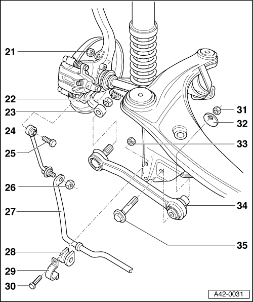

Rear...
25. Hexagon bolt, 50 Nm
26. Self-locking nut, 40 Nm
o ◆ Always replace
30. Hexagon bolt, 25 Nm
PS: This is for MY2000 not sure if this is the same for all years.
Rear anti roll bar.png (62.13 KiB) Viewed 2606 times
