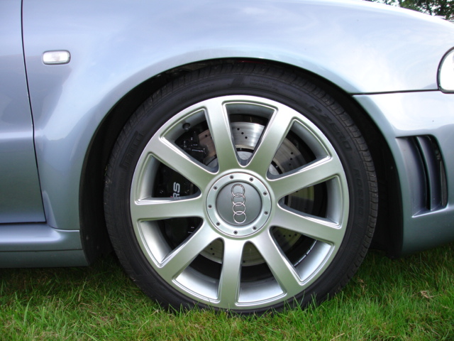

Post by quattrosteph » Mon Aug 28, 2006 9:15 pm
Really good and they look good to!! :thumbs:

RE: RS6 brakes
Post by SteveH » Mon Aug 28, 2006 10:17 pm
Looking good Steph. Dont expect those alloys to stay so clean with the RS6 callipers... lots and lots of brake dust created by those big boys :wink:
