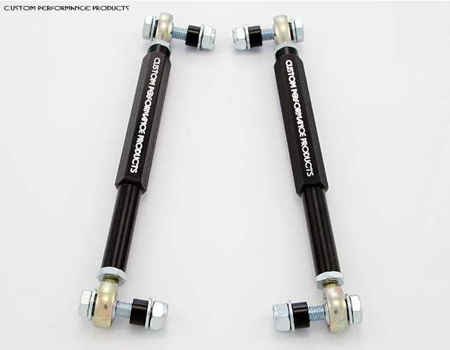

That’s what I meant similar to the ones CPP make and I don’t think you will find that even SS joints will last without boots on them, learnt that on another car I used to have.
Anyway if S4Woody has some that will save a job...

Post by MarkB » Mon Mar 19, 2007 2:43 pm
Seeing that picture I'm now having second thoughts on how I'd make mine. I was thinking female rose joints with thinner bar connecting them but I've just had visions of them bending under load.
A handy picture. Thanks. Oh and mine will work out cheaper than woodys (for me as I'd be making them)
At the risk of suggesting plagiarism (Joke) I would copy the CPP design and at the risk of telling you the obvious I would get yourself some HE30TF hex ally bar for the link and drill - tap both ends – could do with a lathe or pillar drill for this as the nuts will need to be square to the end of the link or else they will not lock properly. Then it is just a question of getting your joints, rubber boots, bolts and spacers (Short piece of stainless tube).
Finishing touch would be to have the links anodised although smooth Hamerite would work just as well!
That was so easy to type but as we all know it probably would not be quite as simple as that, good project though.
