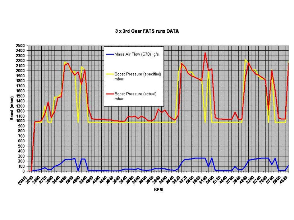

Post by S4TAN » Sun Dec 10, 2006 2:35 pm
Here's a pic of a set of logs graphed for FATS runs (all 3rd gear pulls) in my car...i don't see all my peak actual boost levels until around ~4.5Krpm upwards (between 18 and 20psi).....but you guys make +5psi at 1.5Krpm and up to +20psi at 2.5Krpm on the DNA map....(!)
..must be that the custom MRC map doesn't make peak boost until much later in the rev range i guess... Anyone else have any logs/graphs of their maps (MRC, DNA, MTM etc)? Would be interesting to compare when the different maps make their peak boost pressures...

Yeah - c'mon all you dudes out there with re-maps and vagcom - post your logs/graphs so we can see when and how the different maps make boost .....(i can make the graphs for any logs if anyone is unsure of how to do this - just pm me the spreadsheet)...

That's some good work Mark - exactly what i was after. Do you fancy resurrecting this thread temporarily and factor in my logs to your master graph if i send you the spreadsheet?
