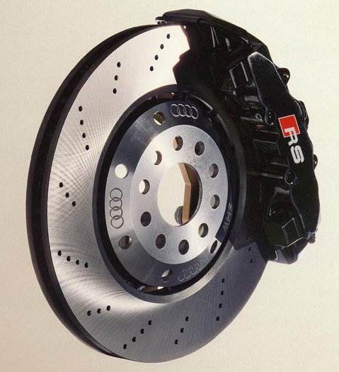

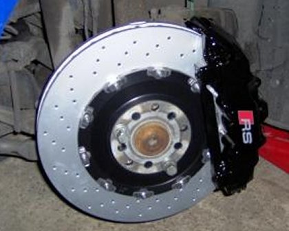

Here's a couple of comparison pictures... Although I must credit the sources, the RS6 disc is from rs6.com and the RS4 disc is one of clives photos from a previous post:
Present:...
Past:
MarkB
Posts: 5695
Post by MarkB » Mon Nov 06, 2006 11:16 pm
If only the new RS4 disc was handed...

whisky180
Posts: 232
Joined: Fri Apr 21, 2006 5:23 pm
Location: london
Post by whisky180 » Mon Nov 06, 2006 11:24 pm
MarkB wrote:If only the new RS4 disc was handed...
not quite sure about the merits of handedness all i know is the rs4/6 combo stops my car without any fuss wobble and judder and i am running approx 470bhp

I've just had a thought.... the Phaeton ducts may not fit using the RS6 disc. The disc is more inset (reason for requiring the caliper bracket)
The ducts work with std B5 RS4 disc's but I don't know if there would be clearance for use with RS6 disc's. I would assume them to be OK with B7 RS4 discs as the offset is the same as the B5.

MarkB
Posts: 5695
Post by MarkB » Tue Nov 07, 2006 2:07 pm
boxerdogted wrote:The only problem that i have been told about with regards to using RS6 discs is that you have to remove the splashgaurd to fit them, this can lead to cooked cv boots if you dont allow the discs to cool after spirited driving and track days.
Ah, so as I thought, Phaeton ducts won't work with RS6 disc's, you need a caliper bracket because of the offset change, they are heavier because of the method of 'floating' the disc, but they are handed.
I'm now thinking B7 disc's may be the easier/better option unless you really need the extra durability of the RS6 disc
Mark
