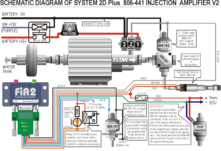

Here my car has just fitted yet the the comment.
Pics stored in BW-RS4 gallery.

I have also just fitted the 2d system in mine.
It has not given me any more peak power but I think that is more down to me running at the
limits of the K04's.
It has reduced IAT further, I can now regularly see 18C intake temps at WOT in 3/4th gear, logging
the CF in blocks 021/020 shows a reduction in the timing correction from 4.5~5.5 max pre WI to around 2.5
max very very occasionally, usually 0.0
The car also feels better on the road, seems to build tourque quicker and smoother probably
due to the ignition not being pulled back by the ECU.
Currently running on just water but I will be looking at adding some Methanol soon and will
then do some further logging and hopefully be able to advance the timing a bit further.
