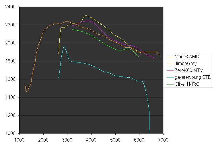

saf wrote:Leon Im sure the MTM chip runs at 1.2 bar on the S4. Not 1.4 bar. Im pretty sure of it, as thats what boost MR collins of QST informed me that it was running. This was a about a year ago.
Deffo got boost plots put against MRC map, AMD map and the MTM map and mine ran quite a bit more - especially at red line which was really high. Bye bye K03... which did happen to me :(

ZeroK66 wrote:Deffo got boost plots put against MRC map, AMD map and the MTM map and mine ran quite a bit more - especially at red line which was really high. Bye bye K03... which did happen to me :(
My MTM map runs 1.2 bar

Post by MarkB » Tue Mar 13, 2007 2:50 pm
The boost plot I've got for Leon (and others) shows his peaking at 1.25bar

MarkB wrote:The boost plot I've got for Leon (and others) shows his peaking at 1.25bar
D'oh... well I will shut up then, well my point that it ran quite a bit more boost than the MRC map still stands true. Wish I had logs from lower RPM to compare to MRC to see if that was the cause of the "lagginess".
