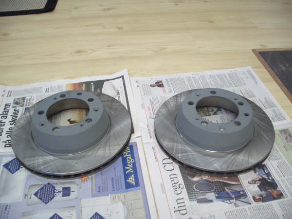

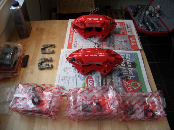

Post by Hansen » Fri Mar 31, 2006 8:58 pm
I had the same problems with my brakes. New discs and "homefixed" calipers.With Porsche logo... The result was not so bad:)
Hansen
Posts: 14
Joined: Thu Mar 30, 2006 9:33 pm
Post by Hansen » Fri Mar 31, 2006 8:59 pm
calipers in the kitchen..
